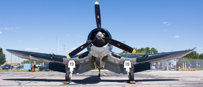

The WW2 F4U Corsair went from a 3 blade propeller to a 4 blade with the introduction of the F4U-4. Better performance and reducing the overall diameter helped landings and takeoffs. I have read that it allowed the landing gear to be reduced in length, but find no documentation to support this.
The F4U was the only piston powered fighter to down a MIG 15 Jet in Korea.

Happens to be one of my favorites.
Three or Two Blade Propeller F4u_0011

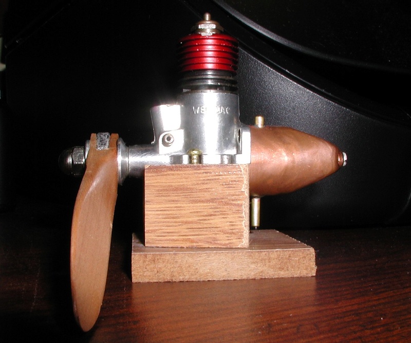

Remember this one Mark?
Three or Two Blade Propeller Wen_ma10
Three or Two Blade Propeller Wen_ma11
Three or Two Blade Propeller Wen_ma12

You got a rare one there, Bob. Is prop original, or was it modified after purchase? Always found those 1 bladed's to be a bit of mystery, think it was because it was only found in speed circles. I guess it was the cutting edge of taking the best advantage of technology to gain an advantage over contest competition.

grrr....lol, yes, yes i do! I'm still looking for a least a tank!!

Prop came with the engine George. I dunno, Mark is the guy on these.

They must have vibrated with single blade? I had the occasional twin blade snap one side while running. It practically vibrated my plane in half??

No, it is balanced, there is a lead counterweight on the non-blade side.

The prop didn't come with engine, but its period correct. I can't tell you if the prop is factory or somebody modified it, i'd lean toward the later as I don't see a market for speed props, but who knows, maybe Bill Mohrbacher does.

If you look closely at outward blade/pitch sculpting root at hub area of prop it strongly seems that it came out of factory as a single blade prop.

Good point Victor, there is no corresponding relief there.

The idea of the single blade was to help cut thru clean air (due to the higher RPM) gaining some efficiency, i.e. speed.
