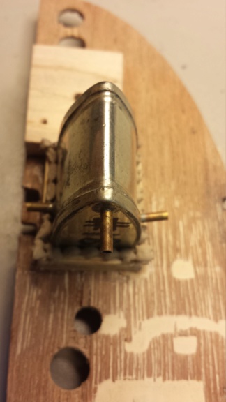

I boxed-off a section where the wedge-tank will locate.. using 1/8" balsa sq. stk. and glued-in a piece of inner-tube rubber for cushioning. I used a sm. sq. rasp to cut notches into the top and bottom of the body for a rubber-band style mounting. The area around the notches was then treated with thin CA for added strength.
The Cars are the Stars Contest. - Page 4 20190411
The Cars are the Stars Contest. - Page 4 20190412
The tank sits low.. but the "feed-tube" is just slightly higher than the engines NVA. If I oriented the tank any lower; the bottom-vent would be scraping the pavement. I think it will be fine though.
