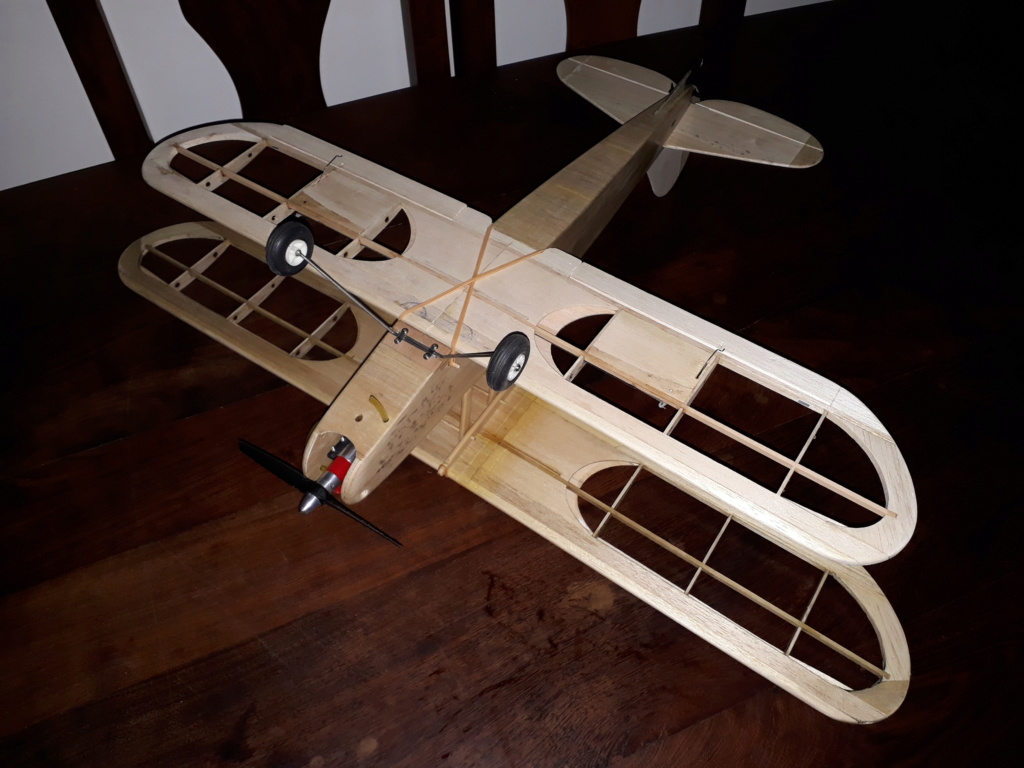

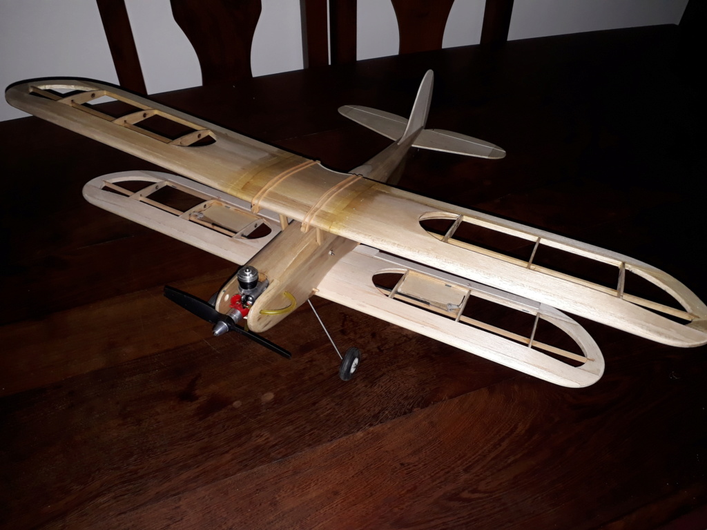

Post  MauricioB Thu Jan 10, 2019 12:50 pm
In the search for a model for my Medallion Cox .049 R / C so I had in my files this plane that I got from Outerzone (https://outerzone.co.uk/), it is the Bi-Hawk model, here I leave the link: https://outerzone.co.uk/plan_details.asp?ID=7607
The original model does not have ailerons, so I take the trouble to modify the lower side by placing a central servo and thus activate ailerons.
The model is now 4 channels, elevator, rudder, ailerons and engine control ... it is already 80% finished, it is not covered with thermoretractile material and logically the flight tests.
I hope you like it and wait for your comments here! ...

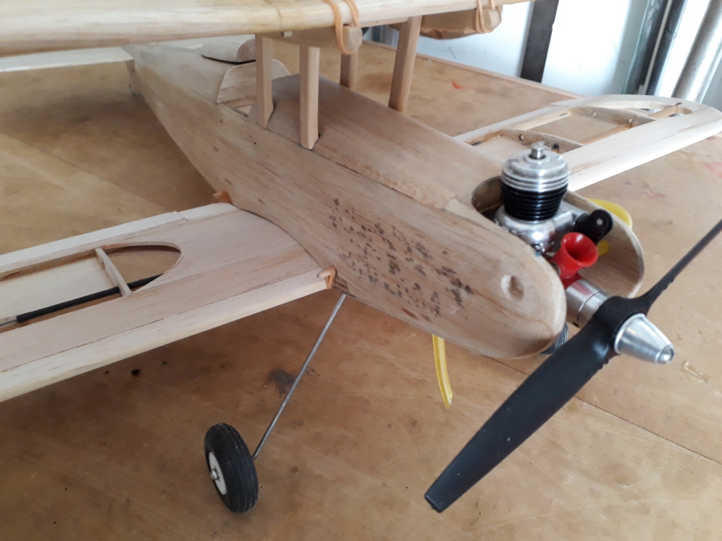

Post  getback Thu Jan 10, 2019 1:51 pm
I really like it NICE!! only thing is where is the exhaust going from the throttle system ? RC Plane

Post  batjac Thu Jan 10, 2019 2:20 pm
Awesome Sauce!  Can't wait to see it fly.  I've done 1/2A CL biplanes, but I never got around to a 1/2A RC biplane.  My compliments.
Eric, on those throttles, the exhaust is to the side, so it will exhaust to the left side of the engine.  Shouldn't affect the side balsa if it's coated with epoxy.

Post  MauricioB Thu Jan 10, 2019 2:58 pm
getback wrote:I really like it NICE!! only thing is where is the exhaust going from the throttle system ? RC Plane
Eric, my friend, I do not know if you are asking me exactly how the acceleration bar moves since there is F1, because there is a wood carved in the shape of a tube (cylindrical piece, hollow carved wood) where the bar slides of acceleration, driven by a command coming from the servo, behind the F1

Post  MauricioB Thu Jan 10, 2019 9:47 pm
Boys, thank you very much for your comments!
I am very happy and I have great expectations with this model, because I imagine the flight of the model and seeing the biplane pass through the flight field will be great.
The engine is very reliable, it has a beautiful gait, so everything indicates that it will work well, but at the time of the tests it will be the real moment and I will tell my experiences.
I still have to cover it, so I will continue to share the progress.
I leave here some more photos ....

Post  balogh Fri Jan 11, 2019 12:09 am
Mauricio the plane is so beautiful and your craftmanship is awesome!
I second others in saying the exhaust area of the coil should be covered in many layers of fuel resistant dope. In addition, because hot gases are blasted directly on the balsa I suggest you also add exhaust gas deflectors that prevent the cowl from getting roasted by the hot gases...my experience with my Cosmic Wind. I used aluminum deflectors cut from a (Miller Light Very Happy ) bear can:
