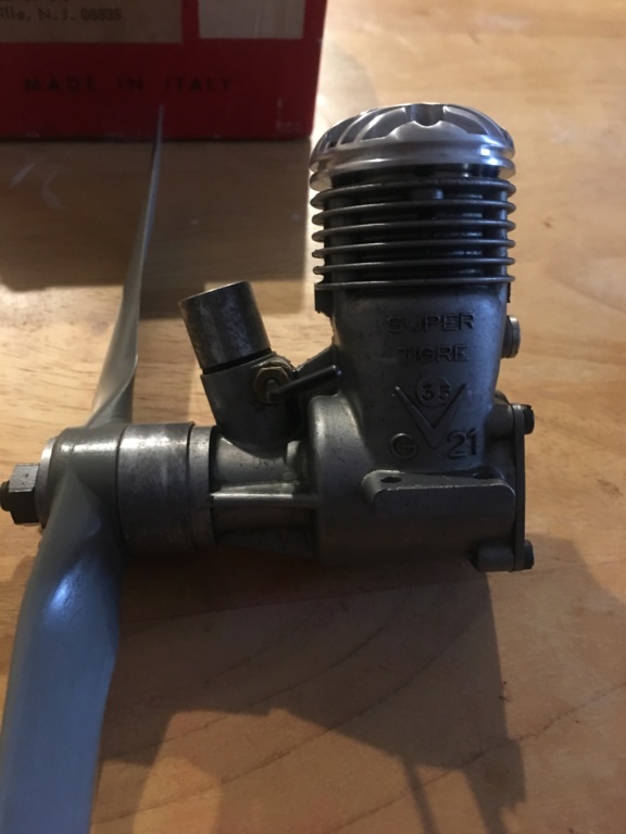

I purchased a couple ST ABC cylinder sets from Brian Gardner in Australia. I was very pleased with the quality of the work and the fit and finish. The ABC is nice, but I was more interested in converting the BB Combat version that was gifted to me from Fred into a stunt engine that will do a 4-2-4. Not cheap by any means, but worth it to me.
I am attaching a few pictures so you can see the difference in the port timing.

Bill,
Sorry to hear about your balance problems! R/C would be the way to go. Yes this will be a BB stunt. Slated for a Magician or perhaps a Tanager.
