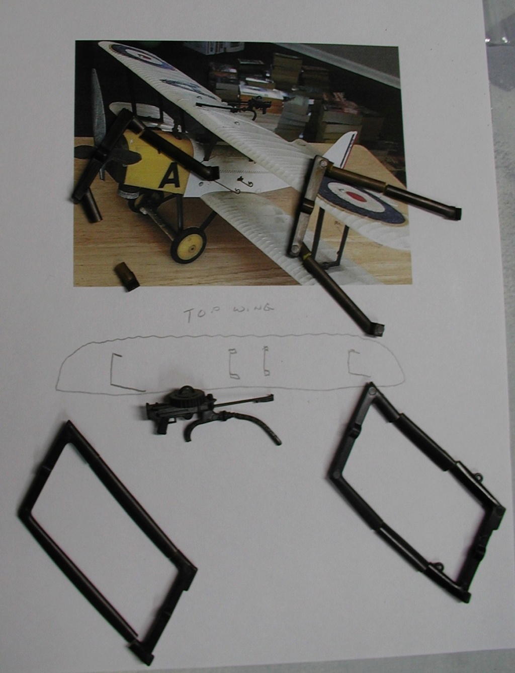

I'm trying to re-construct the broken struts on the postal service smashed Aurora SE5A. These struts are not flat, the tops and bottoms have areas molded into them for attaching hardware. Holding the pieces together au natural while glue, CA or otherwise would be a challenge for even a normal person.
So, I was thinking each part aligned and pressed into modelling clay would work. Then glue all at once ensuring they come out flat and aligned, something that Jason would work with to duplicate on his 3D printer.

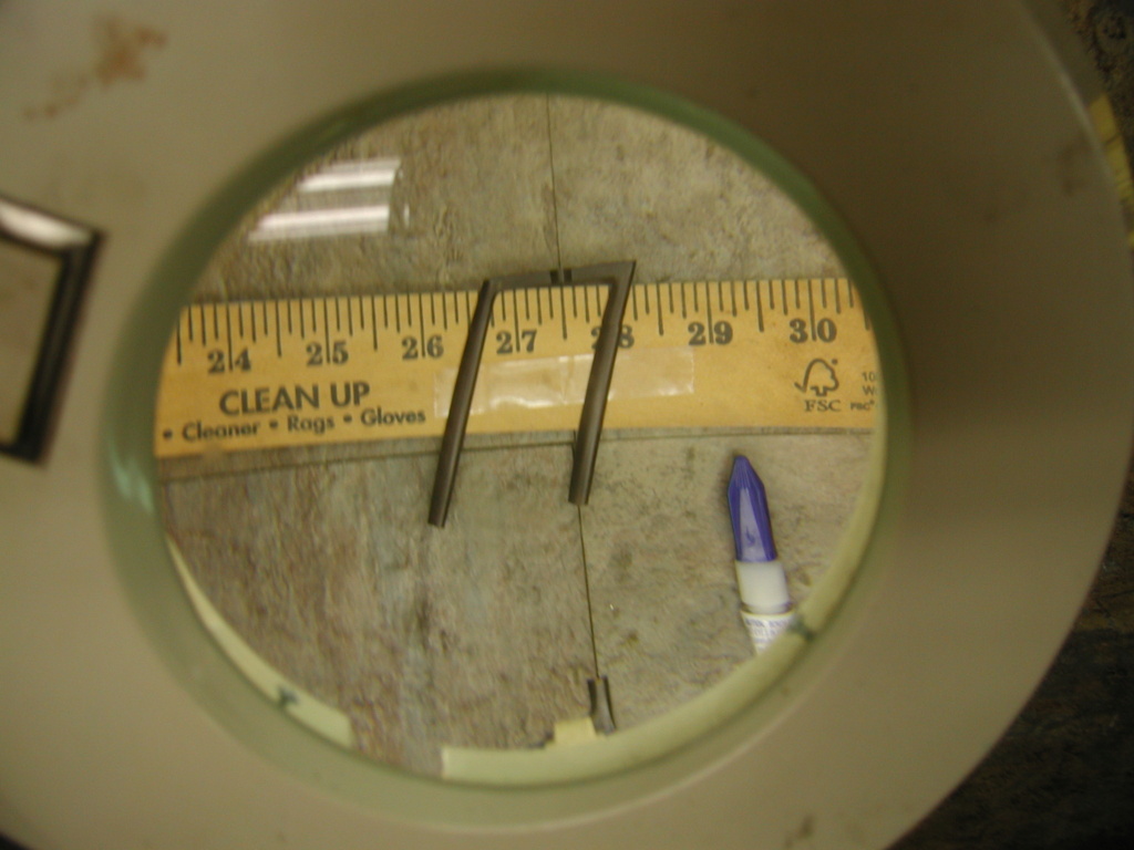

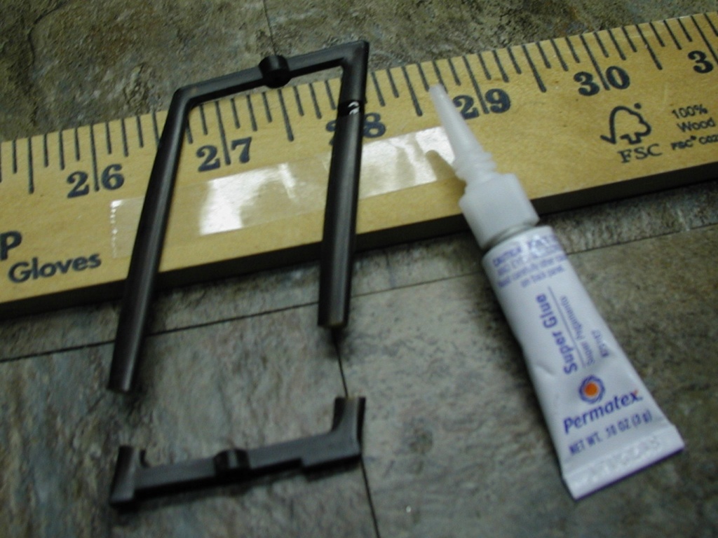

I looked at two of the Blue Stuff videos Mark and it sure works for small parts.  I don't know how it would do for the struts unless it could be laid perfectly flat.  I think Jason's printer is the solution.
I did not remove the Aurora's reed, too chicken.  I want to run it first before I mess anything up.  But it does look that the Cox reed would work.
I got to thinking about Kari's proposal to use tape as a securing source.  I thought, double sided sticky tape on a raised surface buffered by wax paper might do in lieu of clay.  I didn't want to drive 60 miles round trip to get it either.
Even with a securing source it's an effort to align all the parts.  I tried one as a test using a newly opened tube of Permatex CA which did fine on the first parts I glued but didn't on this one.  So I switched to Plastruct Weld which is curing now.
The other strut is really smashed but it has the control line guides so I will have to fix it too, or Jason could have just molded two of the less damaged strut.

The three break strut turned out fine, the six break not so. Thinking........
