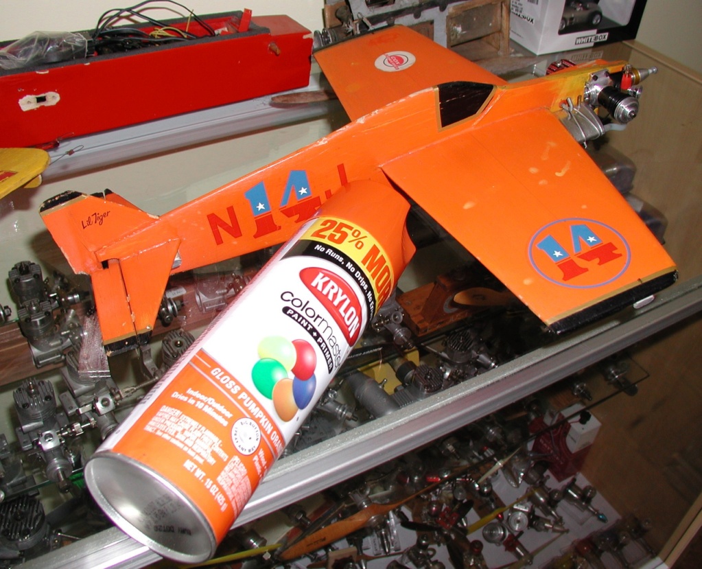

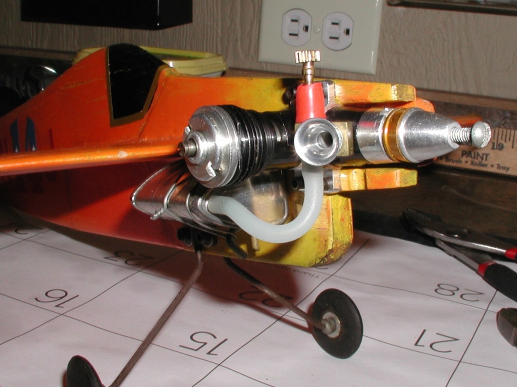

Gave it a bath, touched up some of the black paint on the canopy and hung one of Fred's "franken" Cox engines on it's nose.
Went to the store to find some paint to touch up the missing orange.  Krylon, not a bad match.
Lil Tiger - Gloss Pumpkin Orange Lil_ti11
Lil Tiger - Gloss Pumpkin Orange Il_tig13
I have no experience with these beam mounted Cox engines other than looking at them.
What fuel, what prop, and length of lines should I use?

Dang was afraid my addled brain did not remember all the "modifications" on the FRANKEN TeeDee I sent you
Find a factory stock Venturi if you intend to get dizzy with the Pumpkin Plane and that TeeDee..
I can see in the photo that it is one I opened up a LOT...and polished---that one, for sure, will require a Bladder pressure system to start and run...and if you do manage it ...a 6 x 3 and 35 foot lines will screw you into the ground with 2~3 second laps....grin
hot rod engine on a hot rod airplane...going to be very fun

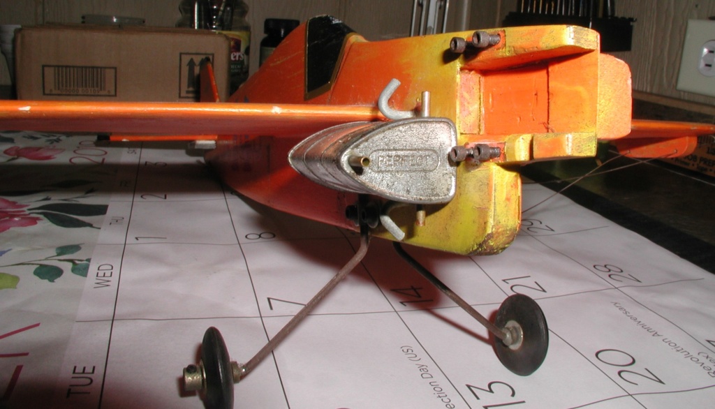

Thanks Fred, I wouldn't know how to rig up a balloon pressure system. I have only used muffler pressure on my R/C engines. Isn't there a tap on the crankcase for pressure? I may have to use a Medallion instead. Going to remove it and test it first anyway.
Model was set up for a Perfect tank of which I have many. A "Perfect" fit I would say, slipped right in.
Lil Tiger - Gloss Pumpkin Orange Il_tig14
Used a newer one.
I have some 15% off brand and Cox 20 and 25% fuel. Thinking the 25% a 6/3 and Mark. Smile

A bladder is simpler than a pressure tank, and gives a nice even run.  There is a trick to start them.  Run off a prime, and then open the fuel line quickly with your fingers pinching the line, or a wire leadout connector or surgical clamp.  The bladder is just latex tubing tied onto regular fuel line with maybe a knot on the end.  I don't like to use them, because I am never quick enough to get at the clamp, but with two people it works well.  There are a few videos showing how.  https://www.youtube.com/watch?v=fPmO4y_Wfd8 Rusty has  a couple good videos too. A backplate pressure tap is probably better than the nipple on the plastic crankcase, IMHO. The easiest thing is a new venturi as was mentioned. The tank is a bit low but it may be ok.

Having the tank that low is going to be a problem. That wedge design is another. Perfect makes a longer one that doesn't protrude so far outboard. Achieving the centerline of venturi in both horizontal and vertical is optimal. Some of this can be accomplished by shimming the engine off of the bearers with aluminum.  These issues automatically place the engine in a lean condition. When the head pressure of the tank lessens both of these issues will more than likely just cause the engine to quit due to excessively leaning out. I personally would notch out the wing for the tank and raise it. If you don't like the look of the notch you can place fairing blocks around the tank from the fuse to the wing root.

Tank location might work if it were an A.C. Gilbert .074 or .11 Thunderhead. Engine likes the venturi above tank level.

It's not realized how difficult it can be to make a speed plane tank. The forces on the fuel load are responsible for the inconsistency. This can sometimes be quickly recognizeable on launch. Bob's example assuming he provides the stock venturi will run on the ground and one can needle the engine to make it run. Another problem that tends to occur is that in flight when the engine is "On", the speed increase dramatically and then the opposite happens. This is due to the plane yawing out and the fuel pinned in the corner, it feeds, then it doesn't, and back again. This is why a wedge is not a good design for this style of engine run. However, I have had somewhat success with the wedge by pulling the pickup slightly out of the back corner. This might take some trial and error by unsoldering it and pulling it forward a 1/8" at a time. I mention this all the time, a Perfect tank doesn't have it's pickup tube soldered internally, it must be soldered to the side wall of the tank. They pushed the tubes in, put it on a hot plate to solder and out the door it went. The tubes in the tanks can be ANYWHERE.
           Another option is to use uniflow, however I have never had good success using it on a wedge tank. I think turbulent bubbles do funny things due to the rounded inside portion of the tank when the uniflow pipe becomes uncovered. I wouldn't even consider crank pressure without experience first. It just floods the engine if one isn't up to par in the starting procedure and many times the hole for the pressure tap is far too large. You only need a hole that's a few thousandth's.

Me too, Chancey. It's come find me orange.
Not very fuel proof though with thinning around the engine and spotting on the wing. Maybe rattle can, could even be that Krylon Orange. I don't recall Top Flight ever offering an Orange color.
If I do use it, I will top coat it with Lustrekote clear.
