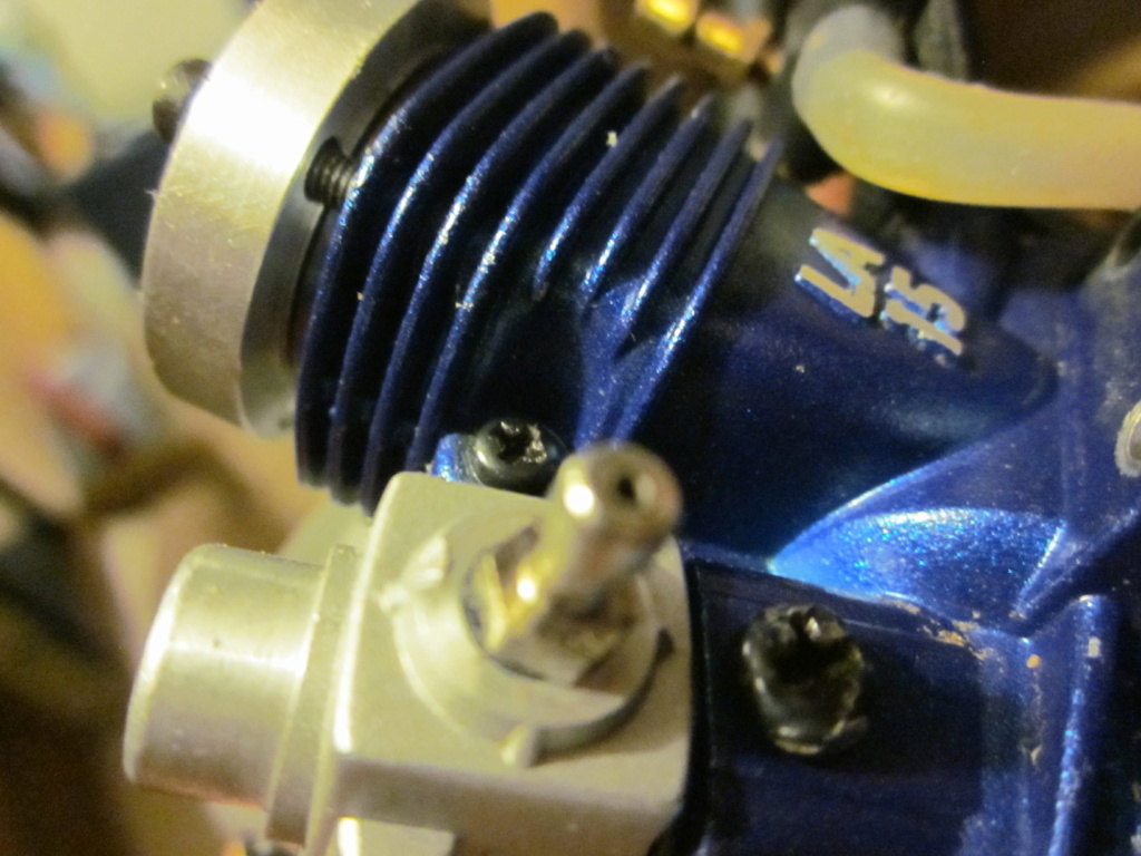

More pics for different redneck setups. The LA .15 nipple broke off when the starter slippedLil satan build, cant decide on a power plant - Page 5 Broken10
Lil satan build, cant decide on a power plant - Page 5 Broken12
Lil satan build, cant decide on a power plant - Page 5 Broken11
, I replaced it with a pressure fitting. I believe I turned a nozzle to go half way into the venturi hole, it also has a turbo plug head that I made up. The springy thing on the broken LA needle is just so it can still be used. I shortened the wire so it would not vibrate. Just a combat plane fix.

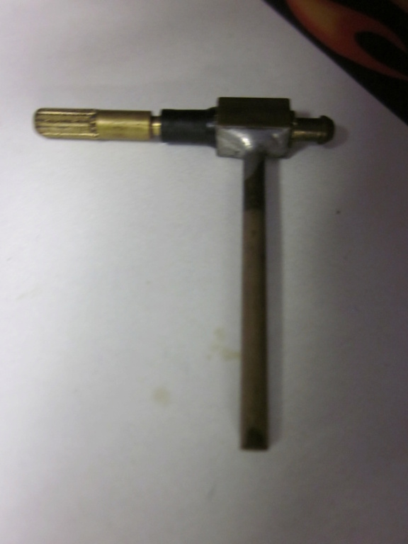

Post  aspeed Thu Dec 22, 2022 11:13 am
This is the springy thing.  I have more pics but can't find them on the computer.
You may notice that the nipple broke off and was replaced with a pressure fitting.
Kind of a double redneck fix. Lil satan build, cant decide on a power plant - Page 5 Broken13
