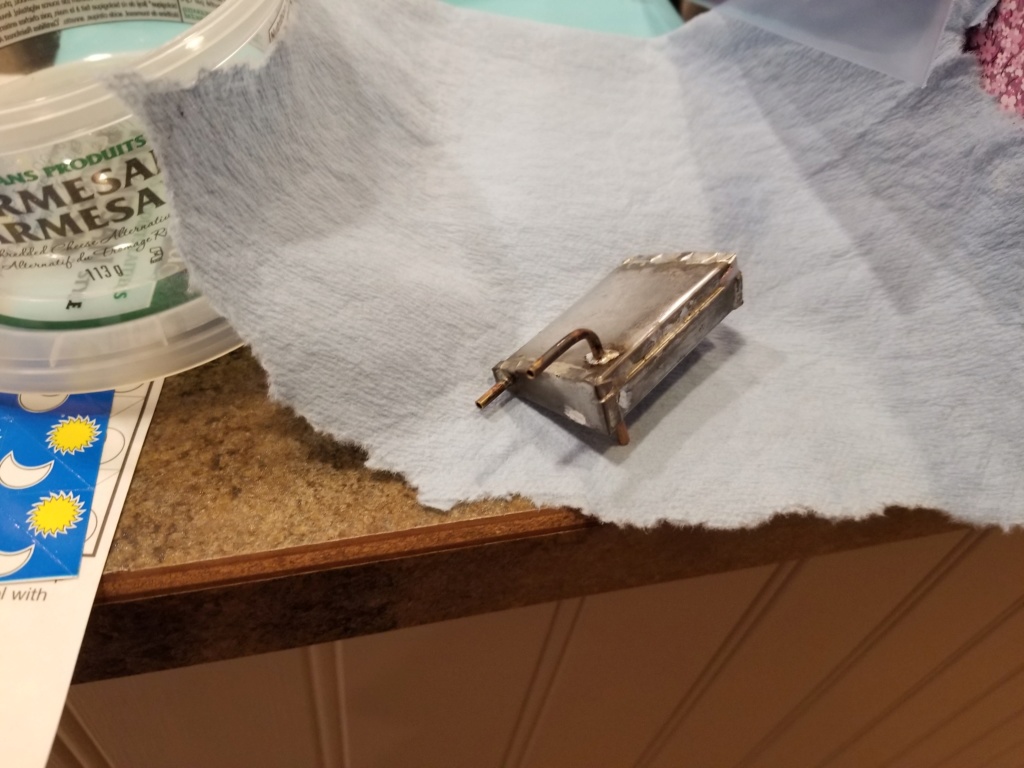

Post  layback209 Wed Mar 06, 2019 11:35 pm
Here's where I'm going with the build so far. Trying to fabricate a tank. Turned out so far, may have been a bit generous with the solder, learnt some stuff along the way to. Going to bump the belcrank a bit in board to make room for the tank. Based on how tall the ribs are it had to be fairly slender to sneak 3/4oz in there. Going to go with a beam mount but use the radial mount wood to beef it up a bit.

Post  layback209 Sun Mar 17, 2019 8:37 pm
Tah dah, now to test for bubbles. Learnings, silver solder works way better, solder flows to the heat so make sure you use gravity as well yo your advantage. Keep the solder away from the torch. And use a good flux wow does that stuff make a difference. Use a small piece of damp cloth or paper towel to keep joints from melting when your heating adjacent to finished areas.
A dimond cone shaped bur for the dremel is perfect for making the brass tub holes.

Post  944_Jim Sun Mar 17, 2019 9:19 pm
Hey, great job on that tank! Don't close it in until We (me) get to see it mounted and jigged with an engine. I'm taking notes!
