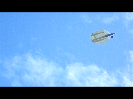

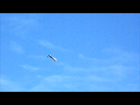

I don't use trim tabs on a rudder as this doesn't seem to work for me. The tab gets bent, or moves, or tears out. I make the rudder always straight. However, I fix a coin to the right wingtip and on the CG. The exact weight, you have to determin yourself by test gliding. The model should slightly glide to the right and under power, the engine torque should be able to tilt the model to the left. This has worked for me.
Model climbs in left circles:
and glides down again in right circles
