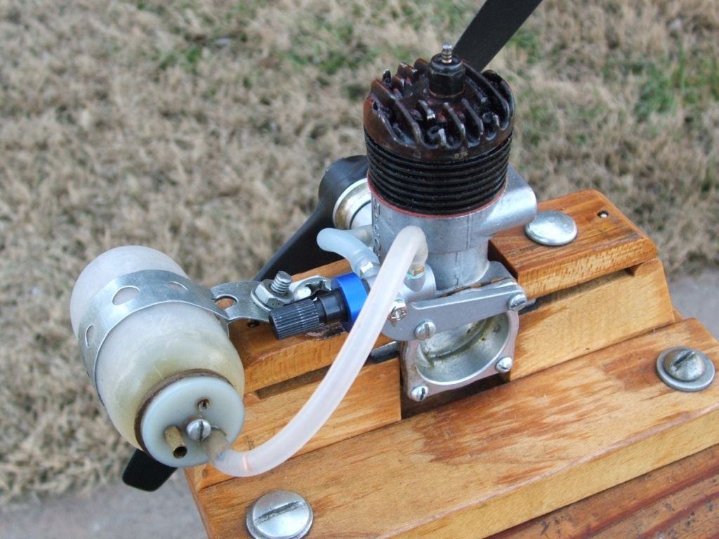

What is the general consensus. How many hours will a glowhead keep working? Using 25% nitro and 10% castor. My estimate seems to be about two hours max? Does that sound correct? Curious to hear what others have found.

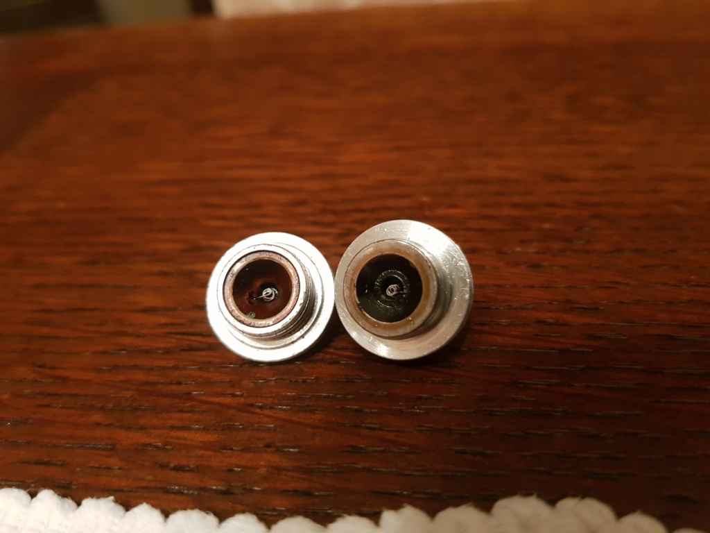

To isolate things inspect your plug. I do not care the brand. Inspect for contamination. Use a magnifying glass and make sure the wire is where it should be. Use a T pin or similar to gently adjust if necessary.
I have read about using a T or hat pin and testing the ends.
https://coxengines.ca/engine-and-fuel-guides.html
See the document
Gibeault Mouse Race Program
Test the plug at 1.5v in a darkened space. A cupped hand under a tool box lid is usually dark enough. A drop of fuel then shaken out of the coil cavity will briefly smoke under power.
So, we now know the plug is "good" right now without much question.
Next we need to not cause premature failure by overcompressing the engine.
Good fuel prevents buildup in the element. Regular cleaning of the engine and prevention of debris entering the combustion chamber also helps.
The last concern is that many plugs the wire is plated and not solid. Use will remove platinum plating eventually.
Best of luck. These things are like incandescent light bulbs, they work now, but may not work next time.
