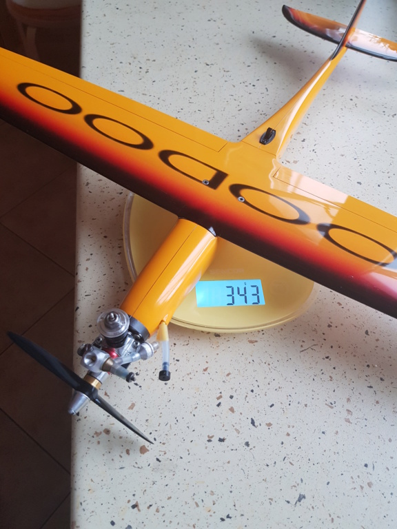

I wonder how much it weighs? My TeeDeeVooDoo's all up weight is 343grams and it plows the sky real fast:
Posts : 3271
Age : 62
Re: PIYURIN .010 * flight video *!! and now also .020...*flight video*
343g is 12.1oz

My Nano X with a tuned pipe is 235g / 8.3oz 3ch it takes focus in design and components to get to that weight.
My Nano IV hit 8.2oz / 139 mph without a pipe/header. I saved weight by building 8% smaller plane and used
new low weight metal gear servos.

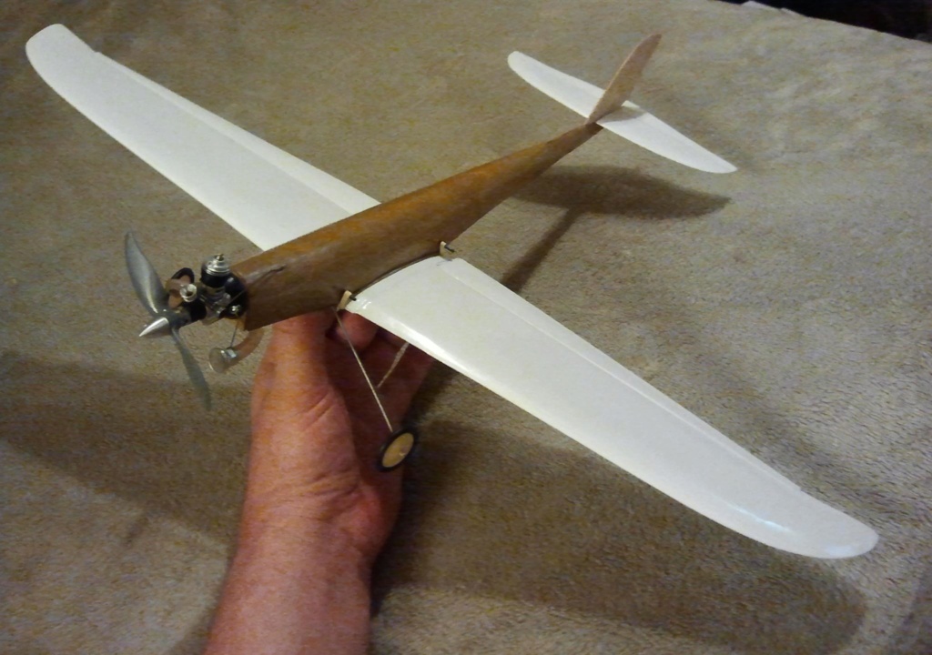

Mauricio thank you for sharing reasonable weight for 3ch TD .010
Specs:
What size battery is that 4.8v 220mah?
What is the wing span and sq. in?
Fuselage length?
+12g for my 2014 ply fuselage plane:
Lil Speedy I:
Nano I / TD .020 / 3.38 oz
Nano II / TD .010 / 2.22 oz
Also:
Lil Speedy I / TD .020 / 5.3oz
Lil Speedy II / TD .049 / 6.19 oz
Specs:
Fuselage length?
Lil Speedy I:
Also:
