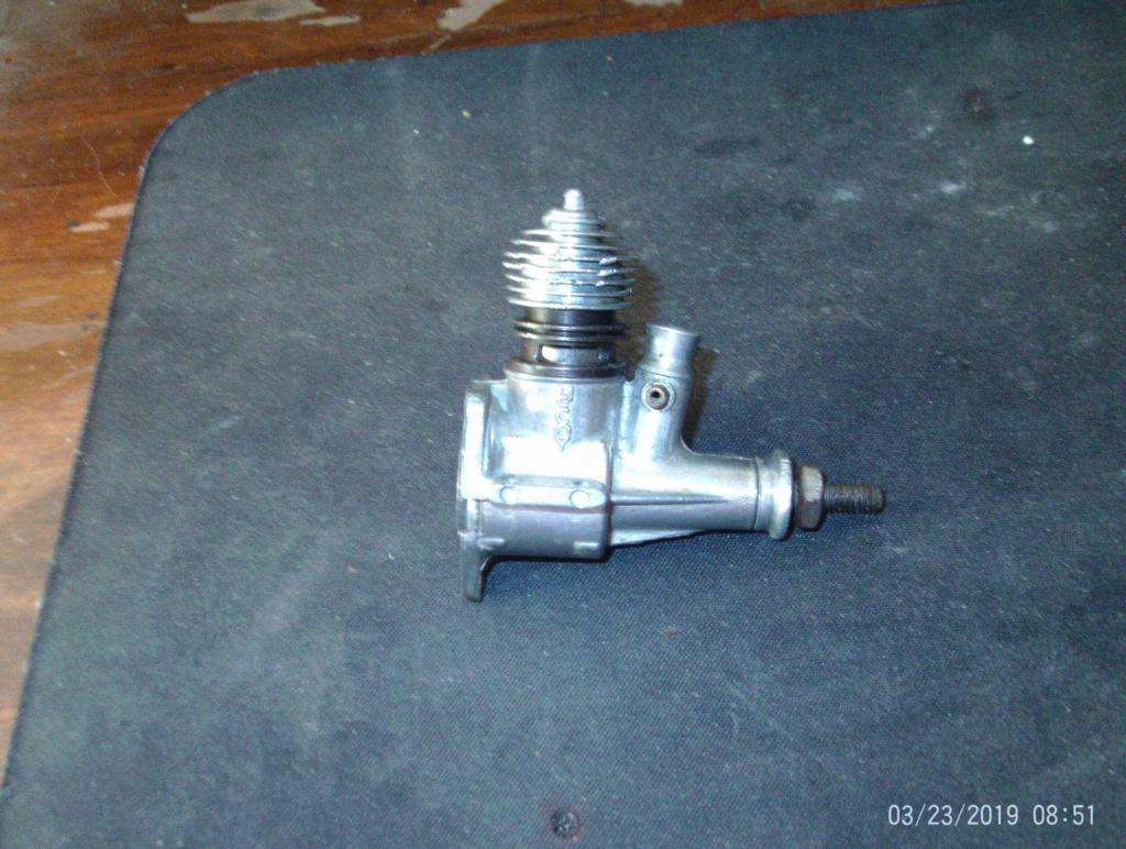

Got one of these the other day and the piston / rod has some pretty good slop in it , can you reset the joint like a Cox ? and you can see i will need a needle for it , Does it have to bee a McCoy needle ? Thanks , Eric O yeah i thought it was going to bee smaller but NOT . Huh... Laughing McCoy 5 information please  Ptdc0131

You sure are pulling in the model engines lately Eric.
Your about where I was two/three years ago when I was buying everything that wasn't nailed down.
I have a lot of McCoy engines, but none that look like that. McCoy 5? Never knew that made one or are you rounding up .049 or is it a model 5? Weird head, all those fins!

I'm suspecting that someone "bozoed" an Atwood glow head on it.

ticomareado wrote:I'm suspecting that someone "bozoed" an Atwood glow head on it.
I agree, it does look like an Atwood head, but here's a picture of what it probably looked like originally.  Cylinder and everything else looks correct.

Post  getback Sun Mar 24, 2019 8:05 am
Yes Bob been building my engine collection back up from when i had to get rid of a bunch in my depression years Sad But all is good guess i just got 1/2 a McCoy 5 should have did more research on it , hopefully i will have a needle to fit somewhere here !>?

Post  ticomareado Sun Mar 24, 2019 8:20 am
Who knows? It might run fine with the Atwood glow head. If so, it will probably run good on a plug version of an Atwood or Wen Mac muff. In which case, finding replacement plugs won't be such a problem. Keep us posted.

Post  getback Sun Mar 24, 2019 8:56 am
Will do Tic , do you know if the ball joint can be reset ? as i said it has some play .> Got a lot of irons in the fire right now with Garden season coming and me Not ready as usual. Smile

Post  Mark Boesen Sun Mar 24, 2019 1:02 pm
The McCoy '5' came out in '58 and was never advertised, based on the '55 Baby Mac McCoy 5 information please  01710

Post  Mark Boesen Sun Mar 24, 2019 1:06 pm
i'd think a McCoy, Wen-Mac needle would work, unsure about ball socket, all you can do is tear it down and look?
