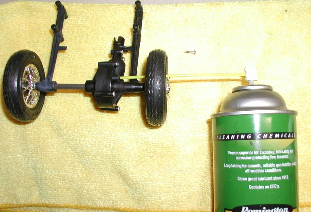

Works in my Cox Mercedes differentials too where they leave a hole (screw secured) for applications of a light oil.
