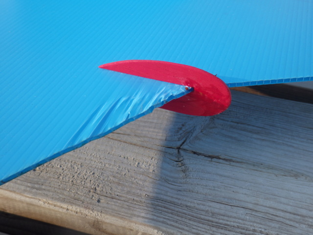

The plane must have hit a tree. Both wooden elevon retainers were gone and a small part of the wing got crushed.

The repairs are easy. I'll cut out the rippled bit and replace it with a new piece of blue corroplast, glue the nose back on and replace the elevon wood things. I noticed I lost 2g of lead during testing but the plane seemed to fly just fine.

I repaired the wing by cutting out and replacing the damaged piece. Both balsa elevon retainers were remade of thicker wood. This gives a larger contact area for glueing. I added some iron wire to the nose cone. The cone was first butt glued only. The wire goes into the flutes to adhere better with the époxy.
