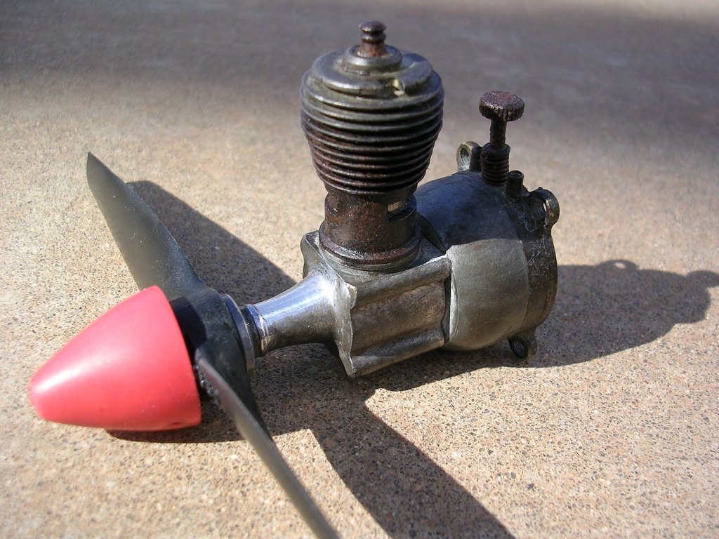

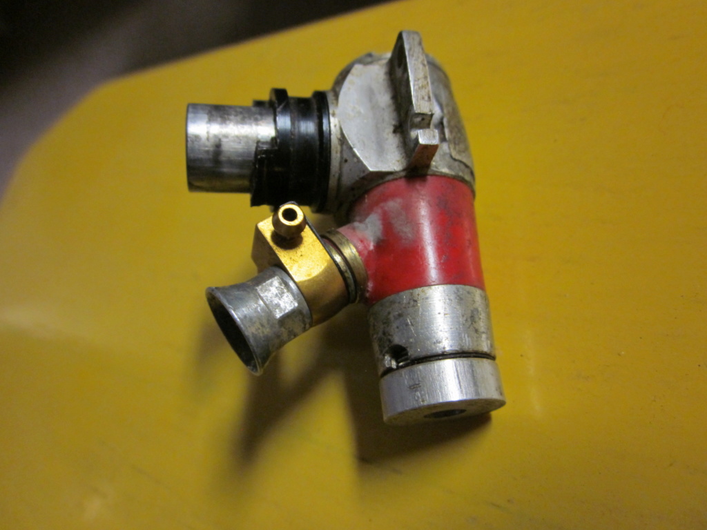

There are some engines that started out really rough and were restored to running glory again. Bob has done such and others here. Here is a 1960's Babe Bee that was a field find by my son, before and after.
Here with a late model K&B .35 Stallion CL engine, I turned soured apple cider into pure ale:
CEF: K&B .35 Stallion Acquisition
Even if the engine seems rough, may turn out satisfactorily, also with a little elbow grease. You'll never know until you give it a shot. Sometimes it works out well. A few times I've had an unsalvageable situation.

Pretty nice resto! As an aside, though, that patina looked amazing. Almost wish you coulda got 'er pristine on the inside but left 'er lookni' old and neglected on the outside. Woulda looked boss on a post-apoclapytic themed bird that way.
Also a lovely read on that K&B 35. Makes me wanna grab a random reedie off eBay and restomod it into a throttled SureStart like the ones I've been buying brand new from Bernie.
