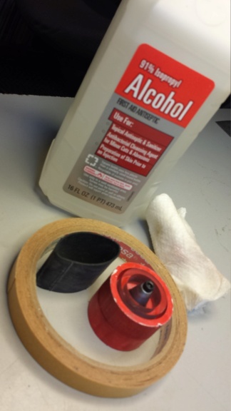

CEF member Marleysky (Rene) offered an idea for anchoring the tire onto the wheel that I'm using on the Rodd-E-Liminator.. Smile While I "do" have contact-cement somewhere.. I chose to try adhering the Butyl-rubber tire to the PVC wheel using some double-sided "film-tape" from my old remnant sign-shop stock. Rene's "method" for its' application however; was adopted..
Cars-Stars 2019 "Rodd-E-Liminator" - Page 2 Phat-t19
Cars-Stars 2019 "Rodd-E-Liminator" - Page 2 Phat-t20
Cars-Stars 2019 "Rodd-E-Liminator" - Page 2 Phat-t21
One half of the wheel-width set-up..
Cars-Stars 2019 "Rodd-E-Liminator" - Page 2 Phat-t22
Cars-Stars 2019 "Rodd-E-Liminator" - Page 2 Phat-t23
I needed to re-paint the wheel after all the poking/prodding.. and tonight; I decided to add a 2nd tire-wrap.. although without any type of adhesive. The 2nd tire-wrap seemed very tight; when stretched-over the first. We shall see if it blows-off when the engine comes alive. The tires are made from Butyl-rubber "bicycle-tire inner-tube sections" from 26" tubes. I'd like to source a 27" inner-tube.. because it would be a smaller diameter.. and hence; a tighter-fit on my wheel...

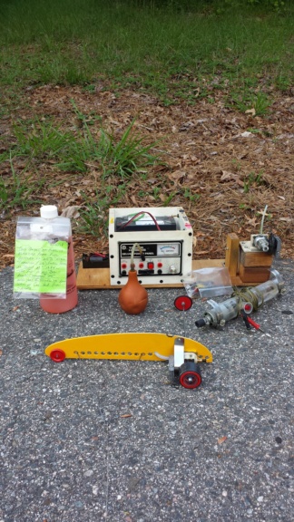

Post  roddie Mon Jun 03, 2019 6:04 pm
CEF C.A.T.S. contest-night (cont.)
Cars-Stars 2019 "Rodd-E-Liminator" - Page 2 20190631
Cars-Stars 2019 "Rodd-E-Liminator" - Page 2 20190630
Cars-Stars 2019 "Rodd-E-Liminator" - Page 2 20190632
Cars-Stars 2019 "Rodd-E-Liminator" - Page 2 20190633

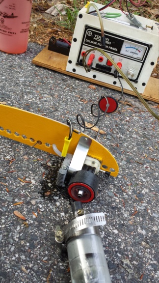

I'd forgotten; with less resistance on the crankshaft.. the mixture needs to be leaned-out substantially. Only after closing the needle (almost fully..) the engine started to pop..
I had x2 layers of tire (inner-tube) on my drive-wheel. The 1st layer was adhered using double-sided film-tape.. and the 2nd layer was just wrapped-over the 1st. When I "cold-started" the engine.. the 2nd layer "blew-off" (out of sight.. Shocked  ) but the 1st layer stayed-put.
The first "tether-run" showed promise. The engine was screaming.. I pulled the glow-clip off and let the car go. It took-off like a shot..  and completed  x1 lap (12 foot tether) before I could move the the support-gear out of the way. The outboard wheel snagged the electric starter wire.. and fouled the run.
That incident "yanked" the bridle hard-enough to pull one leg out of its' 1/64" ply disc-retainer.
Cars-Stars 2019 "Rodd-E-Liminator" - Page 2 20190532
I made a field-repair.. but the second tether-run "ate" the tire.. and stalled the engine.
Cars-Stars 2019 "Rodd-E-Liminator" - Page 2 20190634
I should have applied "Marlysky's" (Rene) advice on adhering the rubber to the wheel using rubber-cement.. Rolling Eyes

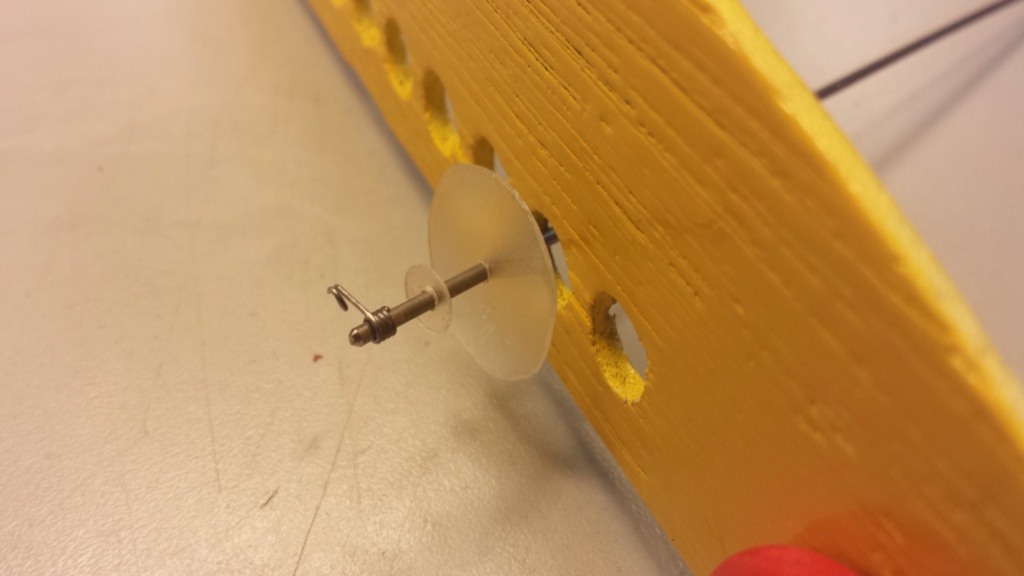

Oh yea.. I know that all too well now.. Rolling Eyes SoOo.. I re-worked the bridle-mount tonight. I had originally fashioned a pair of  1/64" ply discs (3/4" diameter) center-drilled for the 1/16" music-wire. Retaining them with only "spring-collar"s was foolhardy. The first run which fouled on support-gear proved that.
Cars-Stars 2019 "Rodd-E-Liminator" - Page 2 20190533
I tried bushing the thin ply-discs with plastic flat-washers.. but the drive-tire was too far gone for another run.
Cars-Stars 2019 "Rodd-E-Liminator" - Page 2 20190636
Tonight I replaced the 3/4" diameter plywood discs with plastic ones.. and reinstalled the smaller 1/4" dia. plastic flat-washers over them, for safety.
