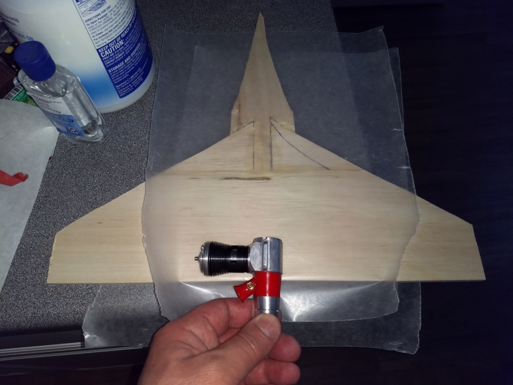

Here we go!
2019 CEF Run What YA Brung UNLIMITED speed contest Build Log by 944_Jim Img_2097
2019 CEF Run What YA Brung UNLIMITED speed contest Build Log by 944_Jim Img_2096
I plan on hanging just enough rocket body tube below the "profile fuselage," and strengthening the slab wing (no ribs).

Ok...pretty it ain't!2019 CEF Run What YA Brung UNLIMITED speed contest Build Log by 944_Jim Img_2098
I'm experimenting with Titebond II on this one. My hope is the aliphatic glue will keep this high-power beast together for 15 laps. No where did I read a requirement to land and attempt a second flight!
I plan on cutting my .015" lines down to 42' to meet that requirement...and to minimize line weight between me and that stub of a wing!

Ok...Cat is out of the bag. I took the Super Bat plans from eBay just for the outlines. I'm not into speed, but figured my Mosquito slabby flew well enough, so maybe this could too.
And I'll need all of 42' since I plan on JATO launch. The real stretch, and most probable reason for getting disqualified is the Medallion!
Posts : 1726
Sad Re: 2019 CEF Run What YA Brung UNLIMITED speed contest Build Log by 944_Jim
Post  944_Jim Mon Apr 08, 2019 11:39 pm
Oh, and I'm trying to do this on one 4"x36" piece of 1/4" balsa plus whatever scraps I have in the left-overs box. That .15 is going to be heavy! At least the rock on the string might have directional control for a few laps.
I'm planning on a balloon tank right behind the engine. Ribs as shown in the plans will be thicker, and just to keep the wing from folding up since there is no real leading edge...especially with the engine set into the wing.

Post  944_Jim Tue Apr 09, 2019 2:36 pm
Thanks Fred,
My concern is the grain is parallel to the "leading edge," while there will be that huge cutout for the engine. I expect the "ribs" will help keep the wing flat. I won't be skinning this with anything but paint. I plan on ONE flight for record, and test.
And I'm thinking no paint either...again, one flight for record. More pics tonight.

Oh, and quick CG check for the parts shown....right on the engine cylinder! I may need to move the engine forward just a smidge. Bwahahaha!
