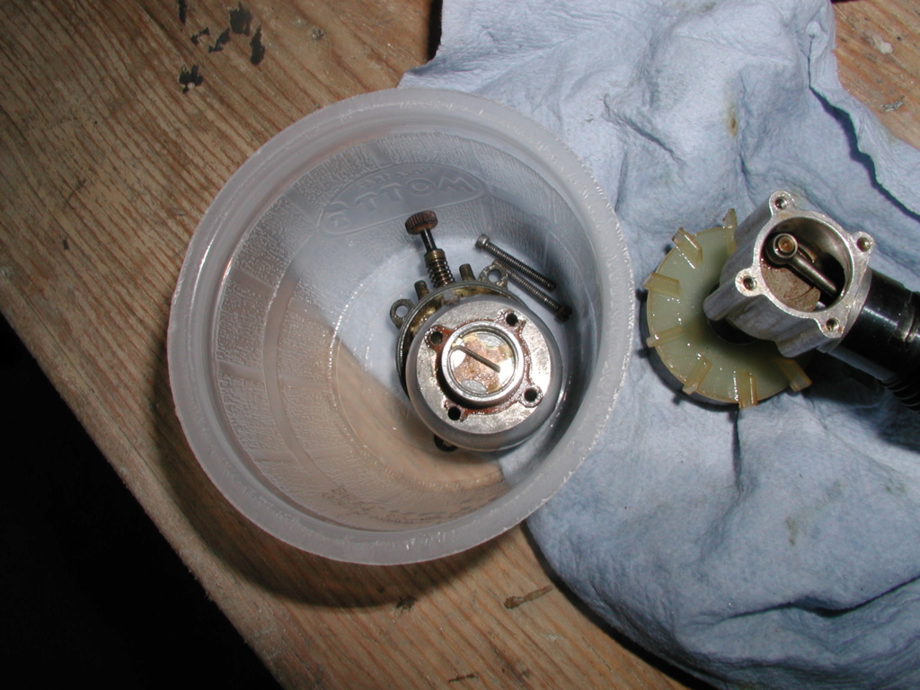

Fuel, fire, and compression gave a resultant wrong direction pop which loosened the flywheels machine screw. Darn, got to pull it all apart finding out why they put a stunt tank in these as a full tank of fuel dumped on the driveway and me when I turned it over to remove the screws. As I said, mightily screwed up as it does not have the correct stunt engine in it.
Blue locktite solved the loose machine screw problem. Then it wouldn't start. I cranked on the right side wheel until the octagon shaped axle wiped away the same shaped plastic wheels inner hub. So I switched to the left side. Still no joy.
Who said tether cars are fun?????????
Pulled the engine, got it to run great off the prime. Time to pull the tank and dump more fuel. I think a new reed is in order.

I don't understand why the engine didn't run. Nice clean rotating old time star reed is in good shape.

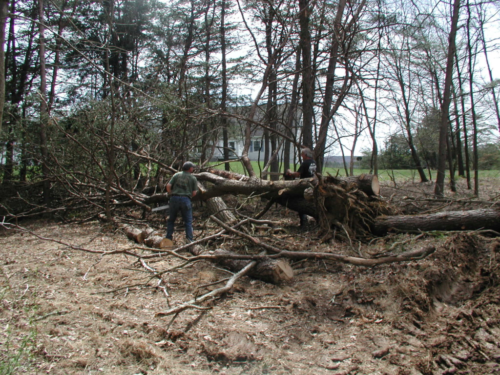

Took the three of us about seven hours to cut those trees into 12 foot sections and dispose of the branches. Smarter than me he brought the front end loader/backhoe. Much better suited for the job than the dozer.
Nice having kids around that know how to do things.

Good to see you got help with the tree downed removal , on the engine sounds like your not getting fuel through the needle assy. I would ck. that with the B-plate off i just take a piece of hose and see if you can blow air through it from needle inlet / cover the Vent hole in back / if not its stopped up . At least U tried i am working on my stuff
