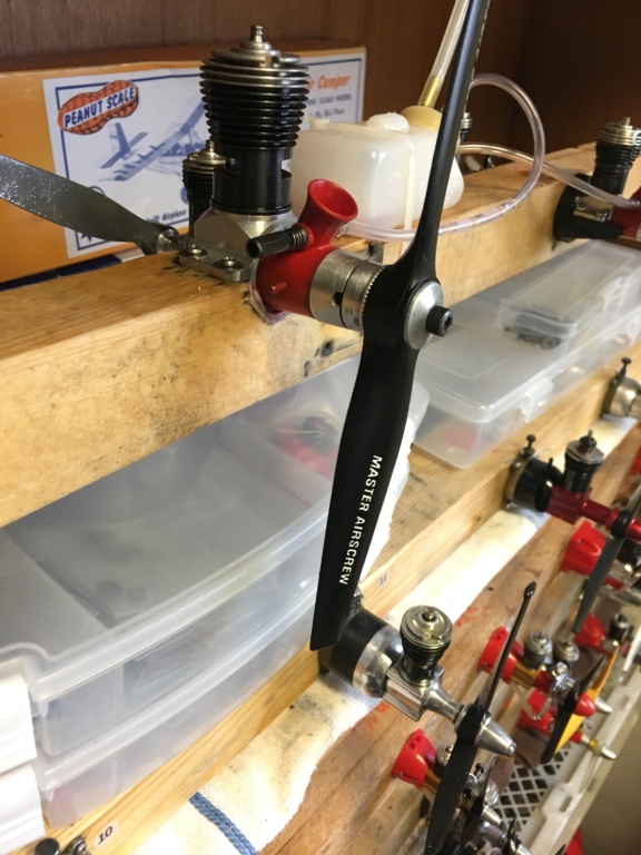

I like to cut my needle body down, drill and tap for a socket head screw and use a ball end hex driver to adjust the needle setting. You could do something similar and epoxy or solder a socket head screw into the hollow of a shortened needle body. This keeps your fingers away from the spinning prop and by shortening the body helps minimize the needle bounce. See my avatar for an example.
