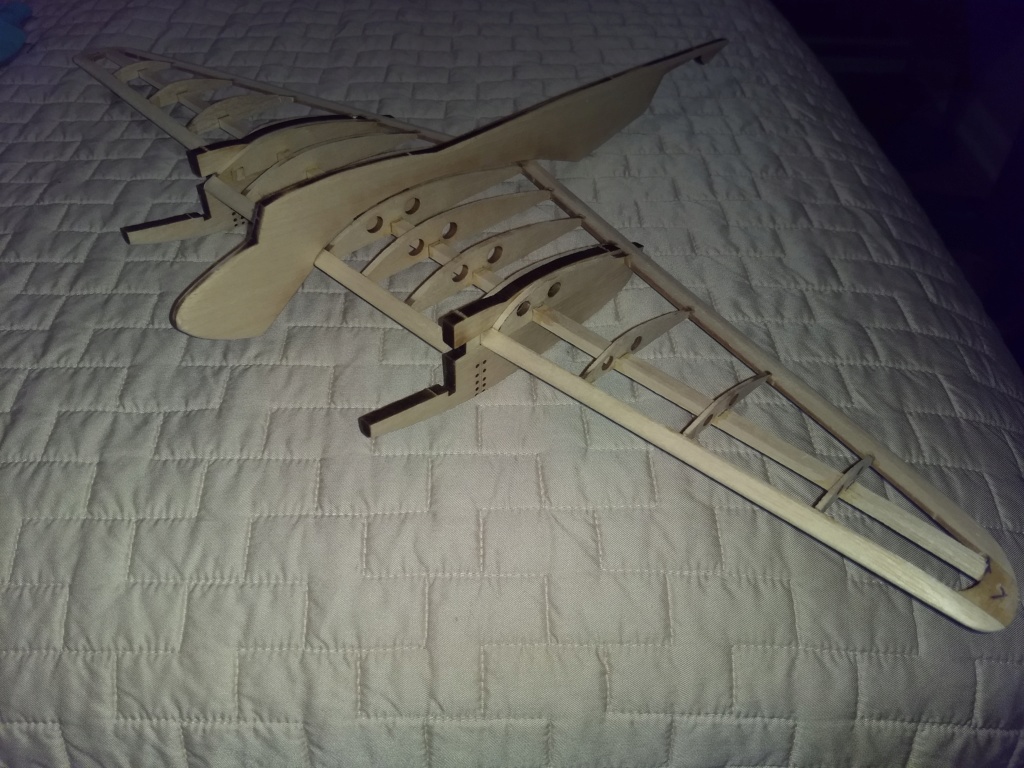

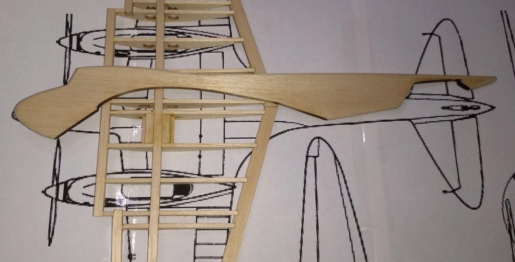

Back when I wanted.to build a twin, I bought my BHM Mosquito. I really hated the plank wing, profile fuselage kit. In the end, I built it anyway.
While researching other Mosquitoes, I came across this one. I can't remember the website I scored it from, but it was English, as in, across the pond.
More digging to ID it ensued. A fellow on RCGroups identified the plan, and even provided a quality copy from the magazine it came in. The scans are over there.
Dave Cowell of DPC Models did the lasercut for me from the plan I provided. I don't know how it came out to be the "junior" version, but decided to power it with a pair of .020s. I'm on the fence between Pee Wees or Tee Dees. I have a pair of each.

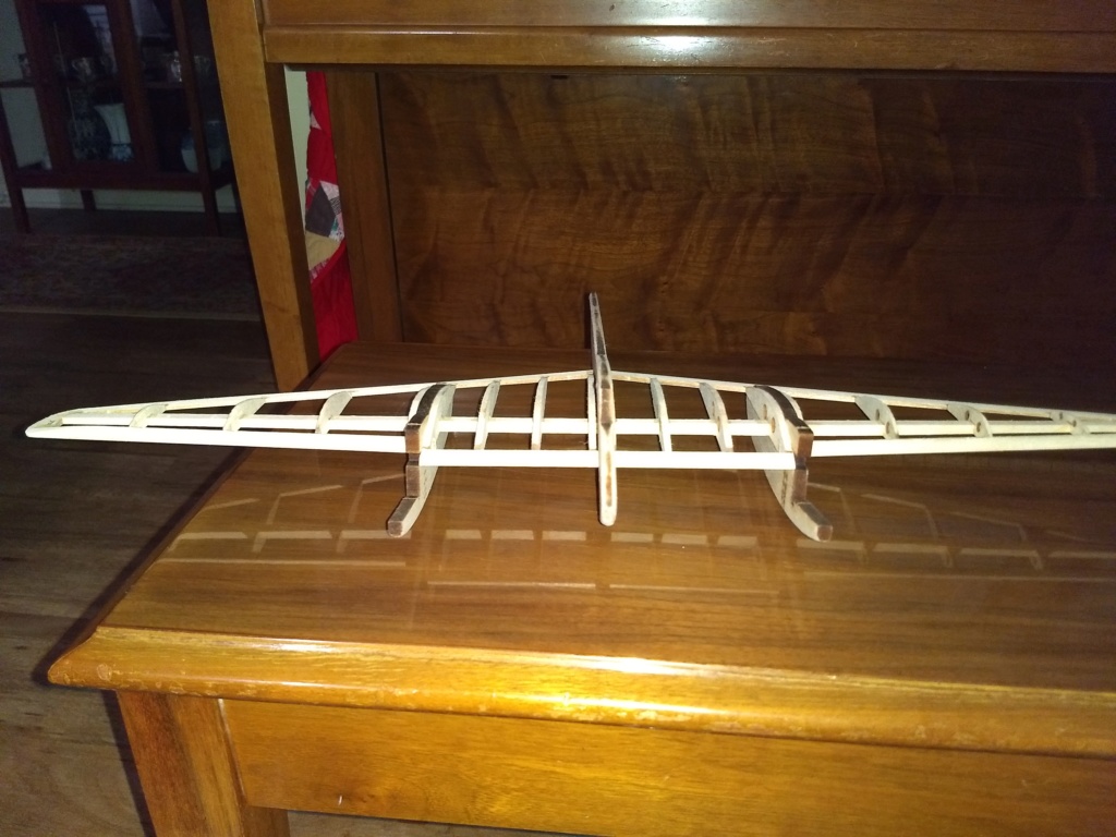

One of the things that drives me nuts is a flat bottomed wing that tapers down in thickness. It makes the wing look upside down when viewed head-on. The plans even indicate tapering the wing spars down from the top in order to make the wing easier to build. Well, I've been looking at the bones for too long. The build began today using aliphatic wood glue...it seems to work well enough for my speed entry.
There are mistakes, but I'm not pointing them out. In the end, the wing should taper up off the table, while the top tapers down. I hope this gives a nice look to the wing:
