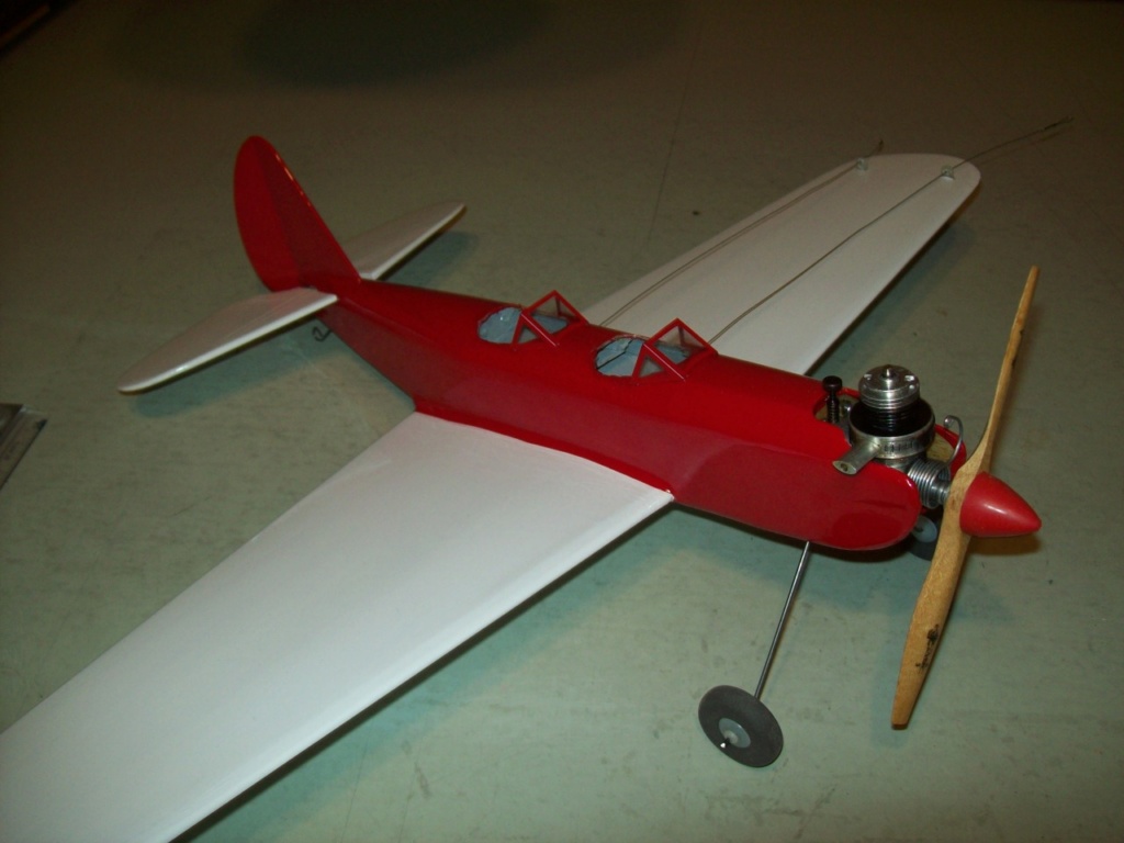

I saw the thread about the PT-19 "Fly It If You Got It Day" and it made me realize I didn't got one anymore. Had a red & white one 50 years ago. Then found a drawing of the original online, and set about to build a balsa one.
PT-19 Replica 100_1310
This is the first all-flying tail I ever made. I hope it works. Covered with Monokote because I come from the RC world and I have lots of it. Weight is 6.7 oz.
PT-19 Replica 100_1311
Found a used Babe Bee and added a muffler. My old one didn't have an extension like this on the muffler, but it may keep the plane cleaner.
PT-19 Replica 100_1312
The only thing lacking now are pilots. I would like to find a pair of original Cox PT-19 pilots to do the flying. If anyone here can hook me up, please PM me.

Can you elaborate a bit how you made the back-top fuselage, between the aft cockpit and the fin?
What thickness and density balsa did you use for the wing? What carving technique for the airfoil?

Thanks for the interest guys! The fuse top is sheeted with 1/16" balsa to the former behind the rear cockpit. From there back, it is strip planked with 3/32" x 1/4" balsa, and sanded to blend with the sheeting. The wing is a built up structure, not carved. Each panel consists of a 1/16" bottom sheet, cut to shape, and a full depth spar. Since the panel is so small, there are only 3 ribs; root, mid-span, and tip. 1/16 top sheeting. 1/4 sq. LE, sanded to shape.

What is the all up weight of this beauty?????

With the new pilot aboard, weight is up to 6.8 oz. from 6.7. Going to have to have a discussion with him about his diet.
