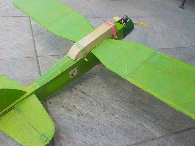

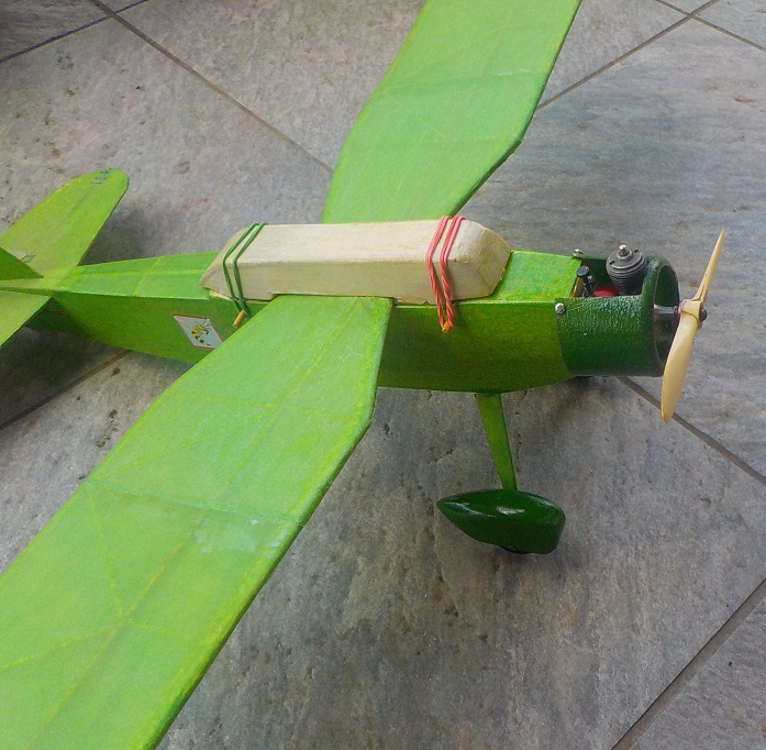

I made this model years ago, one of the first ones that I created, and I flew it electric for a long time, until I had a less than ideal landing, and the firewall to which the electric motor was mounted to came off.
This gave me an idea to use a Pee Wee that I had lying around and here are the results:
LWS 3 with a Pee Wee Dscn1910
LWS 3 with a Pee Wee Dscn1912
LWS 3 with a Pee Wee Dscn1911
LWS 3 with a Pee Wee Dscn1913
The airplane this model is made to look like is a Polish observation aircraft from the WWII era: https://en.wikipedia.org/wiki/LWS-3_Mewa not dissimilar to the much more well known Westland Lysander.
The wingspan is 55cm (22in) and the weight is 115g (4oz). It uses two 3.7g servos.
Haven't flown it with the glow engine yet, but as soon as I will, I'm gonna make sure to share a video wit you guys.

I LIKE IT! The Pee Wee looks right at home there! Have you done any fuel/oil-proofing to the model? One area of concern is the hatch above the wing. Oil could get in/under there.. and into the interior of the fuse. The hatch-block itself appears to be bare-balsawood. Some sanding-sealer followed by clear polyurethane should do the trick. A light-misting of clear polyurethane aerosol to the entire model would give a little more protection from oil.. where it had previously been an electric-powered model. Test a small/inconspicuous-area before spraying the whole model though. Two Cents

The entire front of the fuselage up to where the squadron marking with the wasp is, including the canopy is sealed with epoxy. I am indeed a bit concerned with oil finding its way into the inside of the fuselage. On the other hand, the engine sits pretty low on the fuse, with just the head poking out, so maybe it'll be alright. We'll see soon enough.
