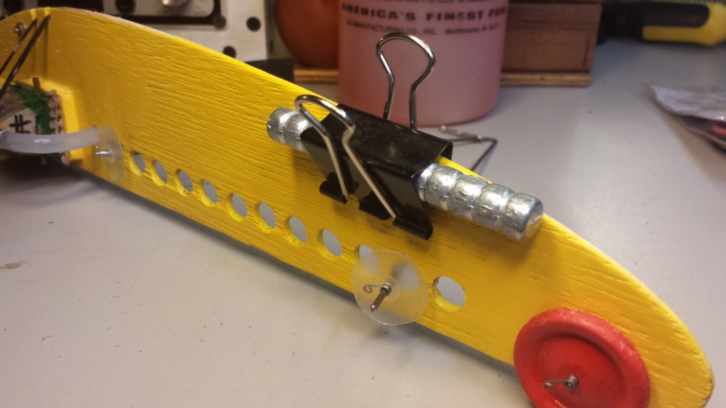

For the next trial, I added weight to the mid-frt. of the car by using a binder-clip and pinewood-derby car weights. This added 1.25oz. to the car.. for a total weight of 6.75oz.

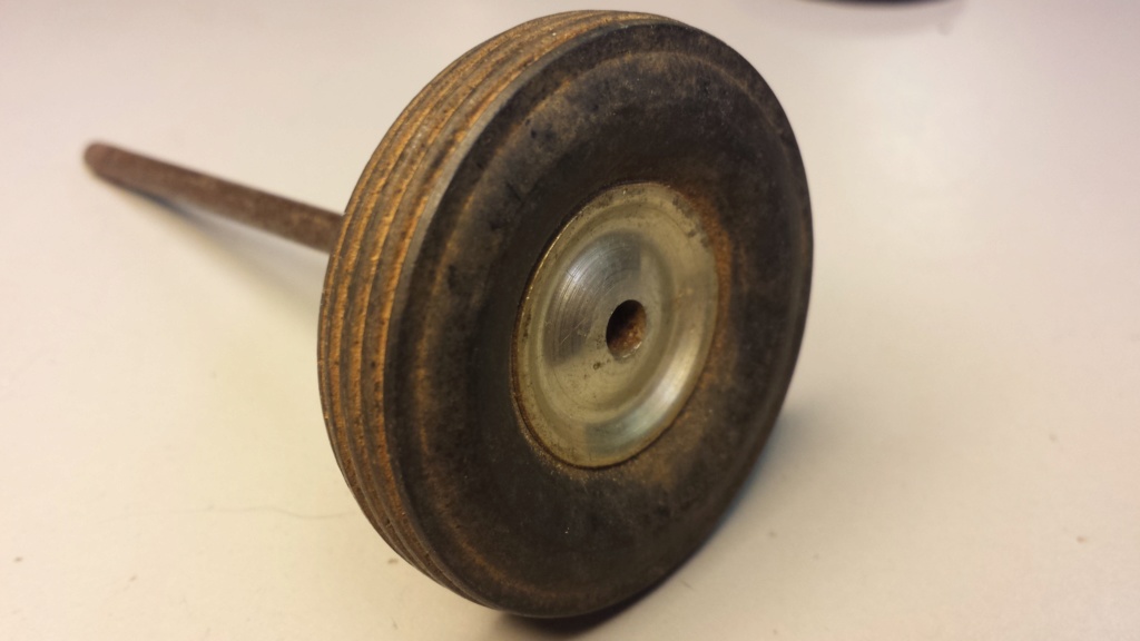

I then decided to see what else I had in my "wheel box".. that might possibly work. Huh...
This axle had two wheels mounted with solid rubber tires.. so I removed one to give it a try.

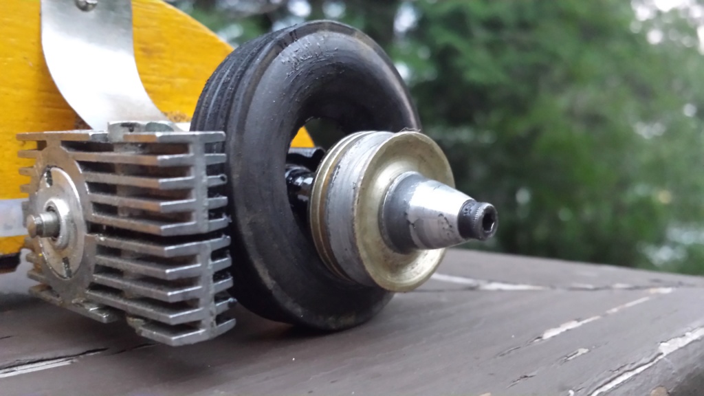

This latest run of my car held promise. The wheel/tire composition I thought for sure would be the key to getting it to hook-up.

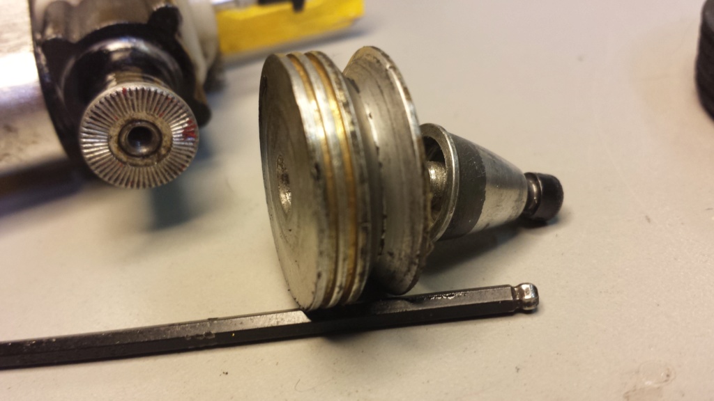

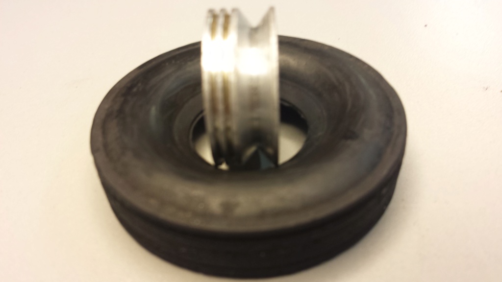

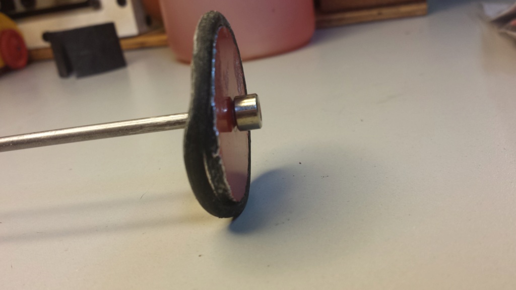

Today I took a look at the wheel and tire, to check their condition. It actually turns-out favorable.
"Against all Odds" Rodd-E-Liminator vids 7-2-1910
"Against all Odds" Rodd-E-Liminator vids 7-4-1910
"Against all Odds" Rodd-E-Liminator vids 7-4-1911

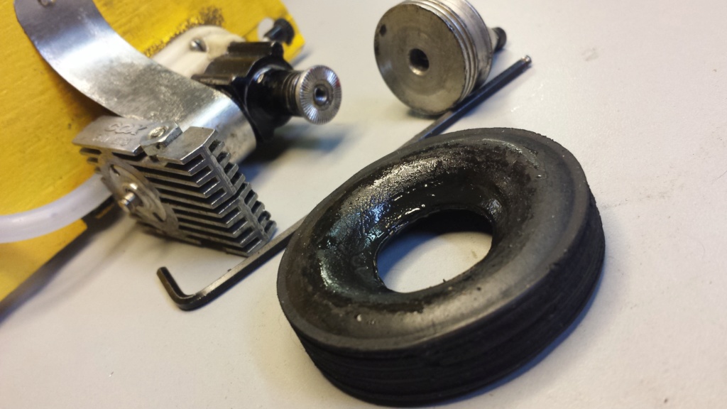

The "wheel" is a high-quality billet-aluminum piece with a deep V-groove for the tire to seat. The tire is of a hard-compound/solid-rubber construction and after cleaning-up both.. it looks like they're ready for another run; providing I can get the tire to stick to the rim. I'm going to try launching with a "push".. next time. Even the model hydro-plane "boats" need a push, to get them up on "step". Maybe that will help get this car going?? Huh...

I believe that the tire was spinning.. rather than the rim spinning within the tire. The tire "did" separate from the rim.. but not until the 3rd lap or so.. (you can hear it happenning at approx. 2:35:00 on the 7/2 vid)

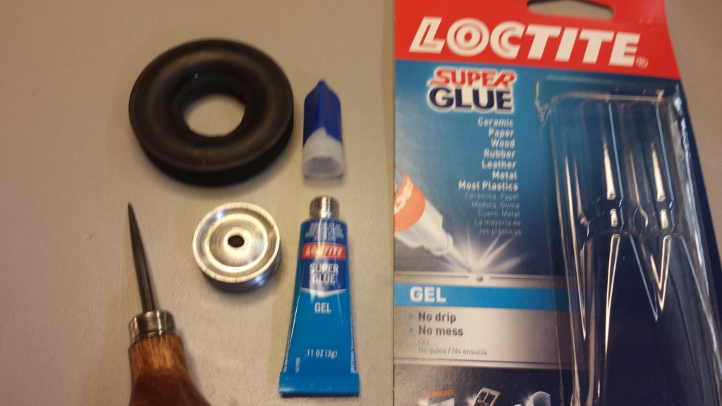

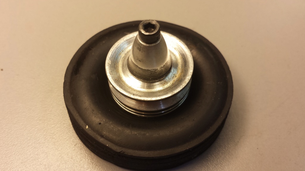

I need to "BOND" this hard-rubber tire to its' aluminum rim.. to be able to withstand the heat from the tire spinning.. prior to hooking-up (1:1) on rough asphalt. This has been the common-failure with this model.
I believe that the tire "expanded" due to the heat of friction.. which broke the bond with the rim.
This tire is TOUGH.. and I'm not hesitant to re-mount it and try to run the car again. The rims' hub-hole is approx. 3/16".. and I thought that I'd need to "bush-it" down to 1/8" for the Coxs' 5-40 prop-screw.. but the Tee Dee-style spinner/hub that I'm using to electric-start the engine "centers-itself" on the outer-contour of the wheel/rim. I haven't witnessed any vibration due to an out-of-balance condition thus-far.. with any of the wheel/tire combinations that I've experimented with.
"Against all Odds" Rodd-E-Liminator vids 7-4-1914
Previously I've been launching the car without a push.. and now realize that a push may help to get the car going faster. I may also lengthen the tether from its' present 12ft. length.

Hey Mark and Alan! Thanks for your advise. I will keep both of your recommendations in mind.
I just re-mounted the tire onto the wheel/rim (had to use a vise to seat-it) but used some cyano-acrylate (super-glue) "gel" in the "V-groove" of the aluminum wheel/rim.. to try to achieve a bond that will hold-up to the heat of friction.

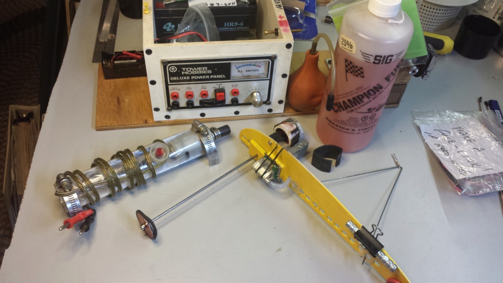

Post  roddie Fri Jul 05, 2019 11:01 am

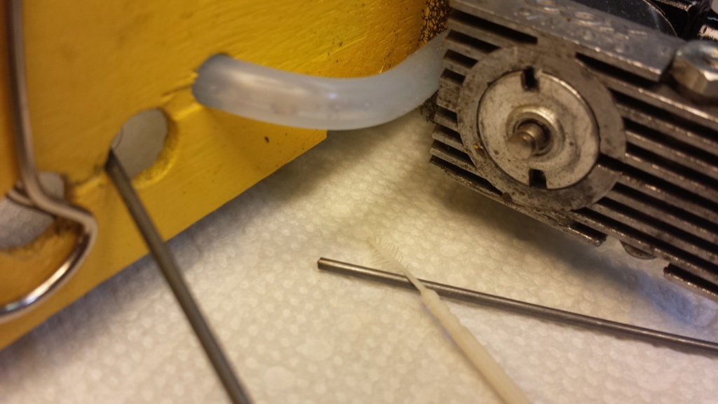

I noticed what looked like a piece of "grit" in the fuel-line of of my tether-car. A dark speck of something.. Huh... What? I was going to ignore it.. but it bugged me to think that I would ignore it.. Rolling Eyes
So.. I dismounted the wedge-tank and removed the fuel-line from its' feed-tube. The small piece of green foam cushioning that I'd placed between the tank and its' mount had disintegrated from raw-fuel exposure. I thought that maybe a piece of that may have gotten into the tank and found its' way into the fuel-line. I removed all of the broken-down foam.. and fed the fuel-line out through the hole in the body.. so that I could straighten it. Removing the line from the engine would have required removing the engine to reinstall the line afterward.. so I used a piece of 1/16" music-wire as a catheter to reach whatever was in that line. I was able to reach and pull the debris back as far as the compression-fitting.. then used a dental floss/pick to snag it out the end. It was indeed "grit" which would have played havoc; had it gotten under the reed.

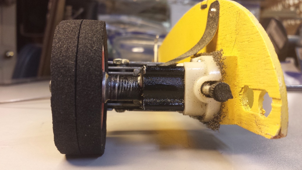

"Against all Odds" Rodd-E-Liminator vids 20190710
"Against all Odds" Rodd-E-Liminator vids 20190711

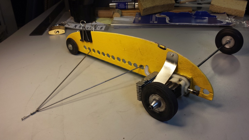

Note that I moved the weight/clamp rearward because of the heavier front-wheels that I swapped-in. I'm hoping that this (along with a push-assist on launch..) might help to get some "traction" without lugging the engine to the point of stalling.
