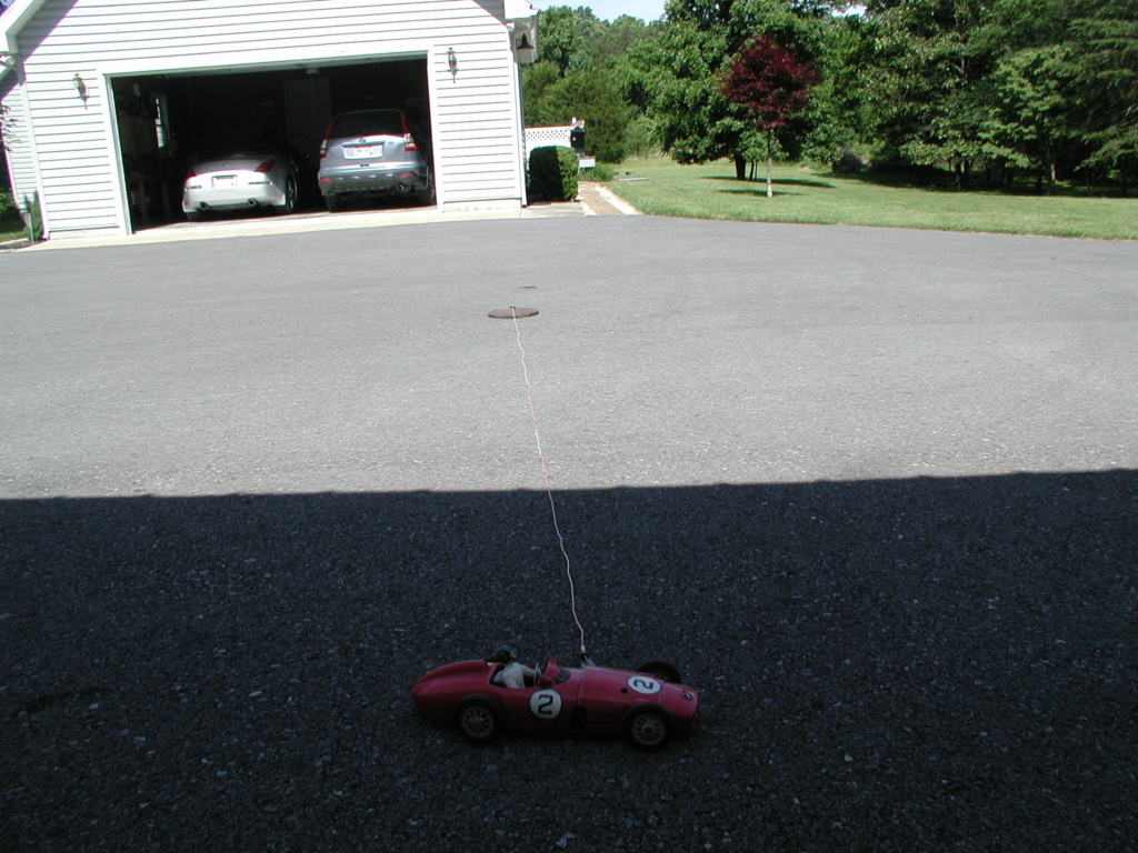

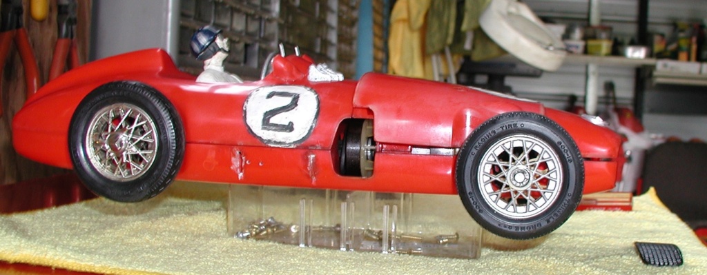

Using roddie as inspiration I re-visited this natural disaster finally installing an engine that would run in it.
The engines cradle is pretty tight, but the slot that the back-plate fits into is pretty much hogged out resulting in a loose vibrating engine.  Not much I can do about that.  Plastic you know.
First run I did not release it properly and it spun out after a quarter of a lap.  Second try started out well, but spun out after half a lap.  Third try got to three quarters.

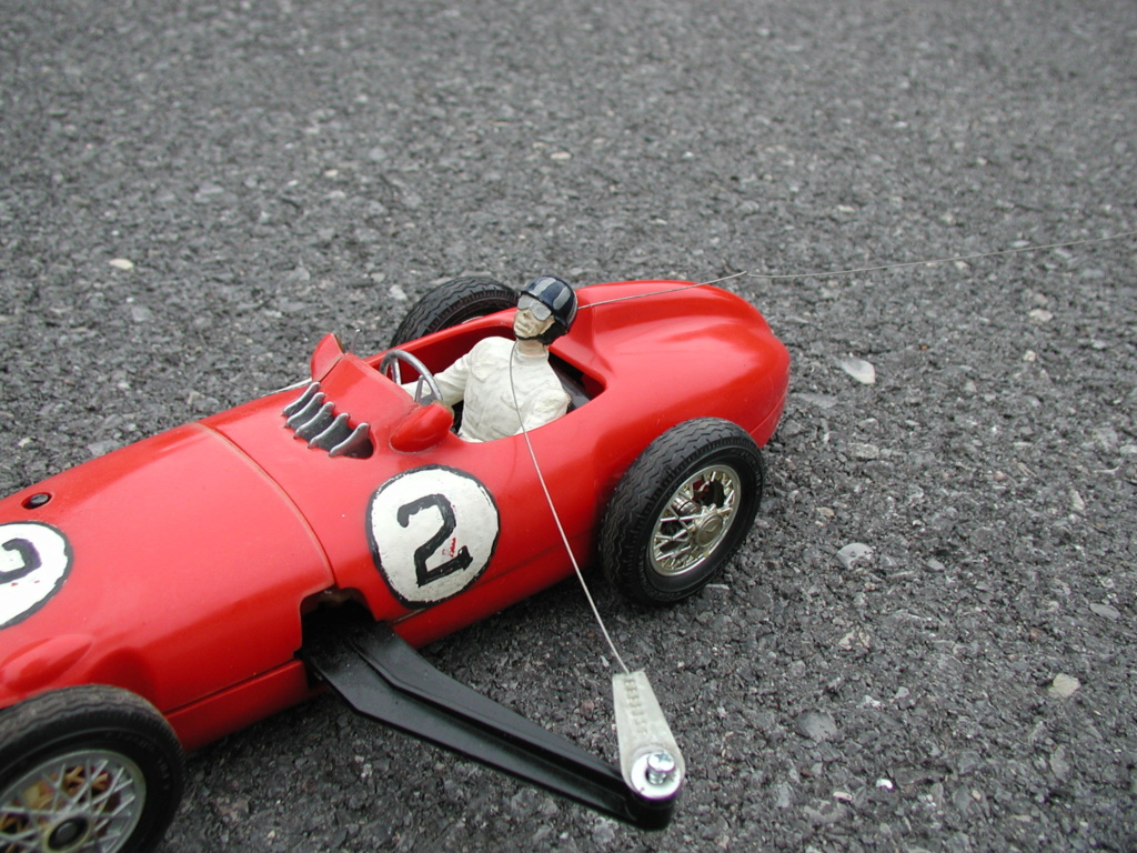

Problem is, I made up a tether line from a broken snapped steel wire originally supplied with these and connected the two pieces with a length of string to make fifteen feet.  The string stretches then snaps back creating havoc with the car.
Got to find some stranded fishing wire and make up a new tether.
I have a movie made in the heat of the moment but it doesn't show much.

Poor guy almost lost his head.

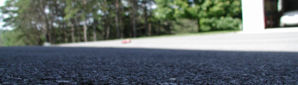

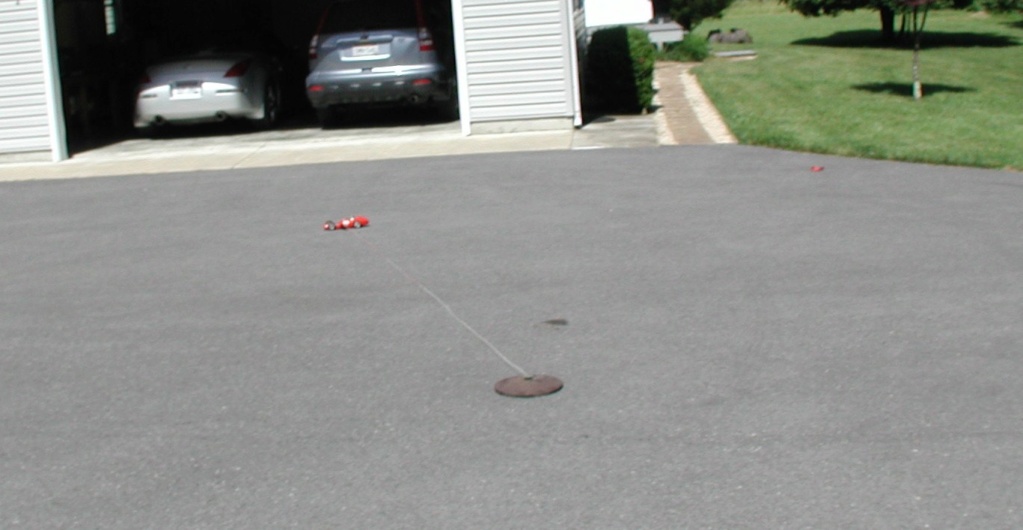

Replaced the string with 22 gauge speaker wire measured to 15 feet and let her rip.
At least 20 circles, probably about 25.  I didn't notice between trying to capture pictures, videos, and jumping up and down.  Ran fast first 15 or so laps, first one coming within an inch or two of my flight box.  Then slowed down to whop speed then sped up again.
Tried to get pictures at ground level.  Got about six showing nothing but asphalt.  Lost it's hood at about lap five I think.
Sorry, it's faster than my camera Smile and the video did not come out at all.

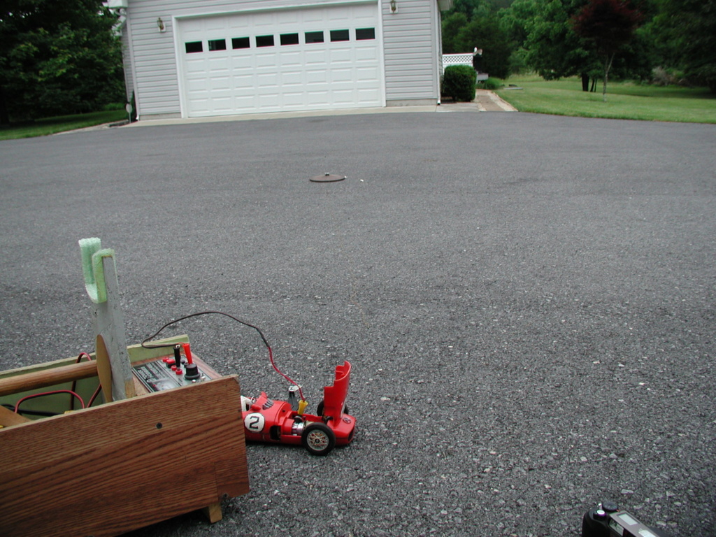

Almost did on the first lap Dave.  Good thing that heavy base held steady.
It left a near perfect 30' circle of used castor on the driveway and an almost equal amount inside the car.  Took an effort to clean it up.
The number 2 Cox Mercedes - It's alive......... Cox_m170
The number 2 Cox Mercedes - It's alive......... Cox_m169
The number 2 Cox Mercedes - It's alive......... Cox_m168
The number 2 Cox Mercedes - It's alive......... Cox_m171

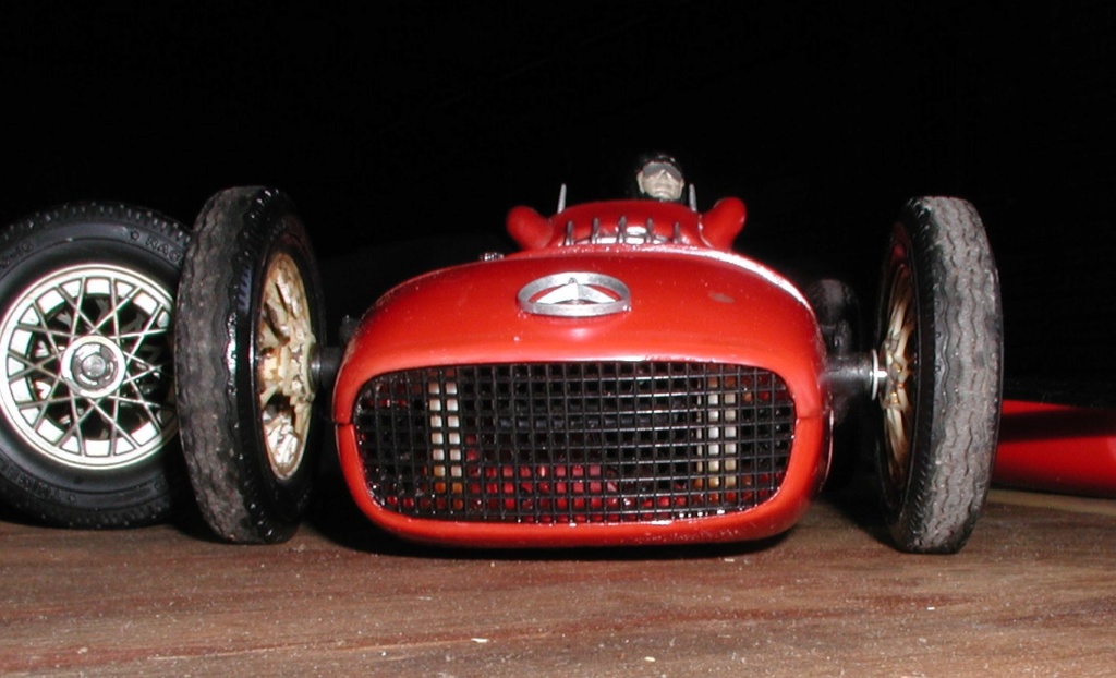

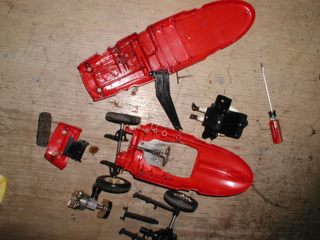

When it lost the hood the suspension lost it's support dropping the car to almost ground level.
The number 2 Cox Mercedes - It's alive......... Cox_m173
The number 2 Cox Mercedes - It's alive......... Cox_m172
Cleaned up well though.  Notice the position and length of the fuel pickup tube.  One reason that it ran so long.  Original engines had the tube positioned at the bottom and cut in half.
The number 2 Cox Mercedes - It's alive......... Cox_m175
Edit add: - Darn, just noticed. When the hood went airborne and hit the asphalt it scratched the PO hand painted #2. Now that bugs me. Smile I think,in my haste I forgot to latch the hood down before I let it go.
Check out all the broken spokes too. Nothing on this car was solid when I got it. Gonna need more epoxy and plastic glue if I'm going to run it again.
The number 2 Cox Mercedes - It's alive......... Cox_m174
Back to the drawing boards.

I can't blame the driver for not wanting to do laps when the wire was trying to strangle him!
