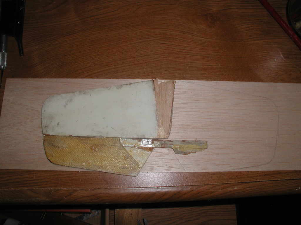

Started tracing on 1/16" balsa, switched to 1/8" on the theory that you can only sand down, not up.
Not sure if I have the rake of the vertical stab right, but it's close enough.  I used the taper of the fuselage at the tail to get the angle.  I simply flipped the two broken elevator and horizontal stab over to get those.

Rudder next, then I have to decide if I want to strip the whole thing down or leave as is.  I like to keep the PO's theme intact if possible, besides it's a whole lot easier...
Vertical stab will sit down a bit after I sand down the broken left over and cut a groove for the replacement.

Looks pretty good too me! I was going to suggest cutting the vert stab down a little, but you are way ahead of me.

I took your suggestion about duplicating the wings tip for the horizontal stab and elevator, turned out I didn't need to. But I did use the same curvature on the tip of the vertical stab keeping things in uniform perspective.
I did the vertical in 1/8" balsa too, but I may use 1/16" instead like the original was.

Now that's sailing right along. If it were a poll, my vote would be on your theme of keeping it original.
