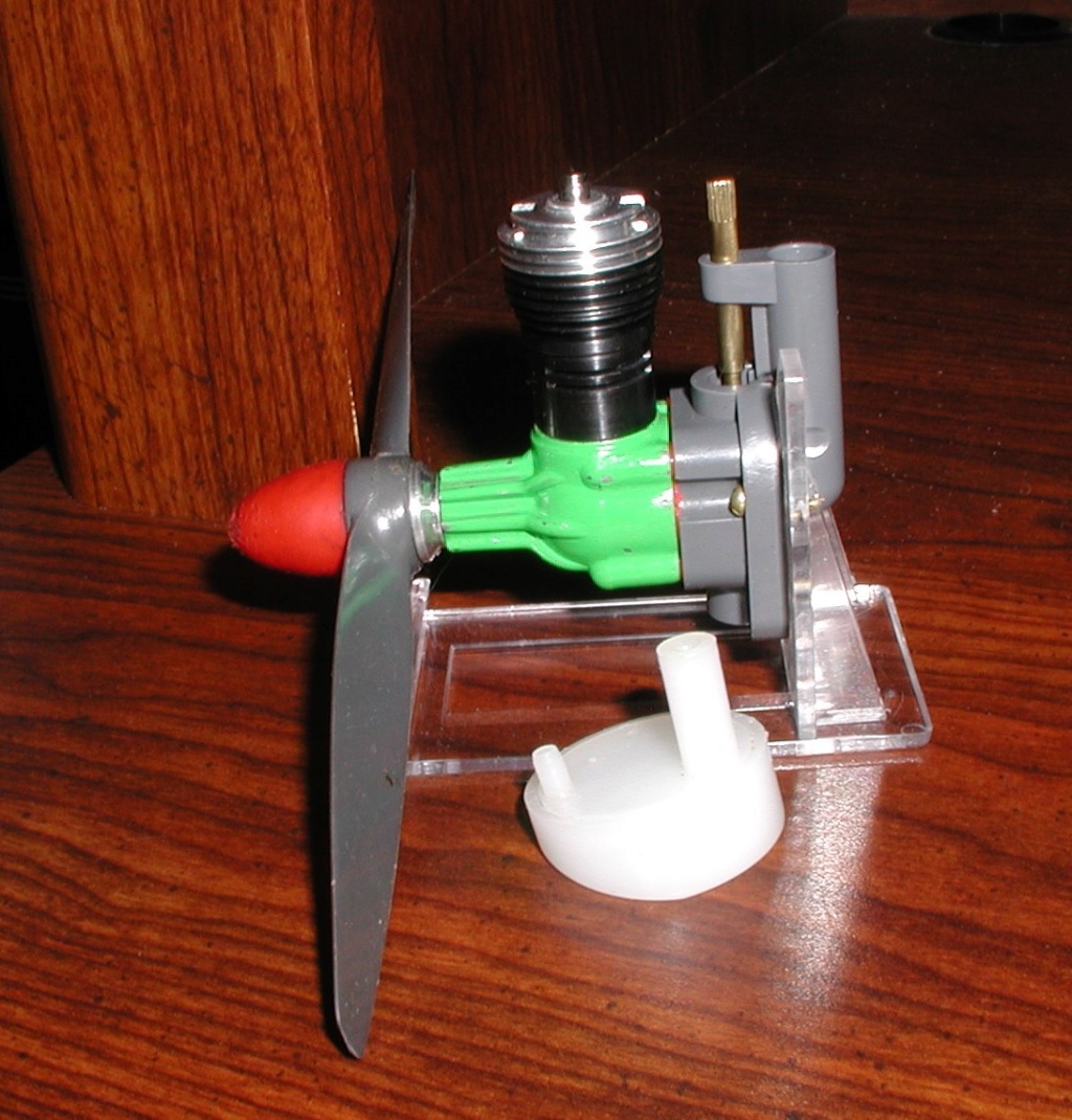

Post  dckrsn Sat Jun 29, 2019 9:08 pm
I'm guessing she came from the factory like that. Considering the volume of engines
produced, this one is a rare/collectors item.  Cool   Drive plate?

Post  rsv1cox Sun Jun 30, 2019 7:02 am
Trying hard to stay with you on this one Bob.
It's missing the choke tube but otherwise it looks normal.  What am I missing?

Post  Ken Cook Sun Jun 30, 2019 7:37 am
The driveplate is not only on backwards, it appears to also knurled on the wrong side.

Post  rsv1cox Sun Jun 30, 2019 12:02 pm
Ken Cook wrote:          The driveplate is not only on backwards, it appears to also knurled on the wrong side.
Yes, I noticed that, but I have seen a lot of other ones configured the same way.  Very strange.
If you look closely the knurled end is pointing the proper way.

Post  RknRusty Sun Jun 30, 2019 12:57 pm
I've had new drive plates with no knurling until after I pressed it onto the crank splines. Maybe this one started out like that.

Post  Admin Sun Jun 30, 2019 2:50 pm
I don't see anything wrong with any of the pictured engines.
It sounds like the listing was for a NIP SureStart and not the one out of package, so you should get a choke tube with it.

Post  Ken Cook Sun Jun 30, 2019 6:06 pm
Rusty, I was making reference to the prop drive knurling and not the shaft. At a closer look, it seems as though the first coil of the prop spring is covering a portion of the driveplate. To me, it appeared as if it was on backwards. Nonetheless, I will say I have had my share of these and one thing I noted was that all of them had the backplate crack.I have new examples still in the bubble wrap that are cracked. The crack starts and goes directly through the needle valve. Funny how I have backplates from 40 years ago and all is still good. Estes offered them at $8 a piece initially. They were then listed at $4 a piece and I figured that to be impossible as the glow head was worth that much. I ordered them and they showed up.

Post  fredvon4 Mon Jul 01, 2019 9:57 am
start is in the bag and not installed....obviously a snap start spring
for those curious cox int has good pics of snap start springs and adapters that work with hex drive plate

Post  KariFS Mon Jul 01, 2019 2:36 pm
By the time of the introduction of the cam starters, the cylinders on Babe Bees, Sure-Starts and Golden Bees were non-numbered with the narrow two-slit exhaust ports, two by-passes and no SPI.
Not sure about the cylinder type on Black Widows, it did have the hex drive plate and the cam start in the end though.
There were two styles of starter cams, a red one with no hex, only a small hole, and the grey one meant to be used with the hex plate.
