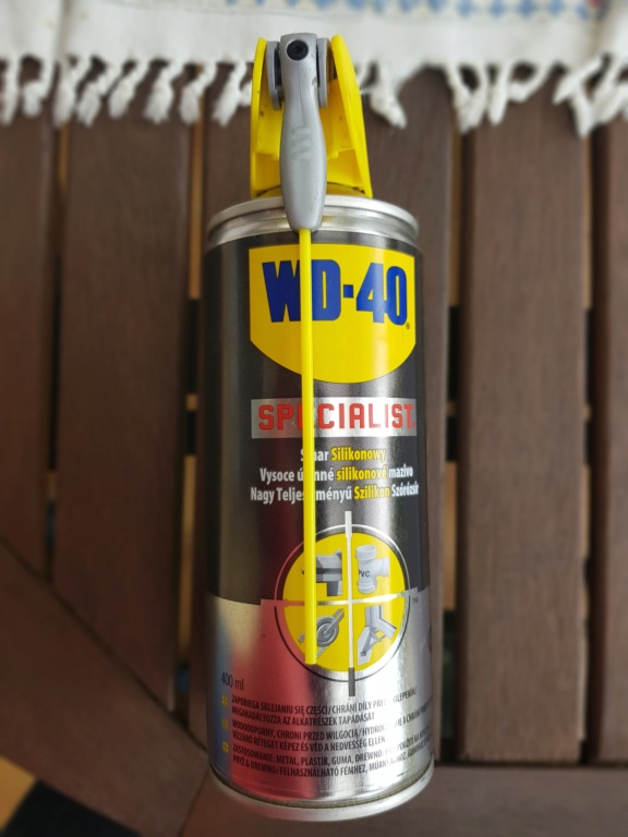

Post  balogh Wed Apr 29, 2020 8:58 am
After I  removed the cylinder, I usually clean its thread at the bottom, and apply some WD-40 grease spray on the threads before I screw the cylinder back on the crankcase..silicone based grease is not expected to cake in the threads as stiff as castor cakes, so removal of the cylinder a few years later should not be a problem..(whether I will be around to unscrew it a few years from now is a different question)  Problem removing 049 cylinder 20200413
