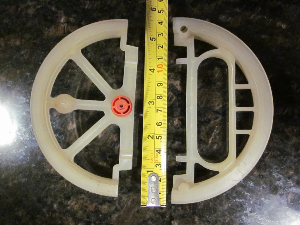

Post  aspeed Thu Jul 18, 2019 9:36 am
I like this one, never seen another. Shimitzu Mokei name makes me think Japan. Very well engineered. Two pieces snap together and the detachable piece has the knobs. There are two slots so the lines are separate and the pins screw in. There is even a radius molded in so they don't kink. 5 1/2" OD with a 5" spacing and no adjustment. It's 3/4" thick. Seems like nylon. I have a couple other reels like the Ureely and the Cox one for dacron lines but this one is the Cadillac (Lexus) CEF C/L Handle, Can it become a reality???? Handle17
CEF C/L Handle, Can it become a reality???? Handle15
CEF C/L Handle, Can it become a reality???? Handle16

Post  aspeed Thu Jul 18, 2019 9:40 am
I think this would be a good one to copy, or buy if they are still made. CEF C/L Handle, Can it become a reality???? Handle19
CEF C/L Handle, Can it become a reality???? Handle18
