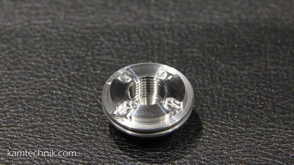

Put a turbo plug adapter on the engine instant boost in power.
OS RP7 plug.
https://kamtechnik.com/product/ktk-11/
OS RP7 plug.

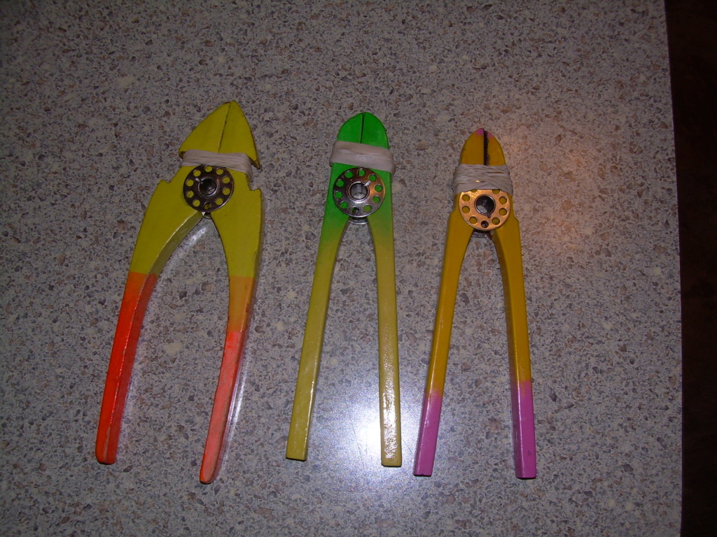

Dave, the fine needle valve is a must. These can be sourced from product backplates and can be adapted to the carb body. However, you can forego the needle valve on the carb body eliminating the cross through spray bar and use the needle assembly remotely. I started out with hemostats which is too cumbersome and dangerous. They weigh too much, they can get caught in the prop if you slip and they just don't offer easy ability to do several things. The real problem is they lock and you don't want that. It works great when holding back the pressure but after that one can struggle. I start most of my bladder equipped planes between my knees. Pretty much one flip starts and off into the air. I make lightweight pinchers from bass using a sewing bobbin in the middle. These are 4" long and light.
I paint them with high vis colors in case I drop them.
- Posts : 5313
Re: Hopping Up a Stock Medallion .049
I remember reading in an old magazine about using an electrical toggle switch to pinch the tubing and then just flicking it over when it runs off the prime. I could never visualise actually fabricating it. I have 9 F2D planes that I want to use more often. I only fly a couple when there is someone useful at the one distant field and they are really my favourite planes, even more so than rc stuff. The Fora is great, but even the slower .15s are good for an old fart like me.
