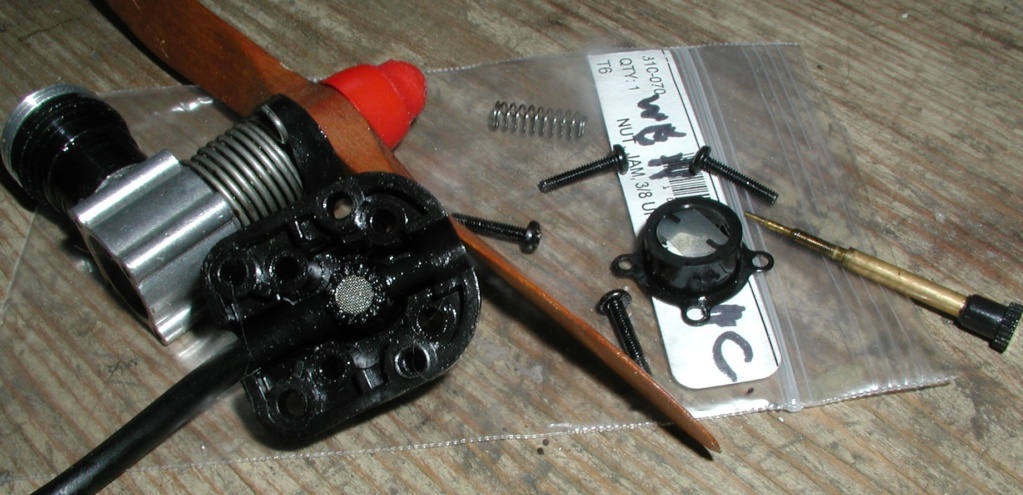

Basic problem is runs off the prime and quits. No fuel draw as observed through the tubing.
Thought maybe the fuel supply arraignment was at fault, or bad fuel.
Tried another Testors McCoy just received with the gruesome twosome and...……

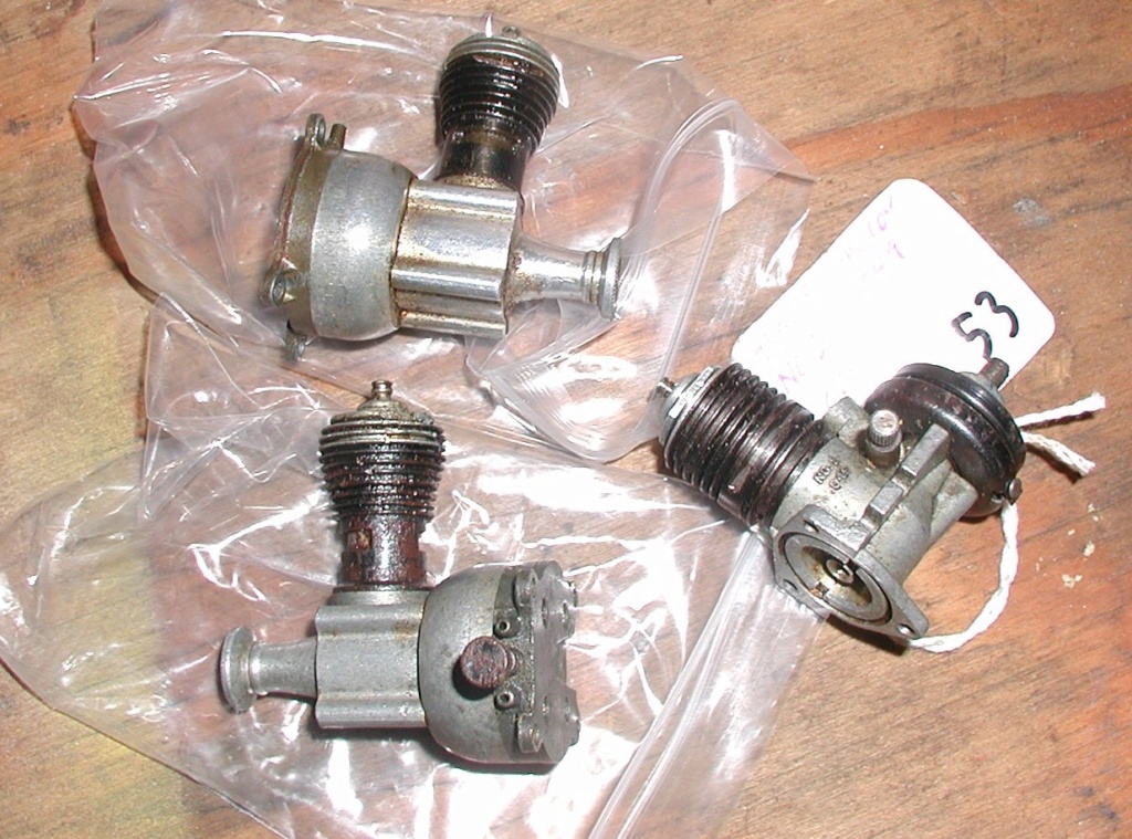

The gruesome twosome posted about here previously and friend.
The troublesome Corsair engine, the gruesome twosome, another Hero Testors McCoy .049 and the yellow prop returns.   P7170011

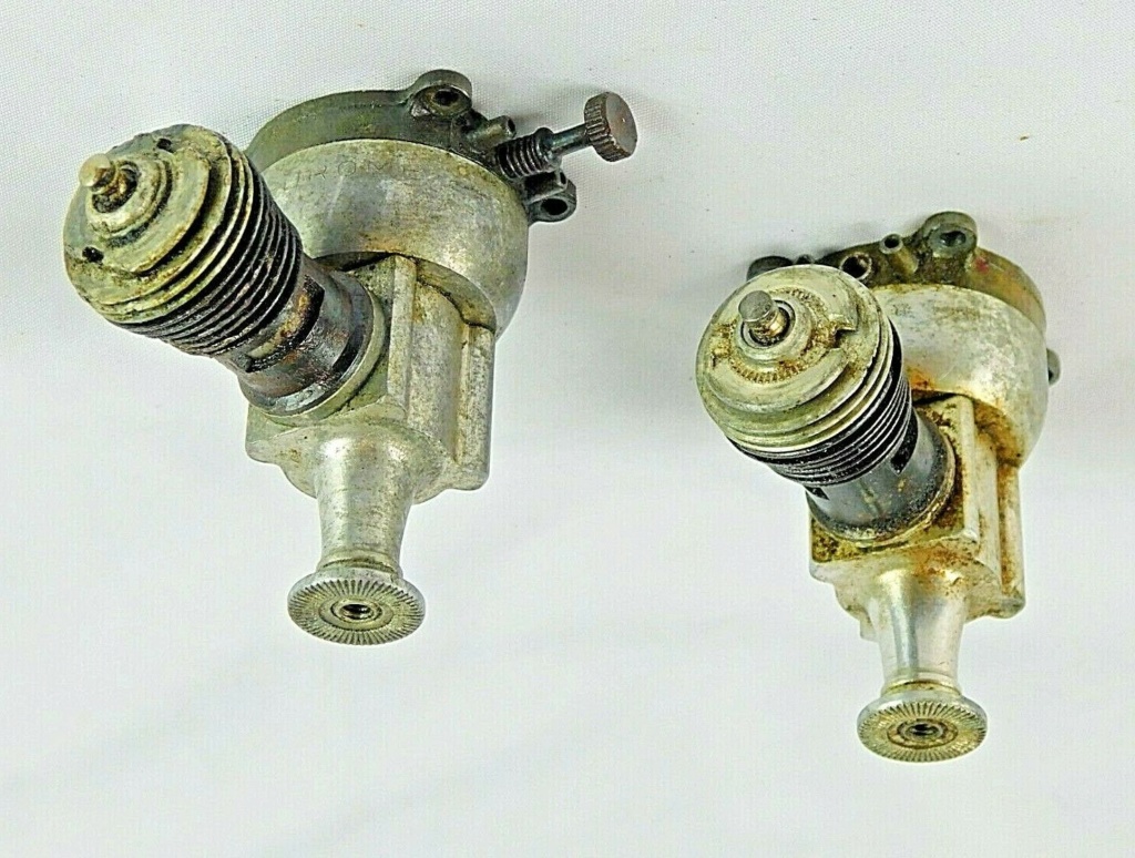

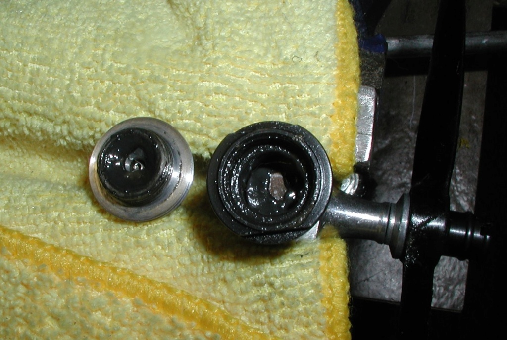

They were not as bad as the seller had pictured, but both locked up so they got an A/F boil.  Still locked up.  First time I have seen this.  Neither would move the piston.  Heroic measures, profanity and burned hands finally got both to rock....slightly.  More dipping into boiling A/F freed both but with considerable effort.  Wow, new to me.
Rusty external cylinders got cleaned with the wire wheel and reblued which also coats the bore.  A little Remoil and turning of the crank reveled out of round cylinders as evidenced by the bluing being scrubbed off and deposited on the top of the pistons.

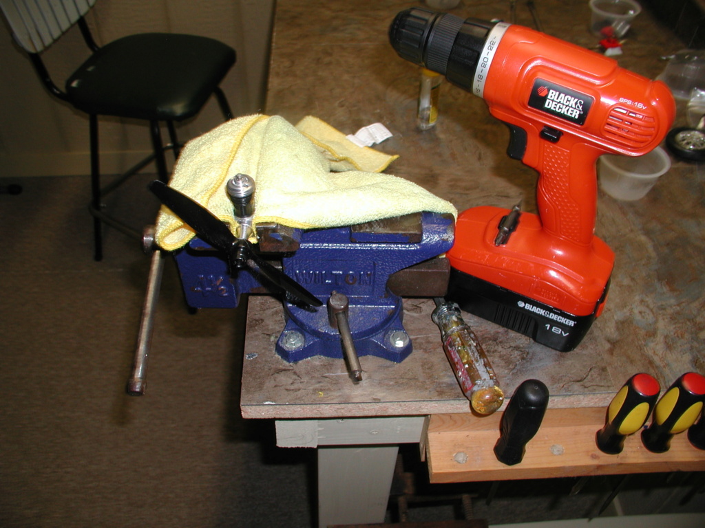

Got out some JB bore paste and coated the cylinders and flipped the prop for ten minutes or so with little progress, still very stiff movement.  Got out the drill and recoated the bores.  Ran it for about 30 seconds which resulted in a nice smooth operation.  Cleaned everything up and reassembled with new gaskets.  Got a compression pop that any Cox engine guy would appreciate.

Two different back ends.  Different reeds tried.
The case gasket is in question.  I have tried it with and without that gasket, but I believe it is for the cast case. Will replace it with a standard Cox gasket and see what happens.

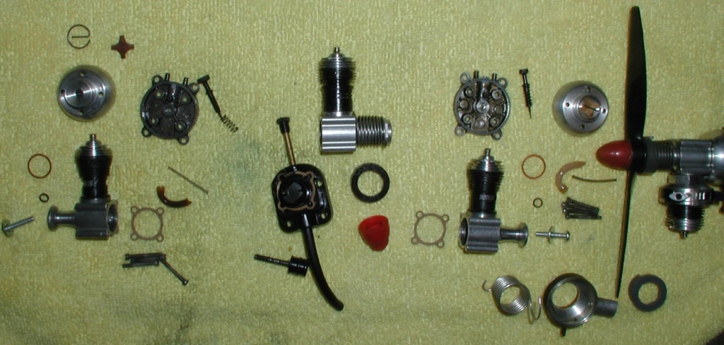

Post  rsv1cox Sat Jul 20, 2019 8:08 pm
I guess some time ago after years of frustration with this engine I tried that gasket maybe just to see what would happen.  Made no difference and must have just left it.
But this engines troubles go well before that as it never ran anyway even when on the airplane.

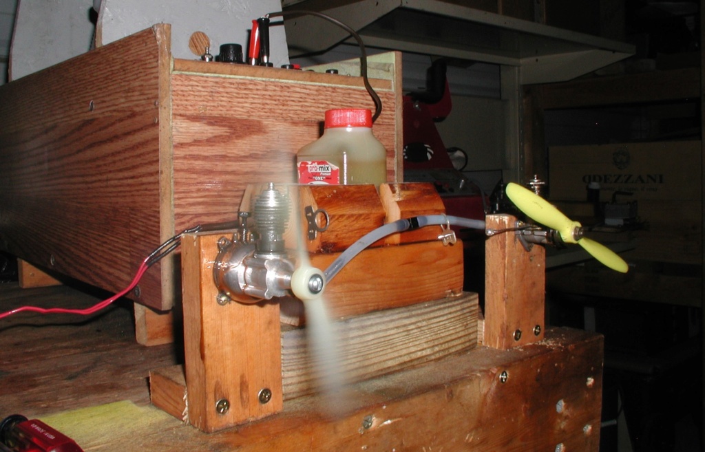

I replaced that gasket and headed for the garage.  A comfortable 93 degrees now, turned into a sweat ball in about five minutes.
To check out the fuel supply I mounted the engine on the other side from the one I had used previously.
Same thing.  No fuel draw, runs poorly off the prime.  Engine has been cleaned many times my standard way and the NVA blown out with compressed air.  Needle is fine.  Can't finger the venturi when mounted.

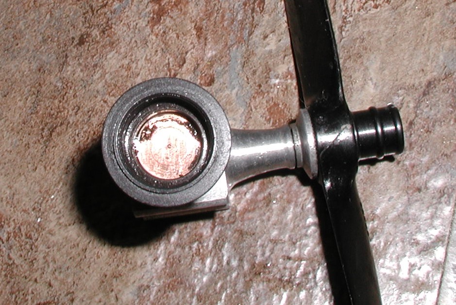

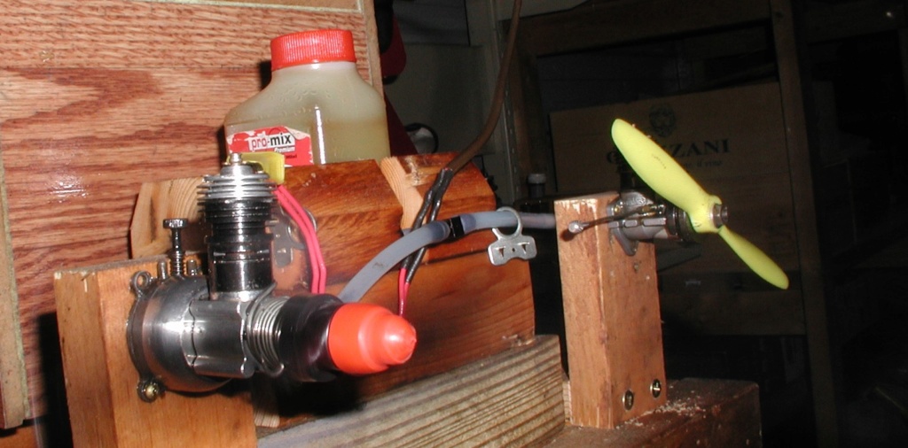

Bummed....again, I mounted one of the just cleaned gruesome's.  The one with the #6 cylinder, filled the tank primed and flipped.  Started backwards.  Ran in the house to get the camera..."without pictures it didn't happen!"
As bought:
The troublesome Corsair engine, the gruesome twosome, another Hero Testors McCoy .049 and the yellow prop returns.   Grusom10
The troublesome Corsair engine, the gruesome twosome, another Hero Testors McCoy .049 and the yellow prop returns.   Grusom11
The other cylinder is marked PL.
Flipped again, started running in the correct direction.  Adjusted the NV...a screamer.  Ran out the tank.
The troublesome Corsair engine, the gruesome twosome, another Hero Testors McCoy .049 and the yellow prop returns.   P7200010
The troublesome Corsair engine, the gruesome twosome, another Hero Testors McCoy .049 and the yellow prop returns.   P7200012
The troublesome Corsair engine, the gruesome twosome, another Hero Testors McCoy .049 and the yellow prop returns.   P7200011
Tomorrow I will replace the horse shoe with the gruesome's tank and see what happens.  Other option is to replace the horse shoe with one from a known good runner.  If neither works, it get's hammered or off to the mailbox.

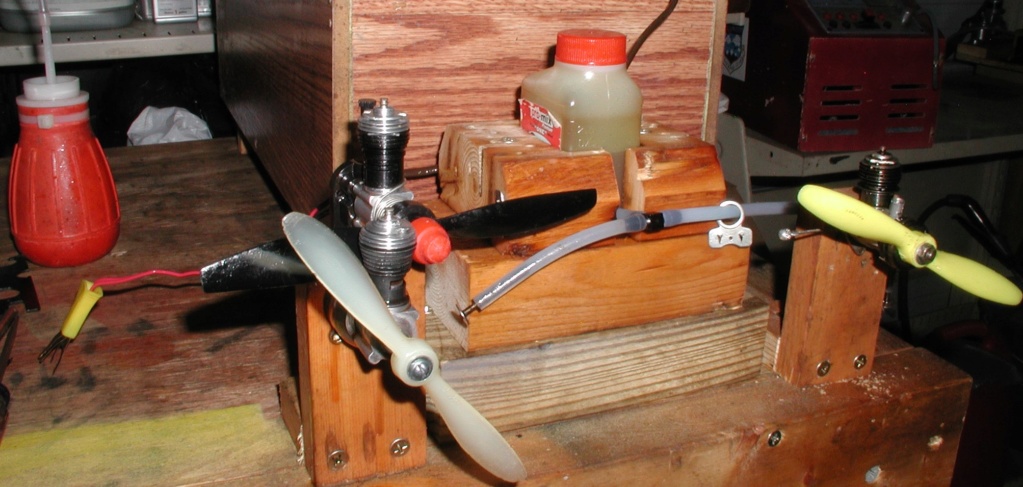

Post  rsv1cox Sun Jul 21, 2019 9:05 am

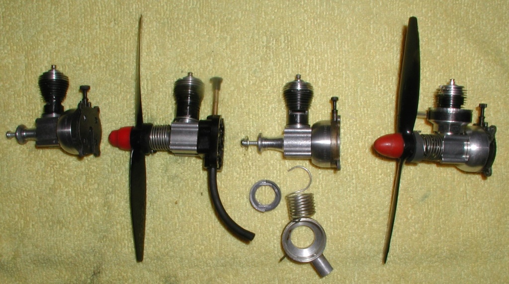

Well, the problem is in the back end.
Swapped the back end with the tanked engine and ran it twice. It started and ran fine although both times it started backwards. I thought the cammed spring starter prevented that!!!
If I thought the standard spring starter was bad, the one with the cam is a nightmare.  I'm used to finger flipping and that springed starter caught me once so I started using a chicken stick.  Once bitten...…..
So, I removed the BB's tank and swapped the gasket around on the Corsairs engine so it was next to the horse-shoe and tried it again.  Same result, no fuel draw and runs off prime.
I have tried mylar, steel, and clear reeds but some how feel the problem is in that area.  As I mentioned, this engine has been a problem since I got it many years ago.  Maybe the plastic surrounding the reed is malformed.
This engine came out of the Corsair with the white propeller.  Runs fine now along with the other Corsair, to bad they fly so poorly.

Runs great with the back end from the other engine.
The troublesome Corsair engine, the gruesome twosome, another Hero Testors McCoy .049 and the yellow prop returns.   P1010100
The troublesome Corsair engine, the gruesome twosome, another Hero Testors McCoy .049 and the yellow prop returns.   P1010098
Everything back to original.  Only this is not the QZ engine with the #6 cylinder, it's the one marked P-something.  Maybe P40 as rod said.  My eyes are not what they used to be.

I haven't given up. Isolated to the backplate, now to investigate that. But it could be the fuel supply setup. Testors engines run fine on it though and I rotated the postage stamps backplate 90 degrees to get the supply even with the intake and fuel tank to no joy.
Thanks for the offer, but I'm pretty well set on backplates.
