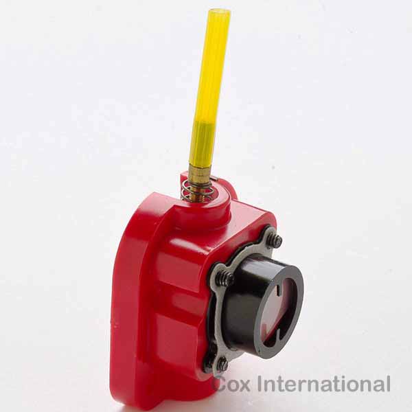

rex f. wrote: The backplate gasket when using non tanked style MUST have the gasket
Installed berween the backplate & the reed retainer as the delrin retainer is self sealing against
The crankcase thereby providing the extra clearance preventing reed jammiig
Rex f.
Hi Rex, This illustration and photo below would suggest the opposite..
Bob V’s troubled engine. Cap-fl10
Bob V’s troubled engine. Killer11
I've been installing my case-gaskets directly against the crankcase and don't seem to have any issues. If the "retainer-flange" is directly against the crankcase.. there's a possibility of the crank-pin contacting (binding-against) the front of the retainer.. especially if the rear of the case has been decked.
