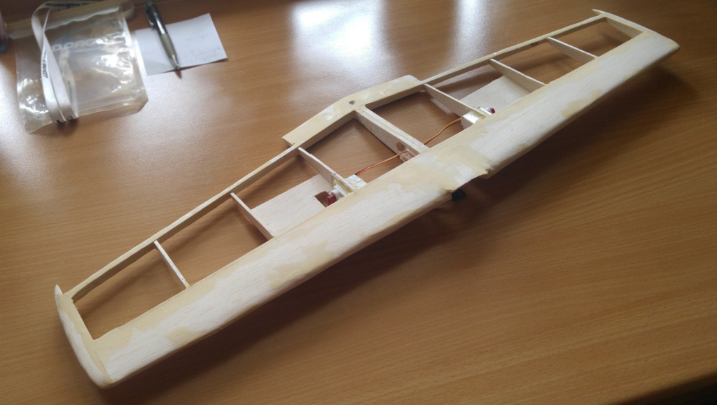

Hi, I would like to show you my current project. It's a bit inspired by the SkyDrill. Model is designed by me  Wink and it will be powered by an engine COX Ranger .049  Small Cox Logo  .
It is low wing model with a wingspan of about 600mm (23.62in). Wing profile is NACA2412 at root and NACA2410 at tip.
The model is mainly made of balsa, the engine fairning is made of laminate. Canopy is from PET bottle. I painted some elements with Tamiya paints and secured with two-component automotive lacquer (it's my first use the car lacquer with airbrush).
Unluckily when I covering wing with a covering film something went wrong  Sad  and I had to tear off the wing sheathing. I am currently waiting for a new foil, I hope it will come next week.
All photos from the building can be viewed here: https://photos.app.goo.gl/fTFMMDS2pcsqhqVCA

CzarDrill - my first model for Cox 20190813
CzarDrill - my first model for Cox 20190814
CzarDrill - my first model for Cox 20190910

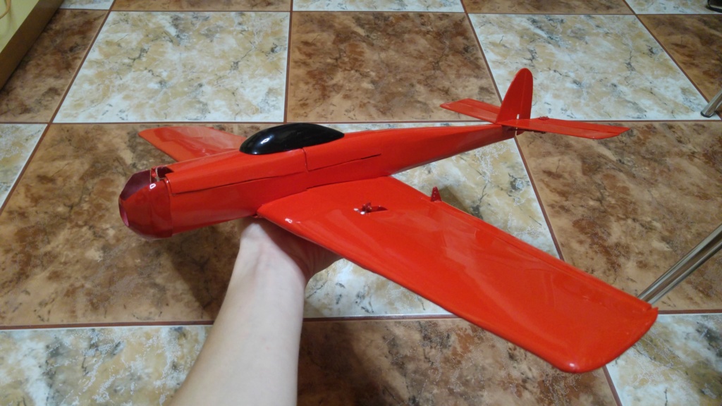

Finally a covering film came to me, and I can take care of the cover.
This foil (Oracover Standard) is realy better than Oracover Easycoat. So far I covered a wing with no problems Very Happy
CzarDrill - my first model for Cox 20190911
CzarDrill - my first model for Cox 20190912

Fuselage also covered, but now I have a dilemma whether to leave the model in red or to add a yellow strip like the one in the second photo Huh...
CzarDrill - my first model for Cox 20190914
CzarDrill - my first model for Cox 20190913

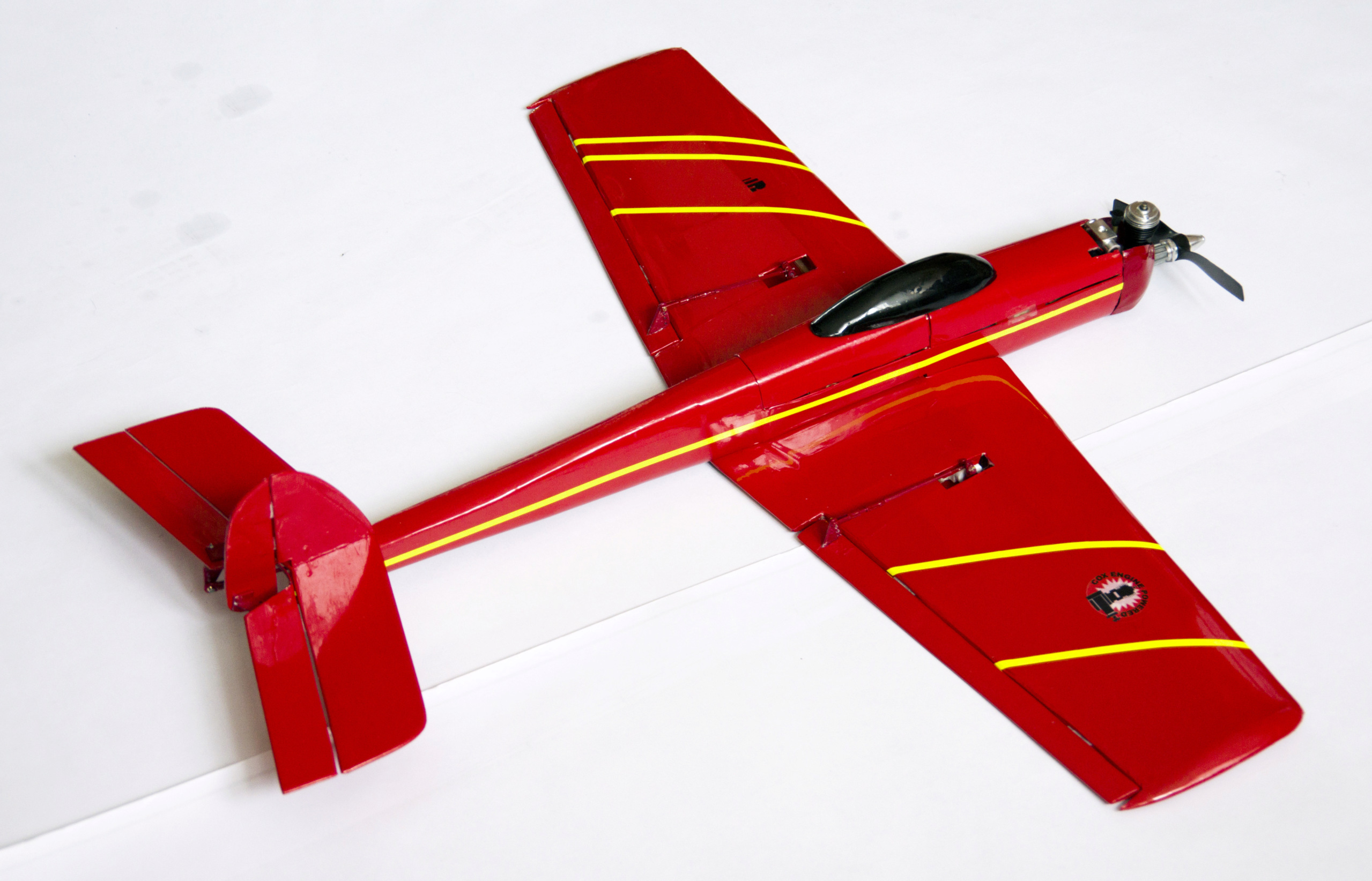

The model is almost finished. It's left to mount servos, engine, tank and pushers. And add some decorations Razz.
Unfortunately, the weight of the model with the equipment is 310 grams (10.93 oz.).  Plus receiver (I waiting to 3 grams receiver from China, now I have only 17 grams receiver) and plus fuel ~30g (1 oz). Which gives a total of 350 grams (12.34 oz) and a wing loading of 41 g/dm2 (~13.1 oz. / sq. ft.).
But apart from that I'm very satisfied with making a model of my own project  Very Happy
CzarDrill - my first model for Cox 20190917
CzarDrill - my first model for Cox 20190916
CzarDrill - my first model for Cox 20190915

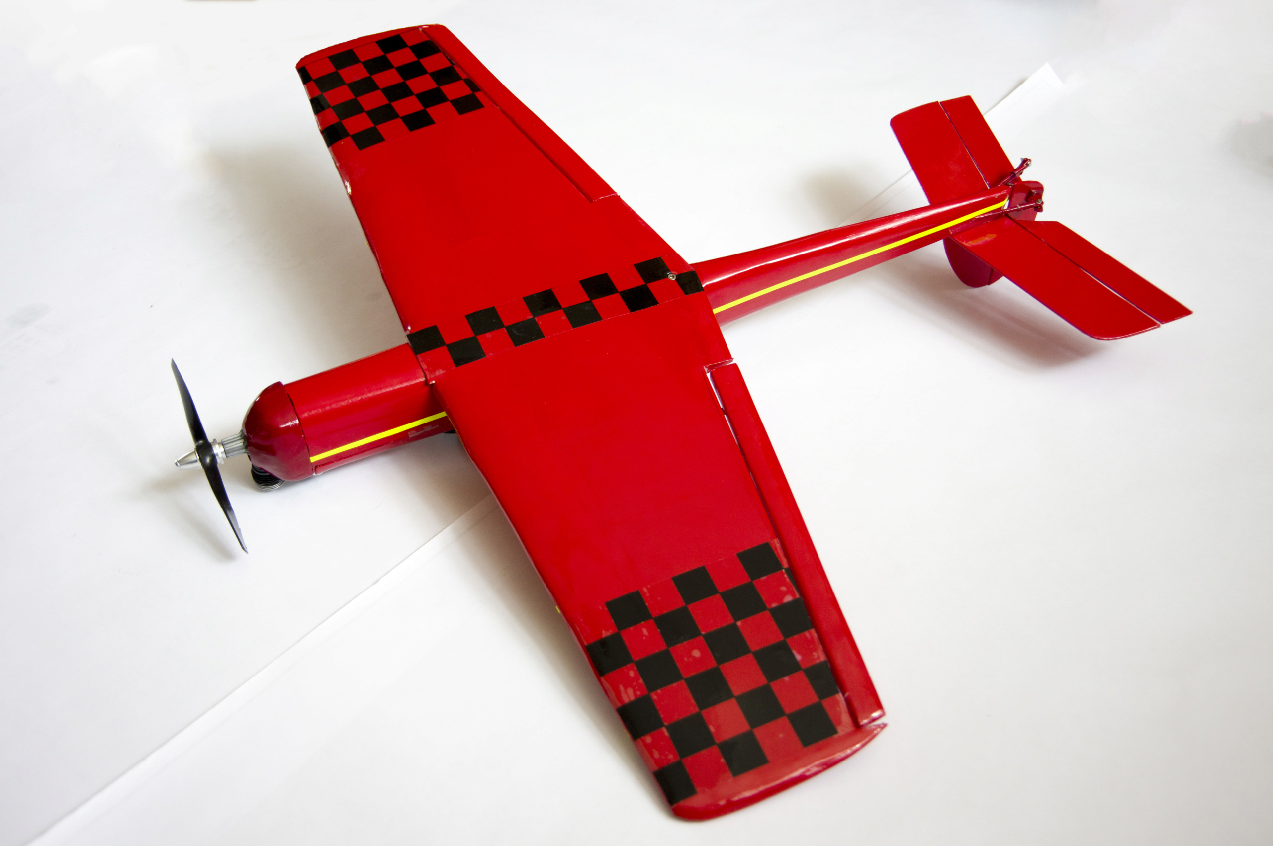

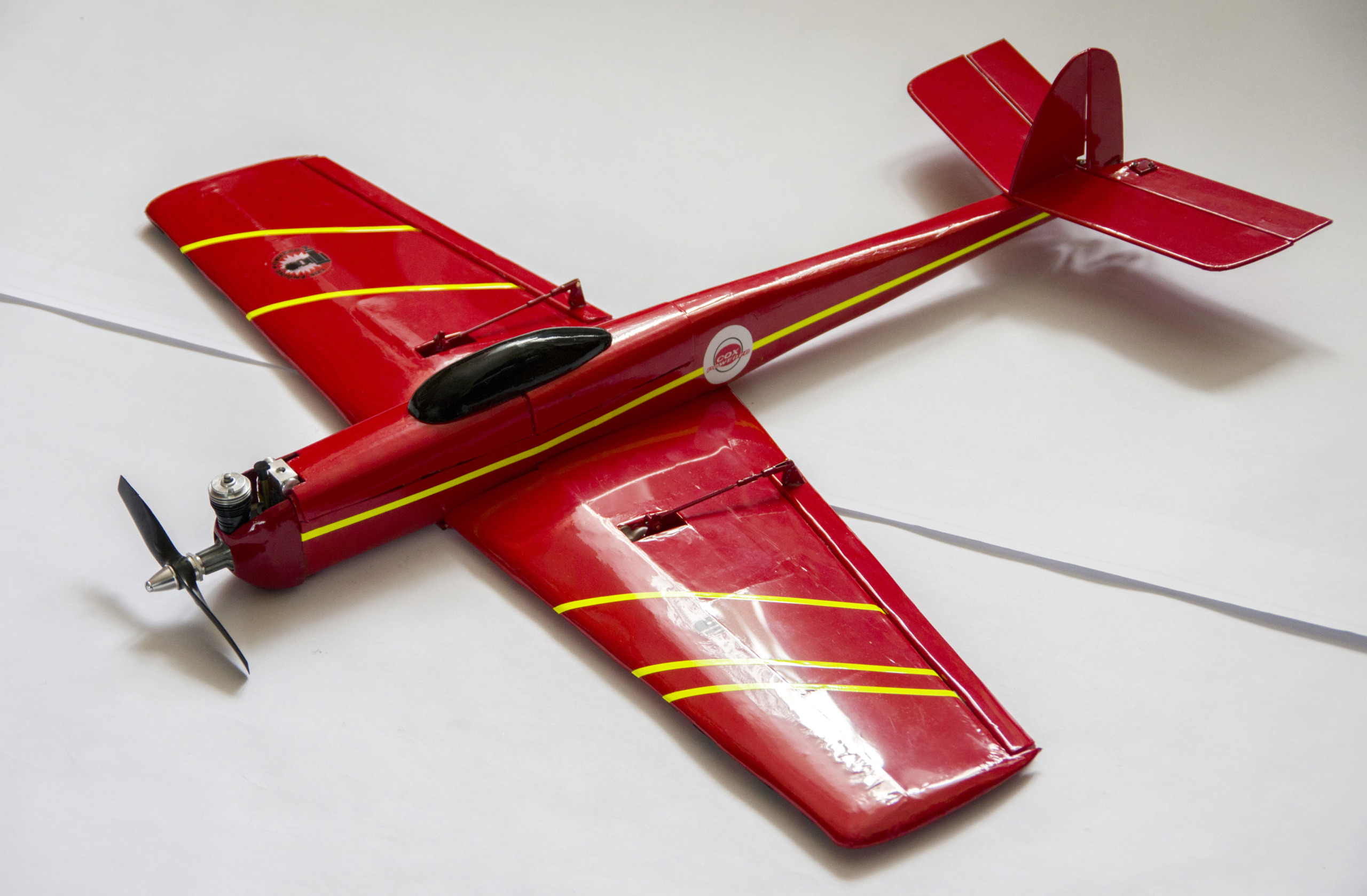

Post  czarobest Mon Sep 16, 2019 10:31 am
All is mounted, screwed and configured in my radio. Unluckily I can't fit my receiver and I must have to wait to smaller one from Banggood. When it will come I'm gonna shorten the wires (from servos and BEC)
Cool things - balancing without additional ballast was almost perfect with an empty tank, with a full tank it only goes a little too far forward.
Worse things - weight Razz. Without fuel is 335 grams, with fuel ready to fly is 360 grams.
Besides the weight I am very satisfied (so far, after the flight it can be different Razz), I like it, and everything is quite well for the first own "project" I think certainly I learned something and maybe the next ones will be better Smile.
Photos of the ready to fly model Smile.
CzarDrill - my first model for Cox Czardr12
CzarDrill - my first model for Cox Post-18299-0-42424100-1568646340
CzarDrill - my first model for Cox Post-18299-0-58988800-1568646451
CzarDrill - my first model for Cox Czardr10
CzarDrill - my first model for Cox Post-18299-0-68929100-1568647237
CzarDrill - my first model for Cox Post-18299-0-13550500-1568647251
CzarDrill - my first model for Cox Post-18299-0-07301000-1568647267
CzarDrill - my first model for Cox Post-18299-0-00229300-1568647296
CzarDrill - my first model for Cox Czardr11
CzarDrill - my first model for Cox Post-18299-0-00593900-1568647309
All the previous photos from the building is in the album: https://photos.app.goo.gl/fTFMMDS2pcsqhqVCA
