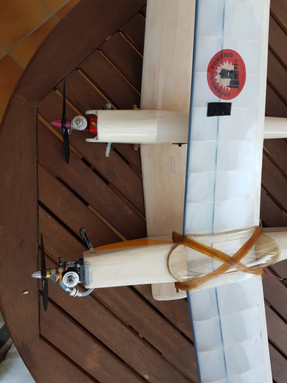

Here it is. Nothing unusual. Yes I know bladders run better but I hate them. I wanted to know members'
experience with Norvel tanks as mine is not too good.

My Norvel tank was foaming like crazy too, and quits easily so it needs to be rich. It works if you don't waste time on the ground. Leans out a bit at the end like most other hard tanks. I used the .051 which is an unbalanced engine and I keep the revs up which doesn't help matters, I will go to an .049 at some point. I like the fact that it is the same bolt pattern as the Bees. I mounted mine with 2-56 bolts so it is not from being mounted solid enough. The Cox tanks are OK but any little crash and they break.They also won't be much good for stunts. I am wondering out loud here what is a good glue to seal up the Norvel tanks. The glue would have to creep into the gap where the tubes go, and the backplate disc would likely break if it is removed. Pretty sure CA is not fuelproof. The balloon tank sounds good. It is a limp balloon, not pressurised. It needs a container or housing on a profile plane or a big opening. You picture never showed up so I can't see your situation.

Post  CLwhipper Tue Sep 17, 2019 1:28 pm

First thing I would do is unplug the top vent.  There is no way for air to get in unless it is different than mine.  My vent faces forward.  I would also flip the needle valve with the ratchet so it is back farther.  It won't be so easy to trim your fingernails.  It will likely still foam though. I am not sure, but maybe you could twist the pickup tube so the rear of it ends up in the centre. It could probably be a new source of leaks though.
