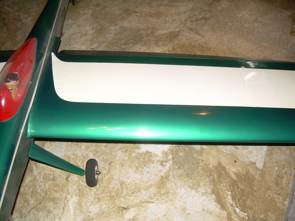

SIG Koverall is terrific stuff! I have a Sterling Super Ringmaster, which I Kovered with it, and it is still as tight and strong as the day I applied it! However, I did use butyrate dope throughout it's application: no problems. I painted white butyrate dope for it's base color, and Krylon spray paint for the trim colors - the FOX .35 STUNT engine does not require more than 10% nitro; therefore, the Krylon is not affected by the fuel. Good luck with your Ringmaster, and join Brotherhood of the Ring, for more people devoted to the Airplane.
This is the one, and I built it in the summer of 2013

Gus, I'm starting to see a pattern to your preferred color palette.
Sweet looking model!

Good looking ring Gus , she has got a little burpule in it , i like it

That is one high end fly ride! Smooooooth!!

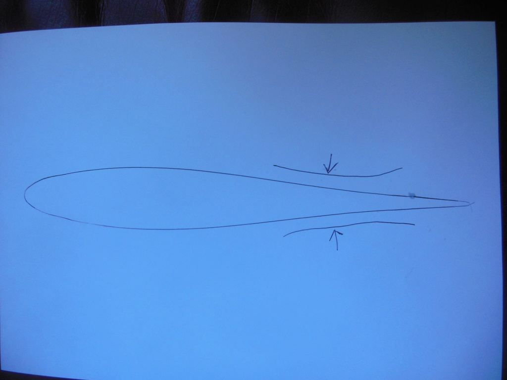

I have noticed though that the ribs on this have a slight undercamber as they approach the trailing edge. So far, it has been my experience that covering will shrink along the shortest possible path. How do you stop it bridging the undercamber?

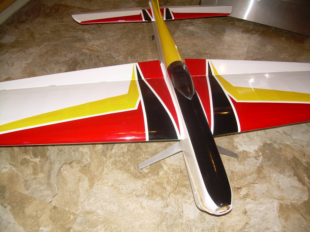

Here's my latest, covered in Koverall with nitrate base and water based polyurethane color coats. The color and clear coats were all painted with a 2" spongebrush.

More neat planes Ken. I won't need a fuel proof finish on this one but the fuel proofer I use is a very slow drier. 2 to 3 hours before handling and then stays slightly tacky for up to a week.
Here is the undercamber I am referring to.

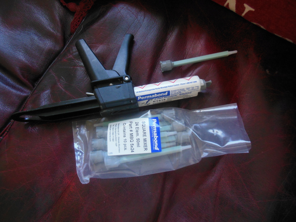

As an aside, I have had many problems with the newer formulations of epoxy glues. I have concluded that the faster set glues aren't as strong as the slower set. The slower set need clamping and at least 8 hours before handling. The faster set are a bit hit and miss and some of them are difficult to mix correctly leaving less time to apply them. In warm weather - they have set while I was stirring them. I also find that I mix too much - mixing too little can be a disaster.
I now use this stuff
Cartridge inserted in the gun and mixing tube attached. The glue can then be applied directly and spread. !0 minutes working time and parts ready to handle in twenty minutes. 24 hours for full cure. Easy to apply to multiple parts and only a few seconds to replace the cartridge. Tube discarded after use. Little material is wasted in the mixing tube. Not cheap though - especially for small applications and the tube being discarded.

That undercamber is called “pollywog” which is slang for a tadpole. Not sure what term you guys use, at any rate that is what the ribs are supposed to look like on the Ringmaster.

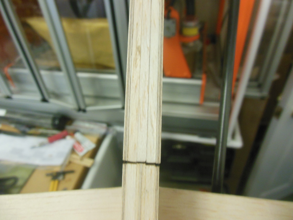

While I may have mentioned it before - I am not a fan of the slabby profile fuselages but they do provide a quick build. I am not familiar with Sterling kits but I have and have seen many examples of poorly produced kits. I have a Sig Skyray kit that is unbuildable - the spars aren't of uniform size, the ribs are cupped and the fuselage is bent and twisted, Apatrt from that it is OK. I have Keil Kraft kits where the balsa is rock hard but the newer laser cut kits I have all seem to be much better quality,
Nevertheless, I would be reluctant to rely on say a single piece of 1/2" balsa even with ply reinforcment up front. A dense piec of wood is more likely to stay straight but not guaranteed.
I have found that it is better to laminate the fuselage with a minum of two 1/4" sheets eopxied together and weighted flat overnight. Even go as far as carbon veil between the two or 1/64 ply. I use epoxy as I find aliphatic resin and PVA glues cause curling - although this can be flattened out while drying - it gets a little bit fiddly.
This fuselage is a 5 ply laminate - 3 1/8" balsa inner and two 1/16" ply outer.
It is an RSM take apart kit which is why it doesn't have the opening to poke the wing through.
This does make the build easier for getting a good wing to fusealge fit and there is no reason to leave it take apart. It can be permanently glued.
In fact, it would be difficult to seal from fuel and exhaust ingress as it stands,
There is one major detail that needs very careful attention. The centre rib on the wing is also the tongue that slides into the fuselage either side of which has a 1/8" balsa rib to support the centre sheeting. These ribs must be perfectly aligned at 90deg to the leading edge and perfectly verticle or the wing won't level out on assembly.
The tailplane is also laminated - two 1/16" sheet balsa. This also proved ideal for fitting tape hinge along the whole length of the tailplane.
Good balsa is difficult to find but lamination ups the odds of a straight build.
