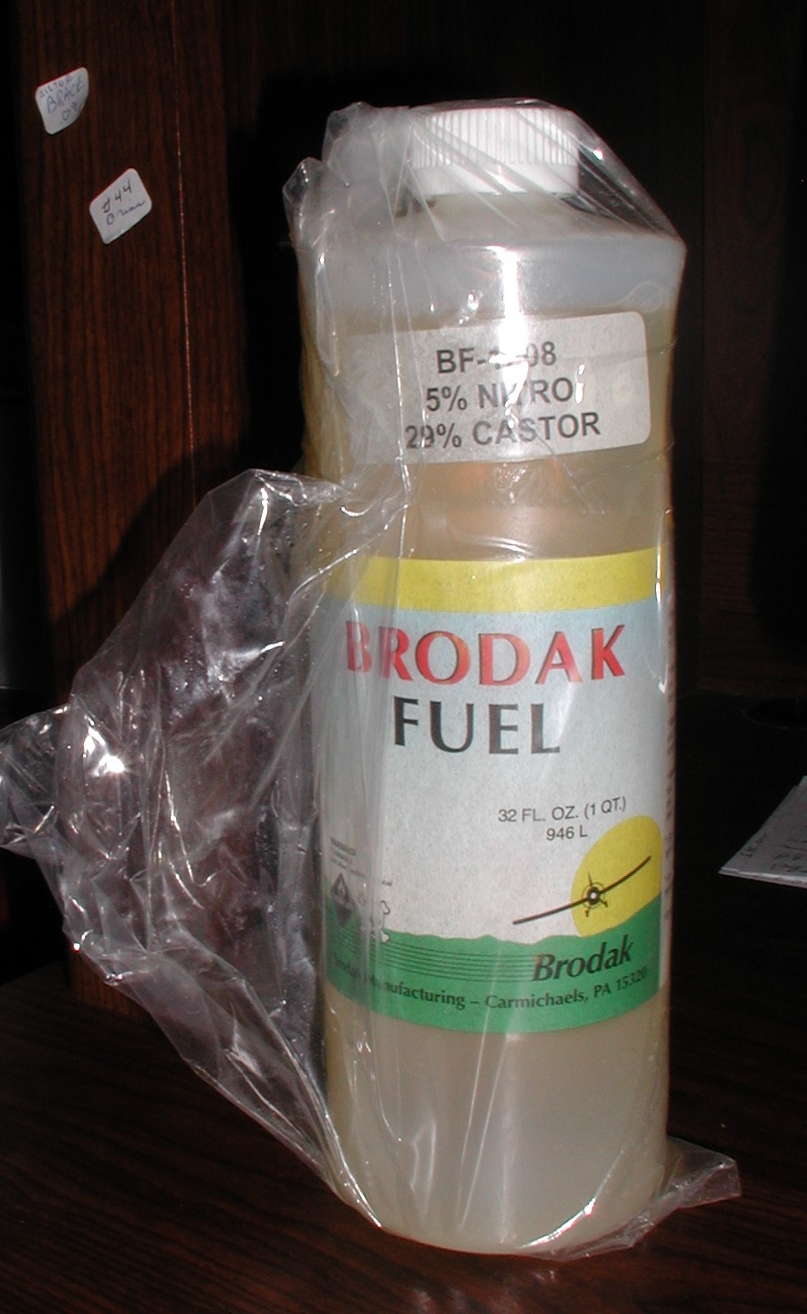

I have a quart of Brodak 5% but I'm saving it for my larger displacement engines. I have run Cox engines on 10% Traxx with added castor, but never thought they ran to their full potential on that fuel..

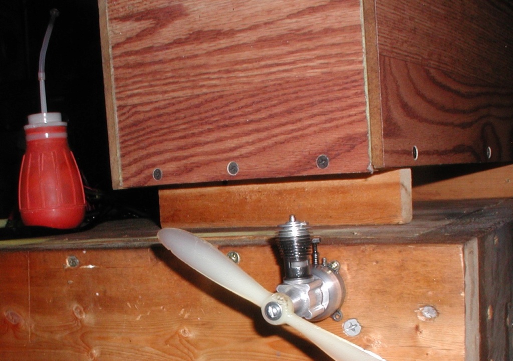

Last of my Cox fuel sits in that fueler. Ran this little made-up thin wall I put together a couple of years ago. Original metal star reed and a cylinder out of a P-40. Started first flip running backwards then burped back to proper rotation. Did that a couple of times, each running irregular for a few seconds. After about five of these the reed loosened up and it ran fine, running all the fuel out of the tank.

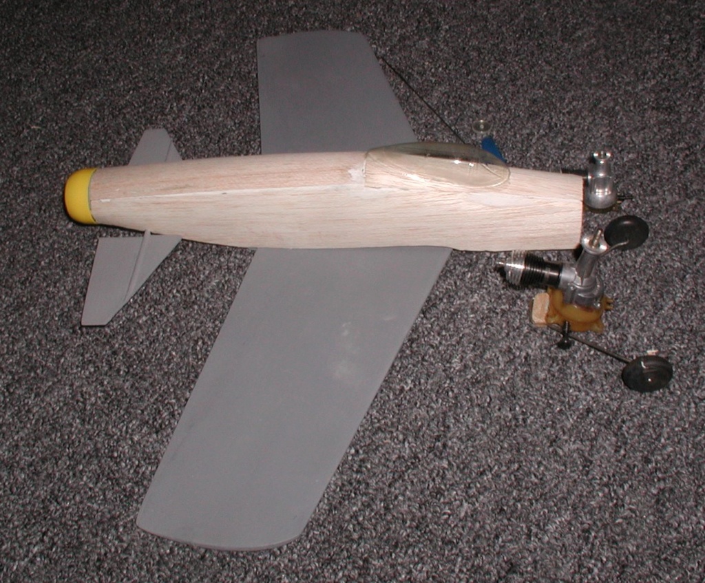

It will go into my work in progress Muscaino Super Sabre rebuild. Gave up on the .020 / Space Bug Jr idea. Don't think they would pull it around.

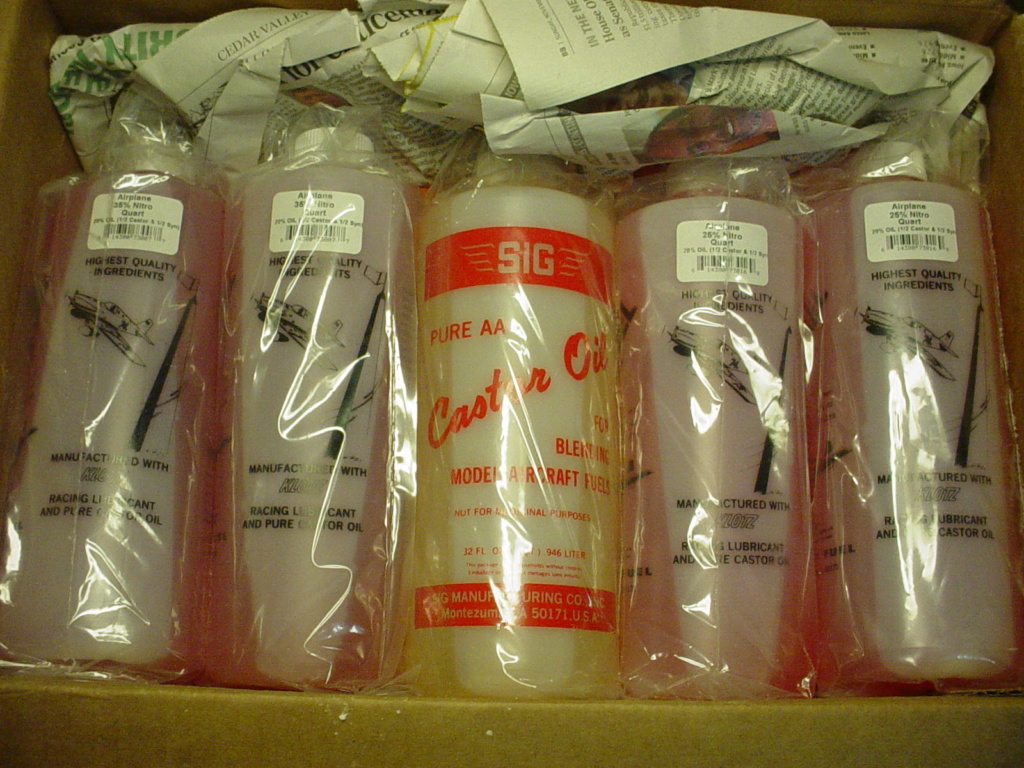

Hi Robert, I've been running "Sig" Champion 1/2A fuel in my Cox engines.. ever since Cox's glow-fuel became unavailable to me. When was that? .... I'll say sometime in the early 1990's.
I've always purchased Sig's 1/2A "Champion" fuels by the QUART.. which has avoided paying a HAZMAT fee.. which is assessed on gallons.
My most-recent Sig fuel order was Feb. 2018.. for X2 quarts of Champion 25 (25% nitro) X2 quarts of Champion 35 (35% nitro) and X1 quart of Sig AA Castor Oil.. (used to be Baker's..)
The plastic bottles seem to be the same construction as they were.. 30 some-odd years ago, and I still have some of that old fuel.. which will still get a tired old engine running.
In a nutshell; I support Sig Manufacturing Co. as one of the very few model-airplane manufacturers remaining in business; that continue to cater to the internal-combustion engine modeler; be it C/L or R/C.
