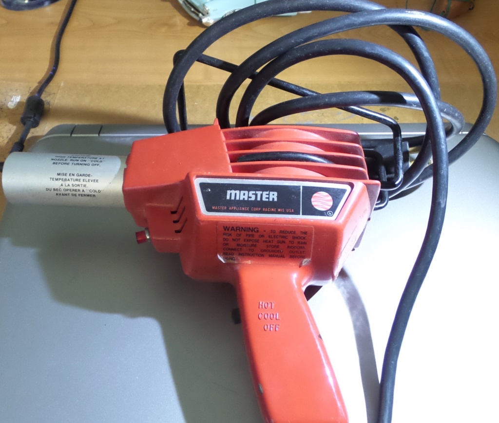

Bob, if you have a large crock pot or a large pot to boil water in, this may work using the dip and shape method. Dip a little twist a little until you get the proper shape. Or you could use a heat gun but be careful this thing will burn the house down if used improperly. If you use the heat gun you'll have to practice before using, much like spray painting. Not too close and keep it moving. You can rent the heat gun from a local tool rental, or I could loan you mine. Let me know, would be more than happy to help!!! Mark

Problem with a heat gun is it can get too hot and the plastic will suddenly melt without any indication, its a small window, lol, i know...

I agree, and that's my fear not just with this $7.99 (went back and checked the actual ebay price) Testors P-51 but with my Aurora models too @ $100+. Large chance to make it worse than it already is.
I have a couple of dual range heat guns and use them very carefully. Problem is, they spread the heat out over a large area when I need concentrated heat in a small area for a short period of time. I have a butane torch that does that, but imagine the consequences of using it on plastic.
