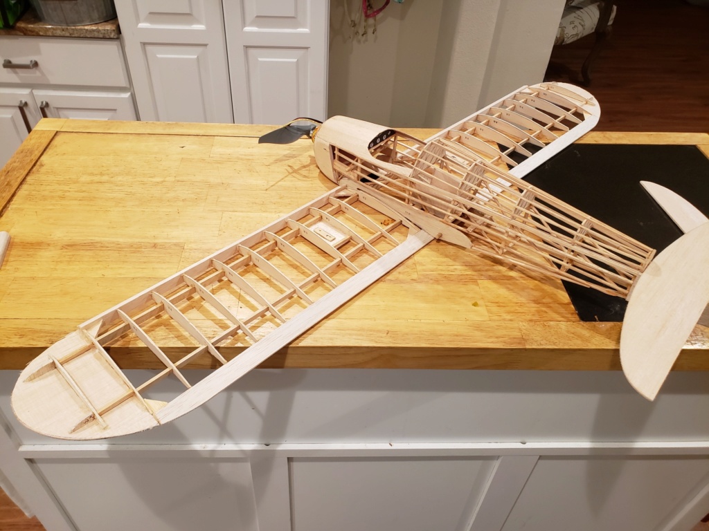

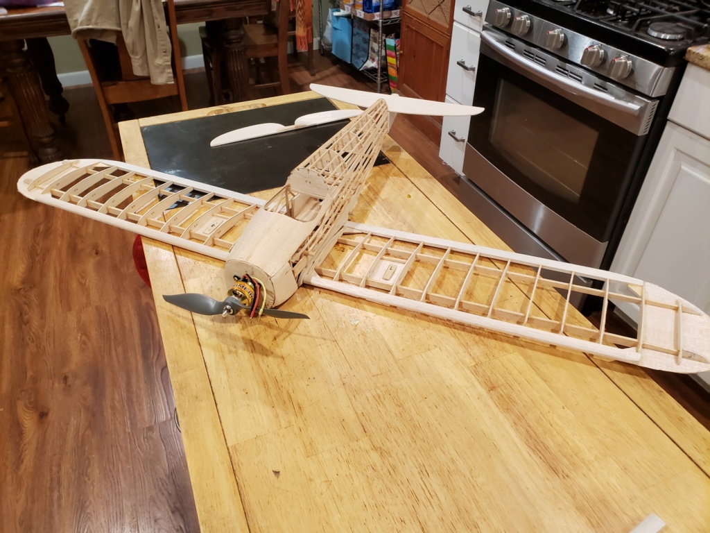

I'm working on my first RC plane. Its a Kinner Sportster 39" WS Kit by Flyline. It's an older kit and none of the parts are Lazer cut just printed. Very detailed kit and a lot more work then I thought it would be. I'm using an Electric Rimfire 400 for power. I think it should be OK. It should weight in around 20oz when complete. I have a Hobbyzone Champ that I am learning to fly with before I take the Kinner up. I have built some control line which I enjoy but this RC plane is much more complex.

Very nice !! And yes alot of work/fun for a print out and stick and tissue model . Keep us informed on the progress , what are you covering it with ?
Posts : 7727
Re: Kinner Sportster
I'm thinking of ultracote for covering. Weight is 16oz w/o covering. A little heavy but should be ok. It's a fun build but I'm itching to get it in the air. Some guys have spent months on this kit. Their attention to detail is unreal. Wish I had their patience!

If you are going the plastic covering route, I would think that with a build as nice and clean as yours, a transparent covering would both look nice, and you can show off your great building skills!

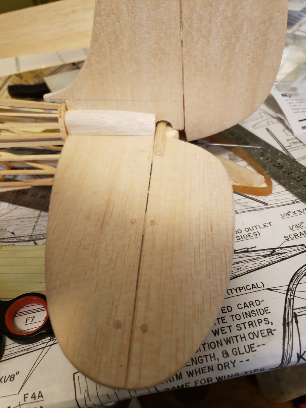

I may be wrong here as I have never done a pull-pull setup before, but could you use two small control horns opposite each other and then use just thread/spectra fishing lines for the 'cables'?
- Posts : 3224
Age : 42
@NEW222 wrote:I may be wrong here as I have never done a pull-pull setup before, but could you use two small control horns opposite each other and then use just thread/spectra fishing lines for the 'cables'?
That's what I was thinking. I just need to figure out some kind of eyelets to attach to the rudder for the lines.
Ricksrod- Bronze Member
- Posts : 57
Join date : 2019-08-20
Location : Northern Calif.
Call it redneck, but I may be able to suggest something. In my foamies, I just use a piece of 'zip tie/ ty'strap' with a hole in teh end glued in place, and none have ever given me problems, with the exception of my own doing..... Anyways, with a model as yours, you should be able to safely use that technique. Make it as long as you want, round the edges and drill two 1/16" holes (one on each end). With balsa, I would quickly rough it up and insert it through a slit in the rudder itself as one piece, and glue in place. Then you would have one 'ridgid' control horn. Run your strings as required and see how it goes. Again, I use them on foamies, so if you were to try it, I would try it out on a scrap piece of balsa and see how it holds or such. Just a thought on what I would be trying.

I like the zip tie control horn. Most of the horns you buy are the same material. I included a couple pics of my CA hinges and tooth pic pins.

I really like the toothpick idea for a bit of extra added security. Something to remember for the next time I use them. Glad you like the zip-tie idea. It does look good in the test piece.
