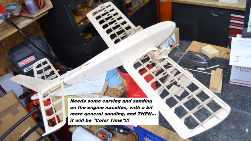

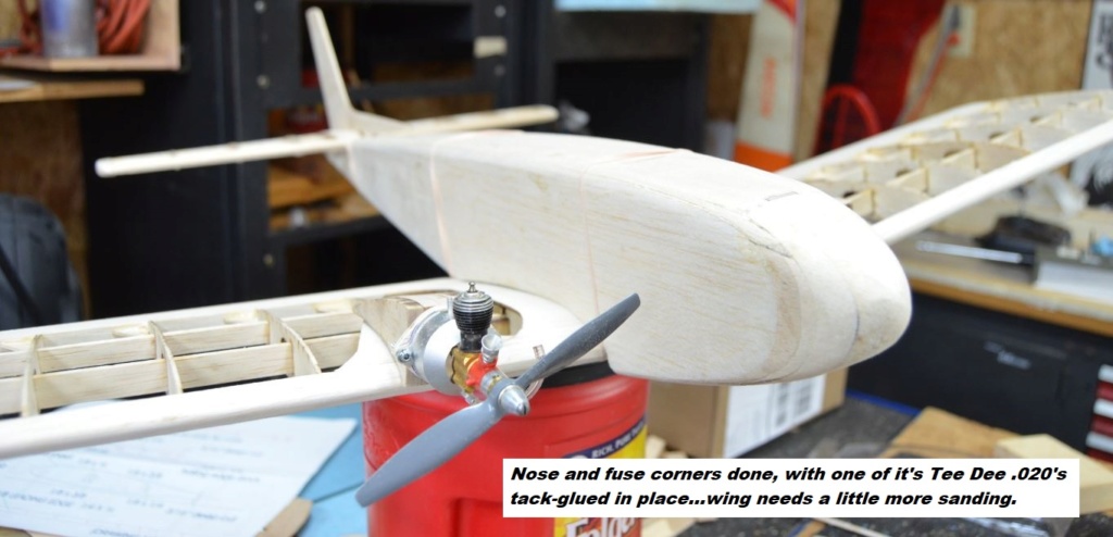

The Goldberg Jr. Skylark continues to draw attention...this time from my carving knife.
Yesterday afternoon, it's nose, fuse corners, and wing leading edges were victims of my deft wielding of a long-blade Exacto.  The thing is really starting to develop a personality. It's wing needs a little more trimming/sanding, and one of it's Tee Dee .020's tack-glued in place for inspiration.

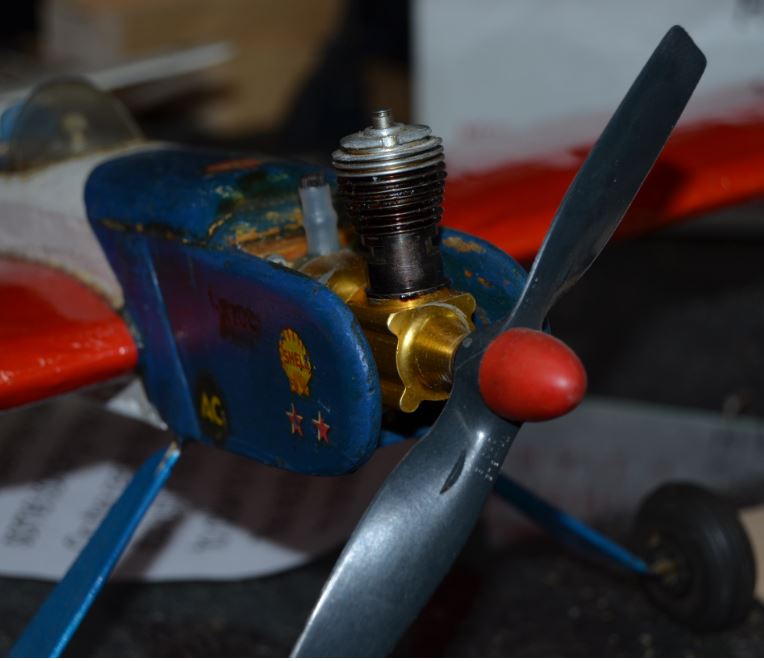

Uncle Wayne's 51 year-old "Scout" control line stunter got some old-school hinge stitching to support it's ancient cloth elevator hinges.  This plane is still in good, flyable shape, with a healthy Cox "Golden Bee" on it's nose.

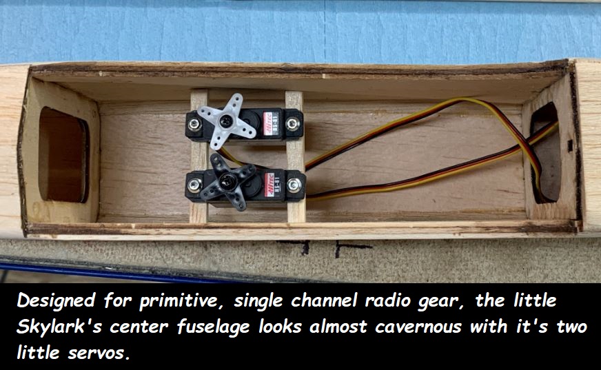

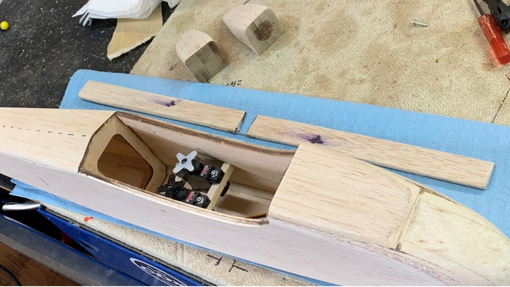

Another afternoon spent working on "piddly stuff" with the Skylark. The servos were dry-fitted (and may get shuffled around) inside the fuse.
The original Skylark was designed NOT to have an elevator, so one was installed. The nacelles are also shaped and finished. Everything got sanded and I'm done with that stuff!

This is looking good and there seems to be plenty of room in the fuselage to shuffle gear about to balance it.

[quote="Kim"]Another afternoon spent working on "piddly stuff" with the Skylark. The servos were dry-fitted (and may get shuffled around) inside the fuse.
More Work on the Jr. Skylark-Still Clear Doping, But Getting Ready for Color  6_116
The only thing with the so called primitive gear is it was considerably larger than the current stuff. Adams Stomper Magnetic Actuator looks gargantuan compared to those micro servos. Plans (original) I have, shows provision for an optional roughly 1/2 inch wide fairly narrow kick up elevator by splitting the trailing edge, common on R/O compound escapement flying.
Nice build, looks like you have it constructed in decent wood, too.

Thanks guys! I'm trying to keep the ball rolling, and want to start hitting this thing with some dope (Brodak on the fuse / Monokote for the wing and stab) before long.
Yeah, I use the term "primitive" fondly, with the knowledge that a little MORE knowledge (and maybe technical ability) would have helped me with my escapement gear back in the day!
