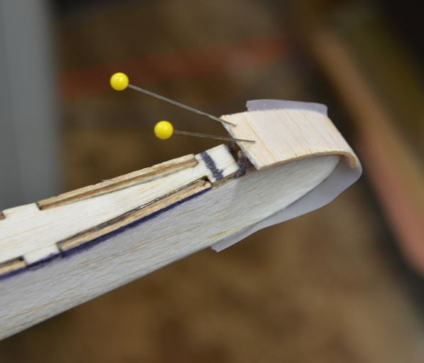

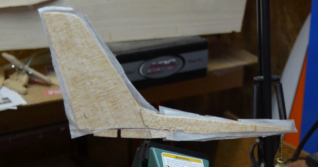

Got in some more work on the Goldberg Jr. Skylark project that's slowly creeping along.
The note is from my Facebook Page and is written to be understandable by those who have never experienced this type of old school finishing (and maybe flash-back material for those who have!).

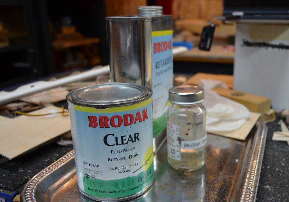

Doping out in the shop...butyrate that is...

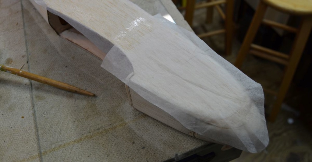

So the Skylark gets a layer of light silkspan applied to it's fuselage..."painted on" with Brodak clear dope, along with a little shaping work on it's tail cone.
This is the most "crafts-like" stage, with a lot of tissue trimming and using clear dope to bond it with the balsa, then using sand paper to trim away the excess. Makes the whole shop smell like "Model Airplane"...which, when I was kid, used to get me evicted from the front room to the front porch. Mom just didn't appreciate my version of "Aroma Therapy".
It'll get sanded and clear-coated 'till it starts to get a shine, or until I start seeing purple dust bunnies in my closed-window, winter time shop.

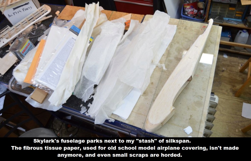

The tissue is "still" available. It takes a bit of creativity to find it.
Jump over to StuntHanger and search for "doctor office exam paper."
In a nutshell, this is a "crepe" exam table paper that looks, feels, and behaves like Guillow's tissue. I have mentioned it here before, and picked up a 23" wide by 125' long roll.
Try it. You may find it to be quite an acceptable/compatible substitute. Shoot me a PM with your address, I'll send you a chunk.

Hey Jim,
Thank you man, but I do have a roll that was graciously sent to me by Andrew a year or so ago, and intend to try it on another upcoming project.
Thank you again !

I do like watching someone do the silk its been along time since i have tried to apply , never did the fuse before But do like the look . At least i do have a few bottles of Aero left that i do need to use in the near future so it don't do to the can . I got some Millenium cover from Eric Chilton a couple years ago it lightweight iron on though he was very interesting to talk to , being English too .
Good fun Man !

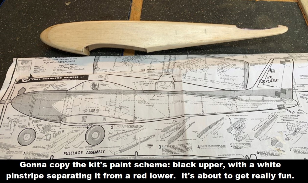

Still making baby steps on the two main projects but, after tripping over some of my gear and nearly destroying two innocent model airplanes, I dedicated 20 minutes (that turned into two hours) to put some order in the chaos.
I didn't take a "before" photo, so just imagine a bunch of delicate stuff, stacked on and interlocked with other delicate stuff (sort of a Model Airplane Jenga Game), with NO floor space visible.
Anyway, after a LOT of staring and thinking, I decided to go with the Skylark's original box art scheme and color, and will be cranking up the paint gun if Mother Nature gives me a calm clear day, with some low humidity.
Navigator needs some more clear coats before it gets some color, which will be a white base with dark blue trim.

Looking good Kim . I'm a big fan of silk span and like you I hoard every scrap . My covering starts off with nitrate dope and silk span or tissue , then Klass Kote epoxy primer and epoxy paint . Free fight models I skip the primer . Keep up the good work .

The fin looks like it has been cut from a nice piece of "C" grain balsa and should stay nice and straight. Some of the kits I have have a very poor or inappropriate selection of balsa.
I am still in favour of the dope and tissue method of finishing even though it is a slow process. It is just difficult here to get nice lightweight and medium weight tissue that shrinks witout tearing.
What are you using for the white basecoat on top of butyrate?
ian1954- Diamond Member
- Posts : 2688
Re: More Work on the Jr. Skylark-Still Clear Doping, But Getting Ready for Color
Yeah, I've gotten several Short Kits from Fast Eddie at Lazer Works, and the balsa has always been good.
The finish from beginning to end is all Brodak Buyterate dope. Once I get the part sanded to where I think it's ready, I brush on a 50/50 coat of clear, sand that smooth, and start laying down the silkspan...usually the lightest stuff I have.
Navigator has an open bay in the last half of it's fuse, so I used some heavy grade to hopefully keep me from putting a finger through it in the field.
I use a piece of "worn out" fine sandpaper between clear coats 'till I get a good shine, then shoot some color...usually a thin white coat to help make the colors pop. My biggest "discipline problem" is making myself give the dope plenty of drying time between clear coats.
Of course, the REALLY fun times come when the colors are shot, and I'm pulling away the masking tape to see how well the edges sealed, and get my first glimpse of how the thing is gonna look! And we're getting close to that happening!

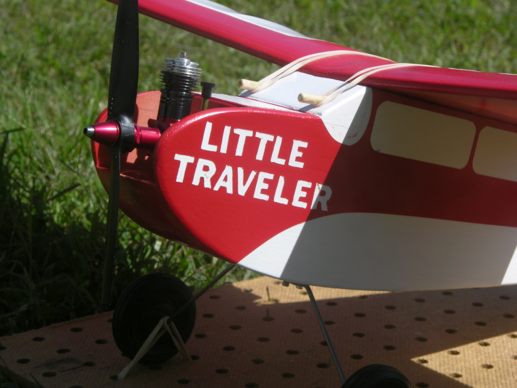

"Little Traveler" was all silkspan covered, and I had a hoot finishing it!
