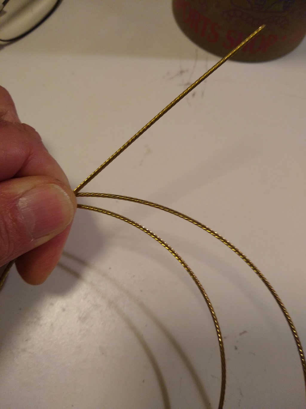

Hi Andras, it's not really a bent wire pushrod but a flexible cable.  1/2a Stealth Sport RC Plane - Page 2 Img_2077
Dubro and Sullivan both offer them, folks usually use them for throttle pushrods on larger planes.  They're not stiff enough for control surfaces on much more than backyard flyers, but they're perfect for slower 1/2A as long as the unsupported run is short.
Here are both brands, the Dubro outer is a bit more flexible and easy to install, but the need to anchor securely is even more important.  They weigh about the same.

Thanks Dave, yes I had them in a balsa kit before, they are thin Bowden wires that are OK for pulling the control horn but ned to run in a sheath up to the horn tip less the tip throw otherwise they will buckle when pushed. But the idea of how to lead them out for aileron control without fussing with an aileron drive shaft lead out through the trailing edge is great.

The flexible wires work great for ailerons with one central servo. The connection to the control horns can also easily be made by bending the wire to shape and then letting some solder wick into the end:

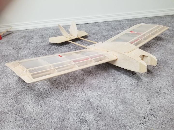

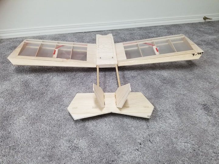

Well, nothing much to report other than the wings are on, ailerons attached using doculam (this is a first for me using it as a hinge material), holes in wings covered from my having to cut the first bay open to clamp the wings to dry. Tail is also attached now. I am now thinking my next step is to get the worst part of building over. The installation of electronics..... Still got to determine what servo(s) to use. I am thinking a 9g for the elevator, and possibly an HS-81 or equivalent on the ailerons. Anyways until then..... If I cannot get my electronics sorted out, I will scuff up my wings to get ready for paint. AUW as seen pictured is 7.5 oz. Also to note. There are a few wrinkles and ugly spots in the covering, but hey, this was a 'quick build' to see how I like the plane. If I like it, I will probably build another, but take my time and do a nice job like yours Dave.

Looks awsome, congrats..I would certainly drop a good TD049 in it because this bird seems to want to soar real fast!! RC Plane

Wild looking bird , should fly well seems to have lift to it . RC Plane Rudolph
