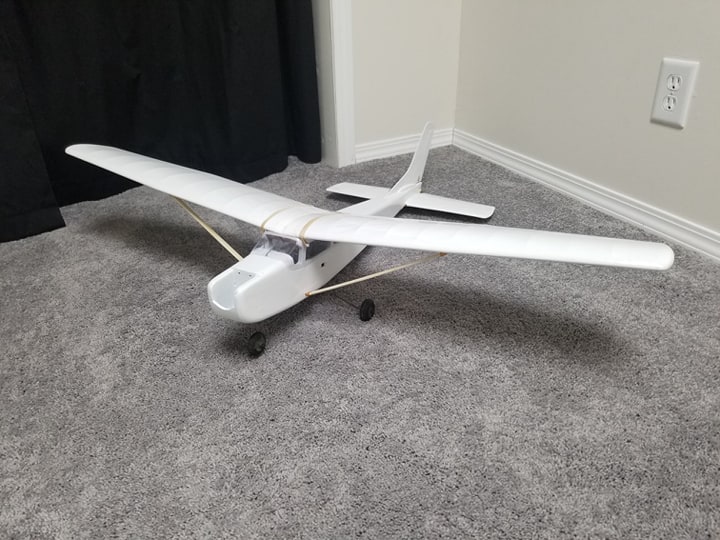

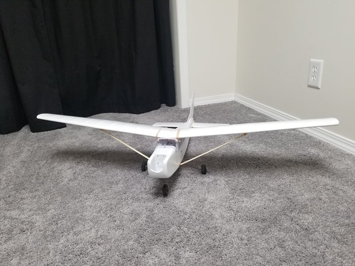

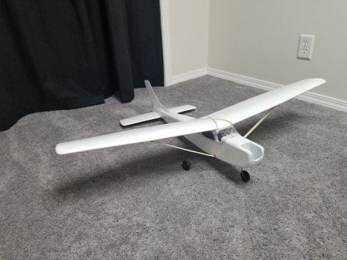

So I thought I brought this up before, but cannot find anything. Last year, I picked up this plane from the estate of a fellow modeller, not knowing what it was. Turns out it is a Goldberg Skylane 42. Wing and horizontal stab/elevator were all white plastic covering that needed a cleaning. Fuselage was white, red, and black dope that was badly cracking. So I had to remove it. Sanding was not going well, so I resorted to a razor blade. Windows were cracked, front nose gear was ripped out from the former. first step was clean the wing and tail. Second was remove what was left of the windows and make templates. Second was strip the fuselage. Turned out not too bad with a few gouges here and there. I used lightweight spackle on the fuselage before priming and painting white to match the wing and tail. It is good from far, and far from good, has a flow indicator or two, but adds character.
If it survives this coming year, I may disassemble it again, and give it a nice paint job. I would like to repaint it the same as he had it in his honor, but I had lost a whole bunch of pictures and I no longer have anything of it in its prior state. So, now to add a stripe of sort to it. It was bare, so I installed a Futaba S-148 servo in it, and the mounts and control horn all lined up great! Besides that I need to install a battery, receiver, and a Golden Bee to match what the plans have listed. This should be interesting as a single channel rudder only model for someone learning to fly nitro RC in 2020.....

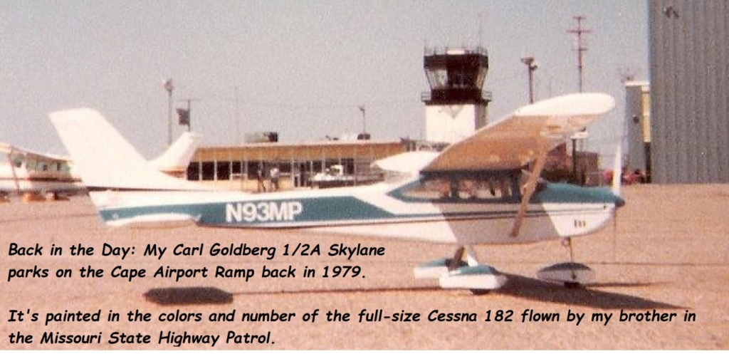

I "cheated" with my Goldberg Skylane back in the 1980's...adding an elevator to the little plane. I also copied the paint scheme from the Skylane my brother flew with the Missouri Highway Patrol back in the day:

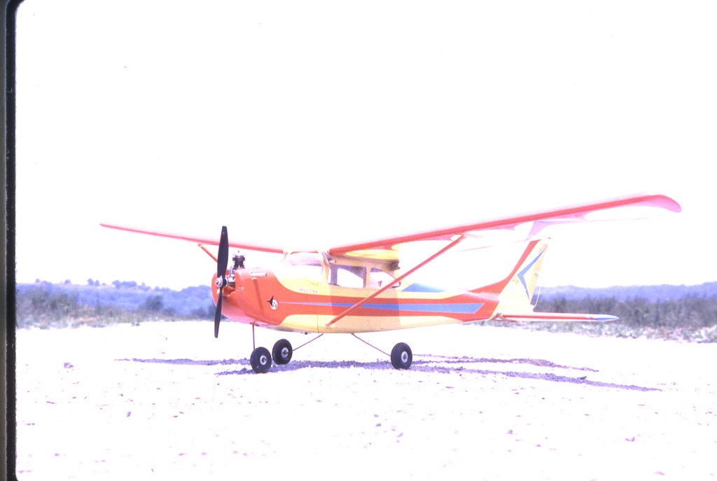

My Fox 049 single channel Skylane. Hundreds of flights. Rudder only, Babcock escapement. Trim it glide flat and straight. If it won't fly without the radio, it won't fly with it.
Rudder only ships were trimmed to fly with a slight climb. Upplying rudder will cause a turn, but you can't just hold the rudder. As the plane turns it will bank steeper and steeper dropping the nose. So you must learn to apply rudder in short bursts.
If you hold the rudder and get the nose down and apply opposite rudder, the plane will stop turning and the nose will be down. This causes a lot extra airspeed and the ship will zoom up. Learning to control this zoom will let you do rolls, loops, immelman turns, and wingovers, all with no elevator.
If you want to fly faster in a straight line, give it right the left rudder, reversing just as the nose drops. Kind of like tacking.
Don't let th3 plane get downwind. You'll have to have mastered tacking to ever get it back.
Years of flying in a few sentences.

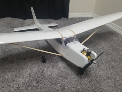

Ok. So my show ended and I wanted to get this thing ready. So I did install the switch, receiver, and battery pack. The pack I originally weighed it with was a bit light, so I swapped it out with my other NiCd battery for an extra .5 oz. I also decided to use an Orange Rx for it so shed a bit off there. With battery mounted under the dash/nose, and the receiver mounted as far forward as possible, I still need to add a bit of weight.
So I went scrounging around and found a lead muzzleloader bullet looking for a home. So I placed /sat it right on top of the firewall. It now balanced just very slightly nose down on the C of G indicated on the plans of 2 1/2". But it also states on the build sheet that it is good from 2 1/8" - 2 13/16", but I opted for the main number given. When the weather decides to co-operate again (supposed to be beyond -40 F tonight and tomorrow morning), I will pound the bullet down to a manageable shape and glue it to the firewall. Then all will be done, except for the snow will be around till it gets the maiden! But please stay tuned for the flight report. Whether it be good or bad, I will update this.

Oops. Forgot to add that the final AUW ready to fly will now be a porky 25 ounces! Now to really read about what propeller will be best to lift this little porker!
- Posts : 3682
Age : 43
Re: Carl Goldberg Skylane 42
Nice work new222. You time spent getting the correct balance will pay off. A tail heavy rudder only ship is a real nightmare.
