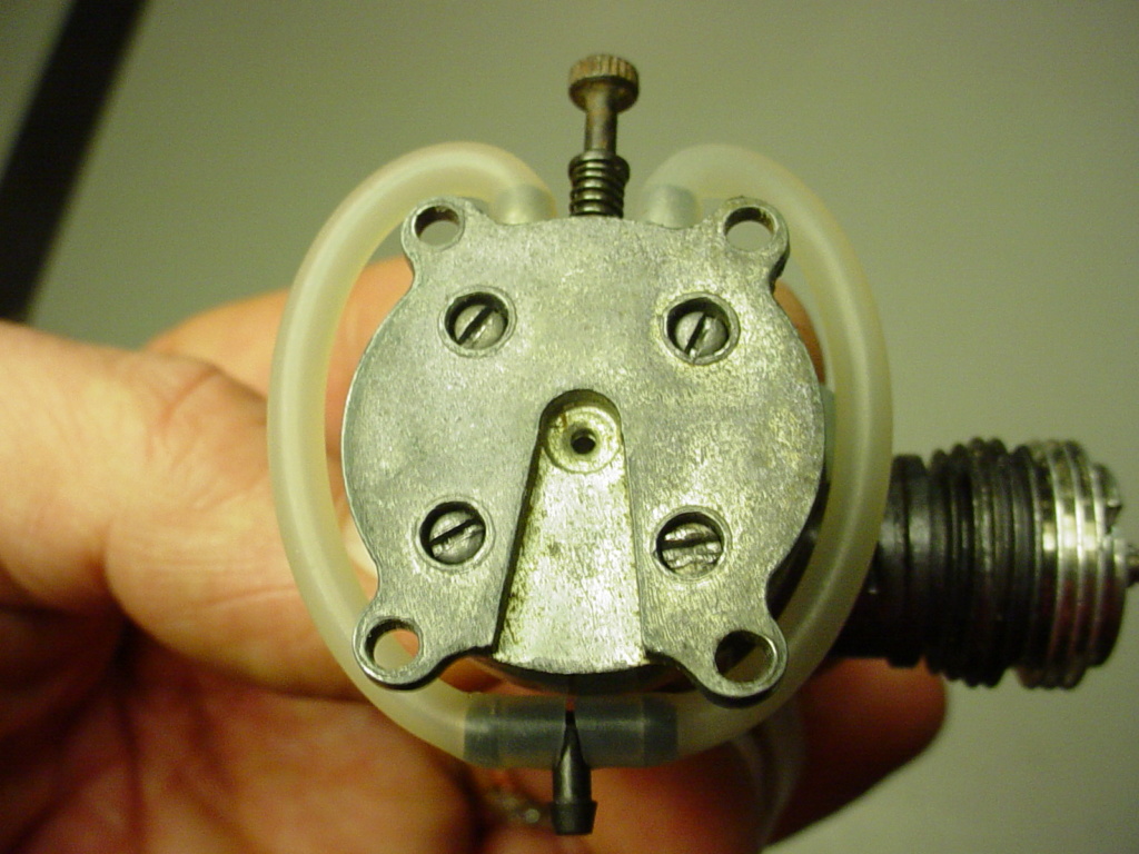

Actually it is to let the tank breath so it can still pull the fuel , if you turn the engine upside down it will cause an air lock. Some people also put a fuel tube around the bottom of the engine and just cut a slit (opening ) in it to do the same thing . Babe Bee .049

When upright the fuel fill nipples are above the fuel level in the tank, so it won't leak out. When inverted the openings in the extension hoses are above the fuel level in the tank, so it won't leak out. Air can still vent in the hoses either way as it isn't effected by gravity like fuel is.
Hope that's simple to understand.

getback wrote:Actually it is to let the tank breath so it can still pull the fuel , if you turn the engine upside down it will cause an air lock. Some people also put a fuel tube around the bottom of the engine and just cut a slit (opening ) in it to do the same thing . Babe Bee .049
Here's an example using a "tee-fitting".
Cox Fuel Tank Tip Dsc02510
