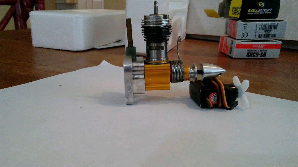

A few weeks ago I was surprised by an incredibly generous gift from 944_Jim. It was a House of Balsa 2x4 glider kit. Now that I have a little free time I am going to start building it. I have just recently assembled the required components. They include: a 4.8v, 300mah NiMH battery, standard switch, 2 HS-65HB servos, an AR 6100 reciever and a Cox Franken engine. The engine is basically a drum back end from a VGE RR-2 and the front end from a Valentine Speed Bee.

All these goodies come in at a hefty 4.4 ounces.

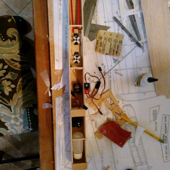

I made a little more progress, today.
2x4 kit build 2x4113
I got the pushrod tubes mostly installed.
2x4 kit build 2x4213
I made and installed a servo tray.
2x4 kit build 2x4310
I finished the bottom fuse sheeting and got the the basic equipment lay out taken care of, at least as much as possible without the plane assembled for a CG check.
