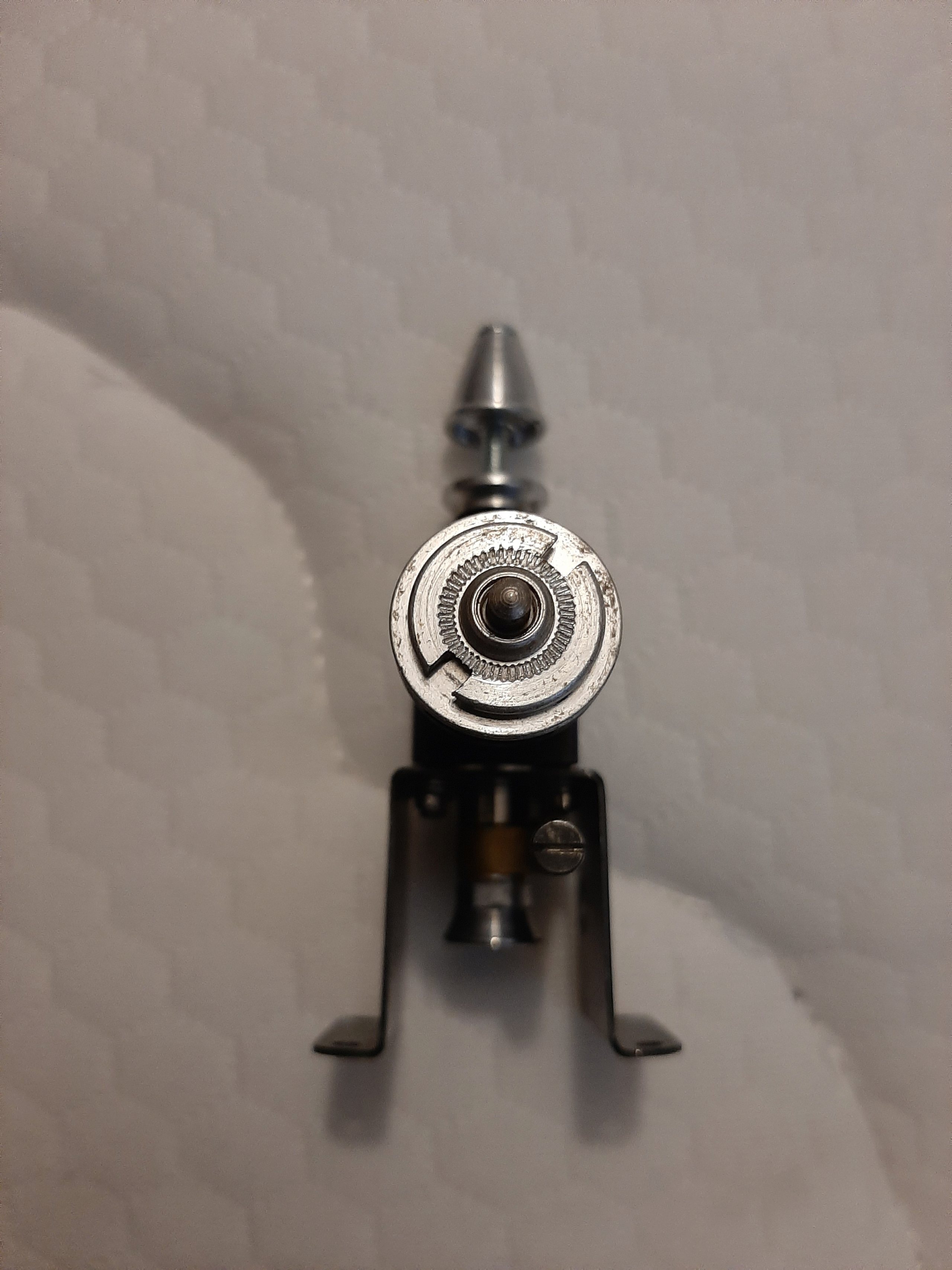

Customer sent pics as per below. He says that this engine is professionally made (does not look like a homebuilt) and also claims he saw another one in an OEM Cox Box (?). Ronald Valentine says that it is not one of his engines. It is .051 size with a reedie crankcase and TD intake setup (sorry, not the greatest pictures).

That's a Tarno AR carburetor mount with the Tarno reed intake installed. It has the TD NVA and venturi installed. I built one like that for a tach race a while back.
Here is a link to a picture of the entire kit:
https://www.coxengineforum.com/t2129-tarno-carb
Its definitely piece together.

well done sir!
