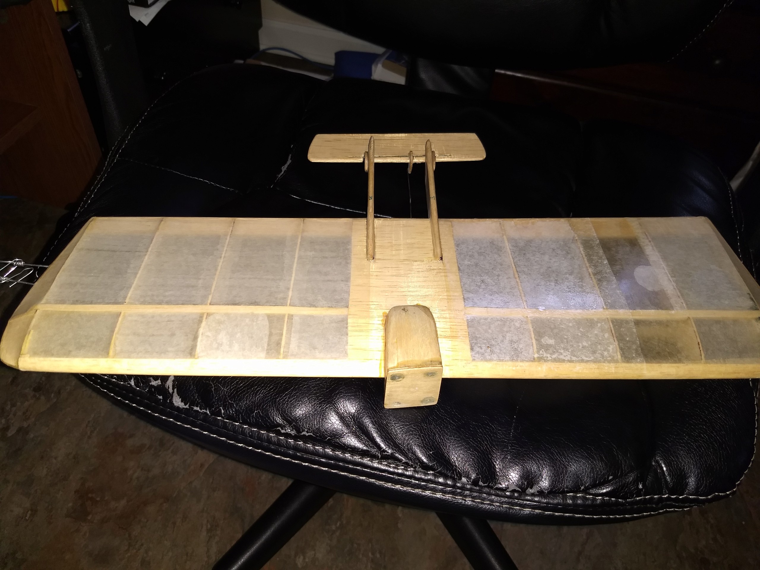

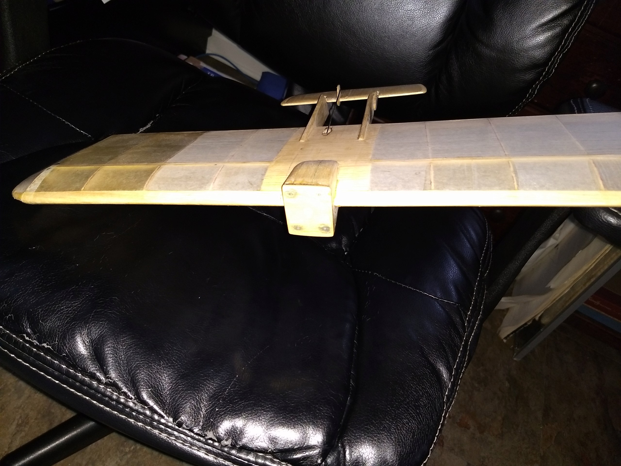

This is an update on 944_Jims widow satan offer. I have recieved the plane! Havn't seen one of these in the flesh since 1966! Now I have something to fly!...I hope! Thank you so much again for this Jim! And thanks to everyone else also for all the tips and help offered! My attempts at building something have been put on hold due to unforseen circumstances....so now I at least can attempt to see if this is possible again! I can,t seem to make the pics work today....

Ok...tracked down the pic gremlin!....Now.....maybe a tad of paint?

Re: Scale nitpicking
OhBee,
I was worries about shipping it, and so glad it made it. Remember, if it dies after only two flights, it did what it was sent to do. Have fun with it.
It looks good from here! I would drop the prop to 5x3 since it is on a Babe Bee. Of course, if this prop is all you have, then run it!
CG 1" back...I seem to remember the Golden Bee put the CG right about on the LE...so you should have a smooth flier there. Watch the wood screws on the engine mount. If they have an unthreaded shank, then they can sink threads deeper into the nose block but leave only the shank in the plywood. They will grab only balsa (not good).
If they are threaded all the way to the head, then there will be threads in the plywood (better holding power).
You asked about mixing that dope. The stuff I sent is old school..It may not mix well with other dope wet (in liquid form), but it should be alright for patching over previously cured dope. Most of that plane was doped a few years back. The two patches closest to center on the trailing edge were done just about 10 days ago.
You did determine which of the tissues is DocSpan (exam table paper) and which is cheap gift wrap, right? The gift wrap is for patching the Wido Satan. I found the second plastic wrap here. Apparently I dropped it back out while building the box.
I hope you get to enjoy it. My kids couldn't care less, so it is in a better place now!
Thanks again Jim!..ya..I know which screws ..I actually have 2! Will search for more! You marked the grain direction on the "docspan"....frankly I cant see any diff one way or 'tother! Does it matter?.Which way is the "grain " supposed to run?.......and I plan on flying it WAY more than twice! You should have seen the wrecks I repaired on my original back in the 60's!... I think I have a 5x3 prop. What will the dfference bee? Just more rpms isn't it?....less speed?
Just checked...the 5x3 I have is square tipped....no good?
