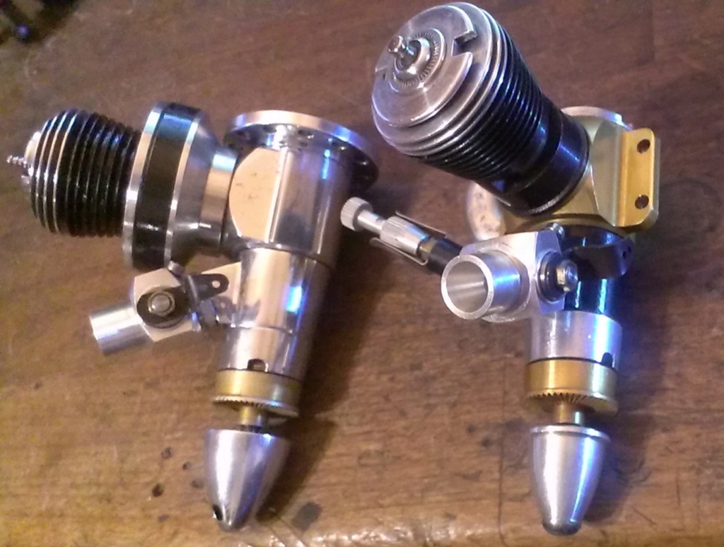

Would Like to Adapt a Carb on a Cox TeeDee .15
I was wondering if anyone had tried adapting an aftermarket Carb to a Cox Tee Dee .15? If So, What Aftermarket did you use and was there any success, Pros / Cons?

Re: Would Like to Adapt a Carb on a Cox TeeDee .15
I have works great
Norvel RC Carb used:
Thread is .375 x 32 aka (3/8 - 32) die I do not have a way to turn the neck down so flipped
the carb upside down and threaded the venturi side the hour glass cut inside the throat is on both ends.
I have not cut down the venturi intakes but may the upswing is good idle left as is.
1/2A Nut wrote:I have works great![]()
I have not cut down the venturi intakes but may the upswing is good idle left as is.![]()
Nice clean conversion 1/2 A Nut. I like the angled needle valve too.
