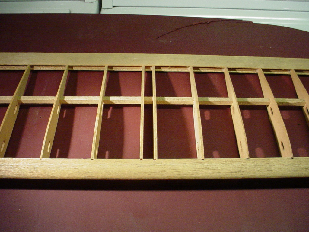

Oh Bee, I was born in 60. I can remember when my dad was an active C/L builder/flyer in the mid-60's. Smile  He later-on built me a Goldberg 1/2A "Swordsman 18" and later.. a "Stuntman 23".. powered by COX Babe/Golden-Bee engines.
I have a CG Voodoo wing framed-up by my uncle.. many years ago.
Beam mounts Voodoo11
Beam mounts Voodoo10
A CEF member kindly sourced me with the templates needed to build the tail-booms/feathers and most all other parts. My wing is a spar, ribs, L/E and T/E. No tips.. no bellcrank platform.. no fuse parts.. but I can now fabricate them. I just haven't yet...  Rolling Eyes
