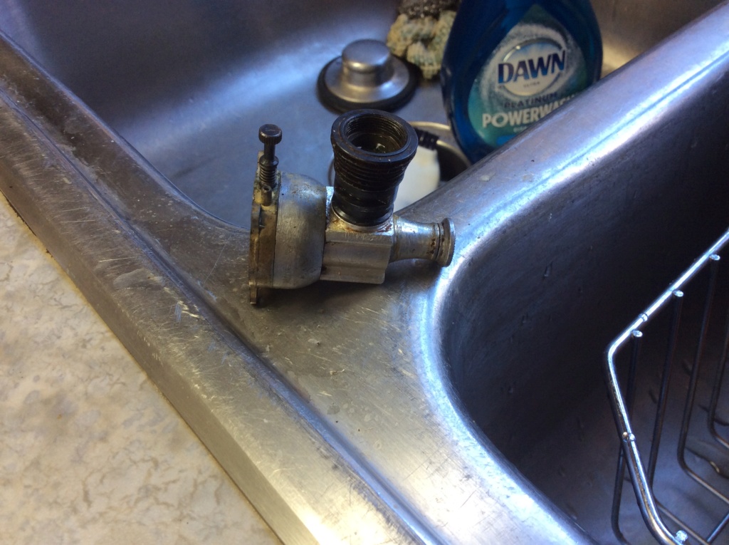

Saw a advert for “Dawn Power Wash” new spray and wipe dish detergent. TV add shows grease and grime melting away on pots and pans. Just like Popiels Pocket Fisherman, I had to try it.
Cleaning Engine with Dawn PowerWash 8091ae10
Here’s my new FreeBee DirtyBee
Cleaning Engine with Dawn PowerWash 0baf5f10

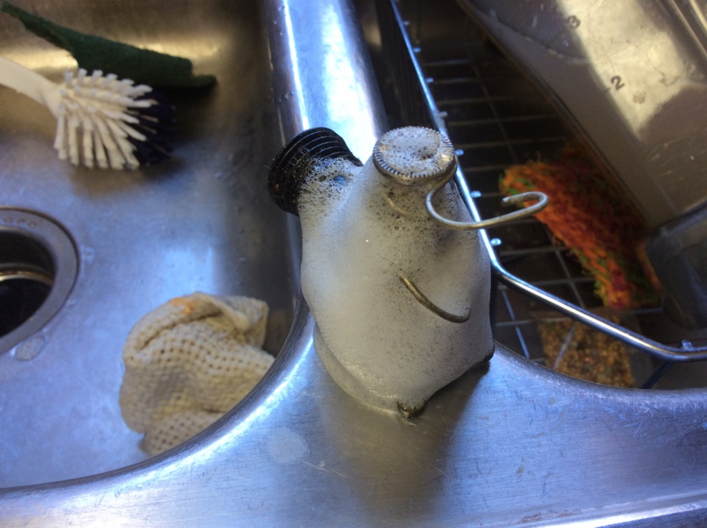

Spray and soak
Cleaning Engine with Dawn PowerWash F1881510

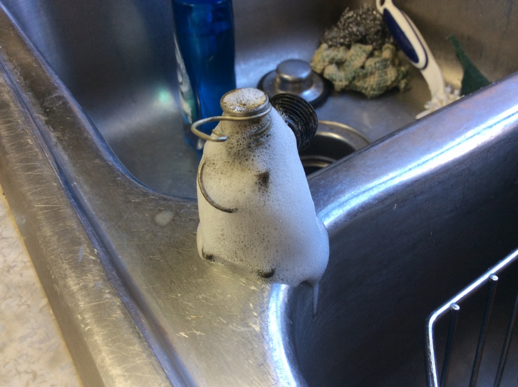

Spray and soak
Cleaning Engine with Dawn PowerWash 41df0310

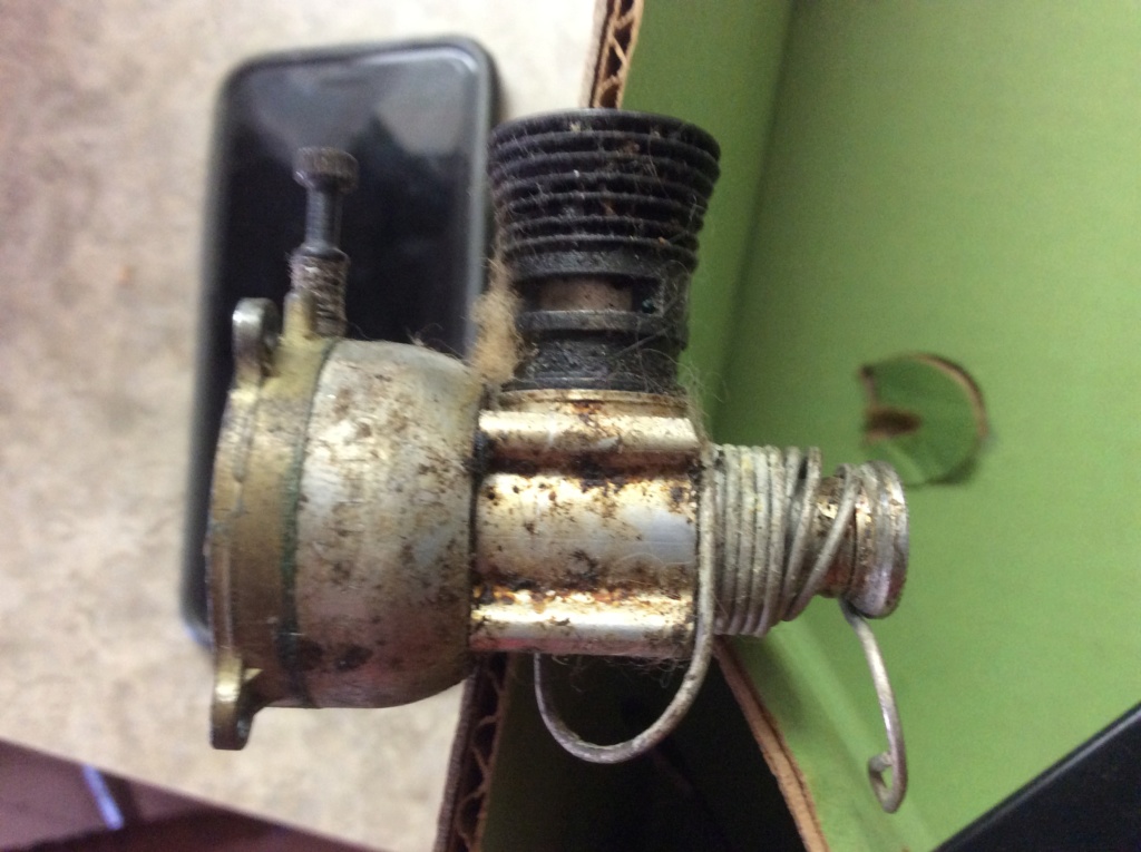

Instructions say wait  a few minutes for stubborn stains, I left it for 20 minutes and lightly brushed off the softened castor oil. It’s not as clean as a overnight soak in a crockpot of antifreeze, the engine is still stuck castor tight. It did melt away the old castor oil on the exterior, just like pots and pans, does what it says. Maybe another spray and soak would get off the small amount of leftover spots off.
Cleaning Engine with Dawn PowerWash 6d252810
I’d give it a “3” out of “5”, as it does help wash away dirt and grease, but it cost about the same as a gallon of 100% anti freeze. It might be a replacement for 409 cleaner as a after flight fuselage and wing cleaner!
