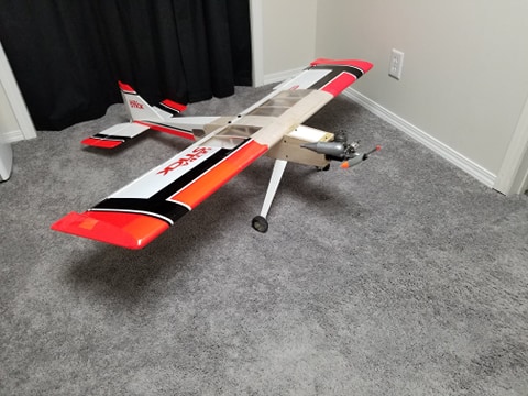

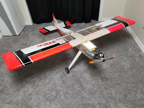

And here today it is standing on its own feet! I just tossed the servos in place, threw an 8 oz tank in the nose along with a 5 cell NiMh battery pack just to get a feeling of the AUW. So sitting with all the afforementioned parts, it is as 6 lbs 10.5 oz. All that I require yet that would add weight is a 2.4 receiver, the throttle pushrod, 1 flap pushrod, all servo mounting hardware and horns, and fuel line. Did a quick balance and it is nose heavy by a bit, so will be able to move the battery back some I am sure, but will do that when all is finally done. As well, I will have to do a left and right balance at that time as well.
