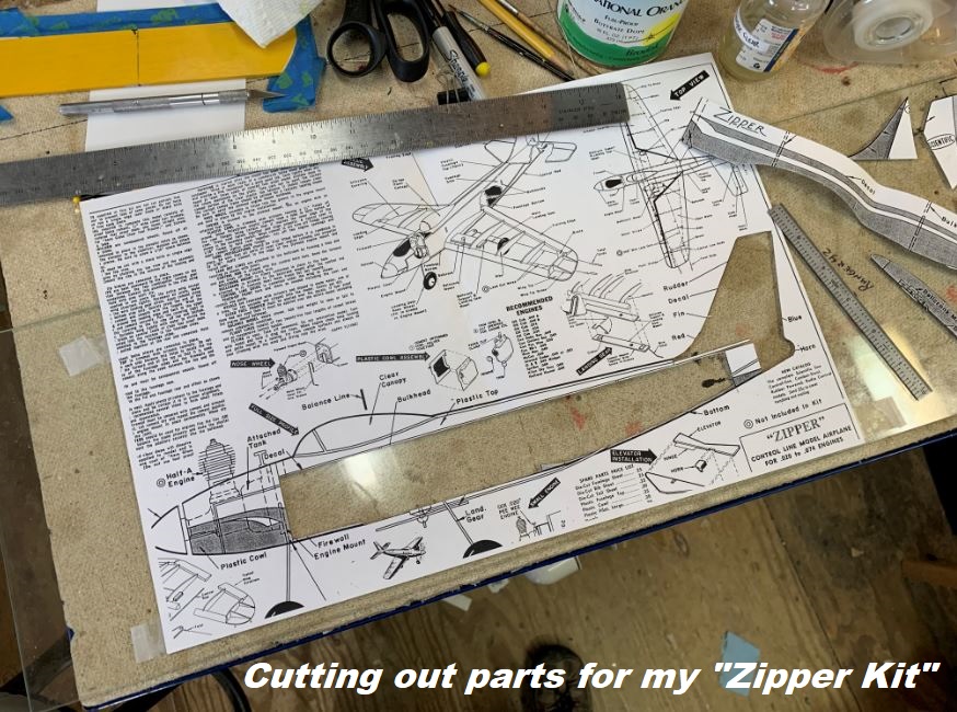

So, Bob's one little, though enthusiastic, comment about his fondness for Walt Musciano's 1/2A "Zipper" was just enough to push me over the edge into starting one. Went to bed thinking about it...drank coffee this morning thinking about it, so what the heck...
I built the original Scientific kit back in 1969 or so, powering it with the Babe Bee from my PT-19 QZ. A couple decades ago, I got a copy of the plan sheet, along with a nice note from the Man himself, Mr. Musciano. Been talking about building it since then.
Now, in the midst of a shop totally cluttered with tapes, dope cans, and spray equipment, I've started cutting templates from the 10% enlarged copies I made from the original plan sheet. I wanted this Zipper to be a bit larger, as I remembered the original to be better suited for a healthy .020, instead of the Babe Bee that took it around the circle like a combat wing.
Anyway, we'll see how this goes along. So far, the whole "Social Distancing" thing has turned the shop and front yard into a booming model airplane flying, dope spraying, resurrection of stalled projects, and engine test-running affair.

Just got back from Staples, they had the copy machines closed off, but I was able show the girl what I needed.
From the 10% enlarged plans, the rib profile is right at 3.9". If you enlarge the little top view by 392%, you'll get a plan-view of the wing and tail feathers that's a close match to the full size 10%+ profile.

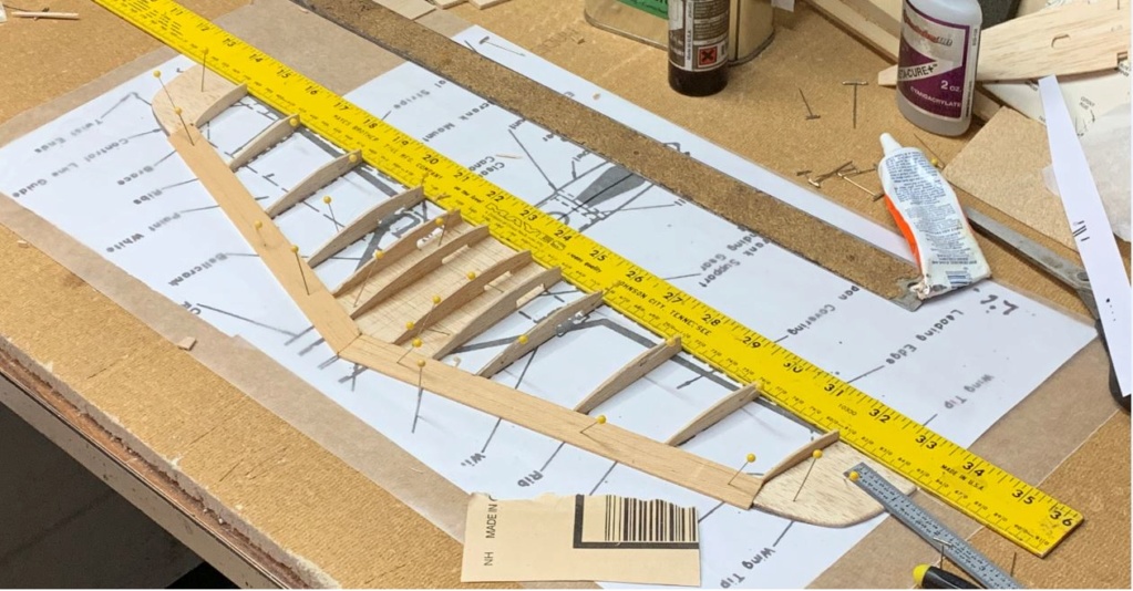

So, got distracted by a stupid search for a comet that had me staring at the heavens 'till 10pm. Finally got cold enough to give up.
So now, back to working on the Zipper...figure to do the wing first and trying REAL hard not to change anything, but it's gonna happen anyway.
The original has no sheeting on it's wing's center-section, with the fuse just glued to it. I wanted a "lip" of sheeting to protrude on either side of the fuse to make it easier to fix or recover down the road. So, it got a extra rib 3/4" out on each side, supporting some 3/32 sheeting.
I'm having a "slow night" as far as brain activity, and this is as far as I've gotten. Slow going, but haven't yet made mistakes that a new exacto blade can't fix !
